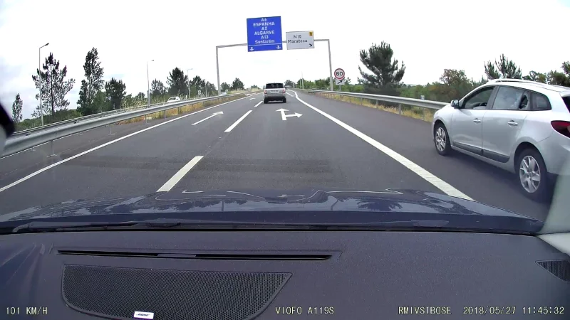

There is a lot of high quality videos aroung from A119(S). Looks like something is wrong with V2.4 firmware. I am going to reflash to V1.01 as per a colleague advice and see if this does the trick.My Mobius is also better than this DashCam
1) WDR ON seem to improve bad contrast issue. Will test further.Have just replaced old DOD GSE520 with VIOFO A119S V2 2.4 - daylight video turned out inferior to DOD's unexpectedly: overexposed, high contrast - balcks is too black, whites is too white, too vivid colors. My current settings are rather common: 1080px30, EXP 0.0 and -1/3 (both equaly no good), no WDR, all additional services are OFF. Will try WDR now... Contrast settings is missing for a reason?
All above relates to bright sunny weather.
