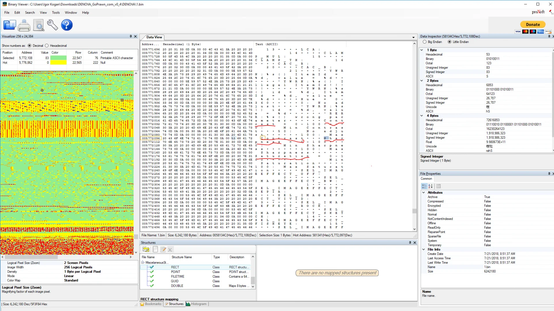

Just today I opened the firmware binary and saw some strings that look like the options🙂
