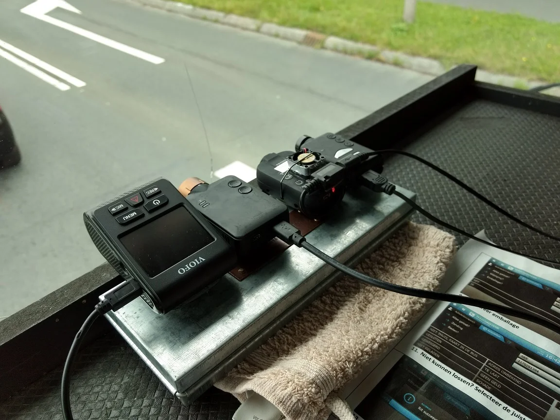

Clips, same road, same time, but very wet.... Viofo starts a little earlier.
Same road, other night, but DRY...

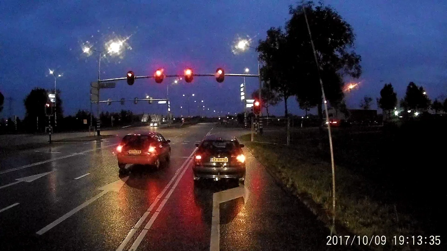

OK, I made a few stills from this setup in twilight zone:
Foxeer Legen 2
JooVuu X
Mobius (1)
Viofo A119S

Interesting. Mobius is the worst of those.
Every now and then I have the need for confirmation that I have the right equipment so I compare old and new, and truth be told, IMHO
1. A119S
2. JooVuu X
3. Mobius
4. Legend 2
Now please understand I still like the JooVuu X a lot, and the Mobius too, but clearly the A119S has better night recording, but in daylight the JooVuu X and Mobius are still just slightly better in reading license plates.
I've always liked Mobius better than the Legend 2, and when the light in the sky is really gone past twilight, Mobius takes Legend 2 to the basement when it comes to brightness and dynamics.....
Maybe I'll do a one over in true darkness, and I'll possibly take the Runcam 2 instead of the Legend 2 (I don't have enough SD cards hahahahahaha)
Is that only true when your car is not moving as in the above frame grabs while you were stopped at a red light?
The faster sensor of the A119S should do better than the others when you get motion blur from speed, even in sunshine if you are traveling fast...
