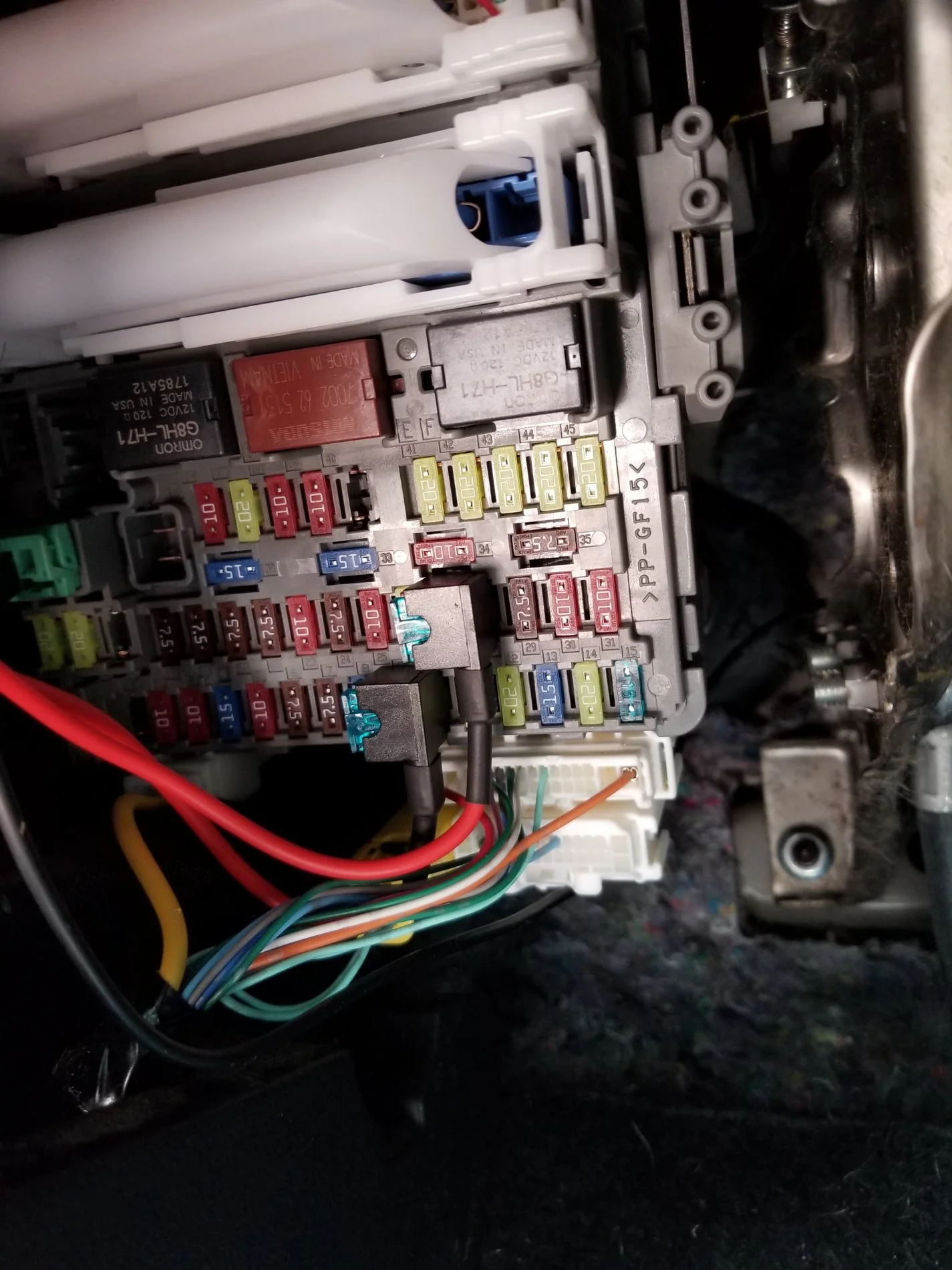

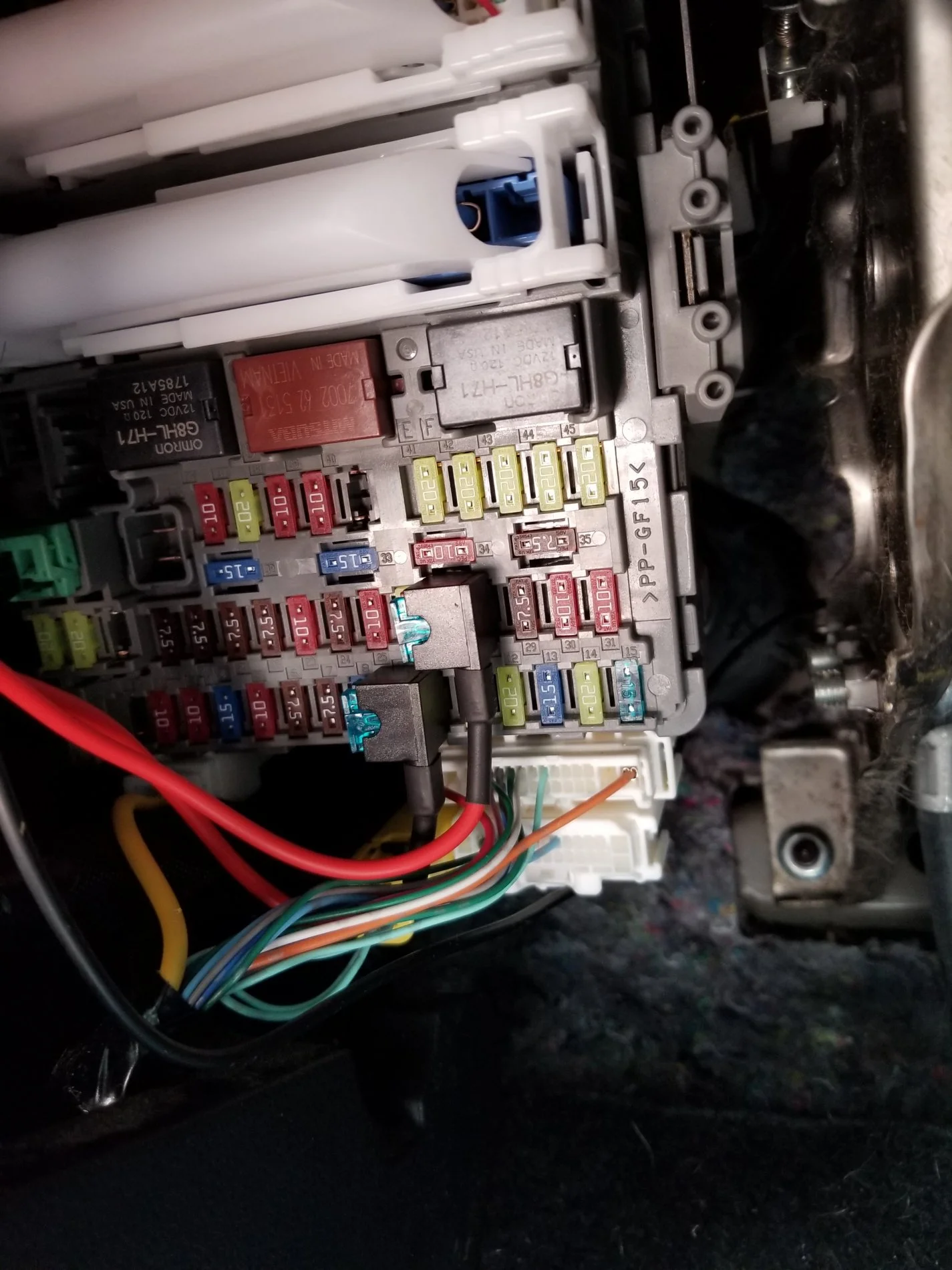

I found I was having this problem, and it ended up being my mistake on choice of power feeds. I had one of them on the door locks circuit in a 2015 Honda CRV, and the power was sometimes off. It was powering one wire but not the other, and it seemed to be working but would often go dead. When that happened, I had to remove the wire from the dashcam and reconnect and it would usually come back. I also noticed a delay of about 3 minutes going between the two modes.
I since found a better power source for the always on feed, and it now works reliably. It made it through the night, only recording a couple times when there was motion in my garage, and switches back and forth from motion detection and regular mode. I used the car about 6 times today and it switched within 10 seconds or so each time.

May I ask which fuse slot you plug it into? I have the same car. I use fuse #26 (power tail gate) for battery and fuse #28 (washer) for acc. Both are unused empty fuse slot originally. I found my dashcam sometime does not want to turn back on from parking mode due to voltage cut off for a long period of time.
I actually wired TWO 2015/2016 Honda crv's both with A129 duos (both in my garage right now) and they have been been rock solid reliable. I used two fuse slots that were BLANK (spares) and this worked perfectly. I think one may be for the optional trailer wire kit, the other I don't know. Here is a photo of the fusebox so you will know which ones. I believe the lower one is always on, the top one is switched (yellow wire). I believe I used #28 and #10, which were empty. Because they were empty/didnt need power back to the fuse box, I only put one fuse in each of the add-a-fuse kits. The fuses that came with the kit were of inferior quality, but the kit itself was great.
For Honda CRV 2015/2016: (both years are the same vehicle)
The hardwire kit I used: Official VIOFO kit
The fuse tap kit I used: https://www.amazon.com/gp/B01BU59QA8
The spare fuses I bought: https://www.amazon.com/gp/B004AH4O9W
For the ground, I put a small self tapping screw directly into the back wall above the steering wheel, and that worked fine for each vehicle. (There's a place where you can peel the insulation back, drill it in and tighten down the ground wire, then replace the insulation so it is completely hidden) I tie wrapped the "brain" up to a harness above the fuse box, but have the switches just below so the voltage can be adjusted if needed.
For the first car, I ran the rear camera wire over the ceiling liner. For the second one, I found it easier to run it through the door frames (the rubber pulls right off and there is a channel inside) The rear cameras are right in the center, on the glass, and I made a small notch at the bottom of the rubber seal that the door closes on to (still waterproof).
I mounted the front cameras just to the RIGHT of the rear view mirror and (touring/lane control system) vehicle camera system hump/assembly that lives behind the rear view mirror. This way they are out of the driver's view/obstruction. On our previous (a119) cameras, we had them to the left of the mirror and it wasn't ideal and could block the view a bit.
If latest firmware/programmed correctly/wired correctly, a few seconds after you turn the power on or off you'll hear a couple chirps from the device as it goes from Driving mode to parking mode. You'll see a symbol of a vehicle on the top left when powered on, and a person when power is off and it is detecting motion. (auto mode)

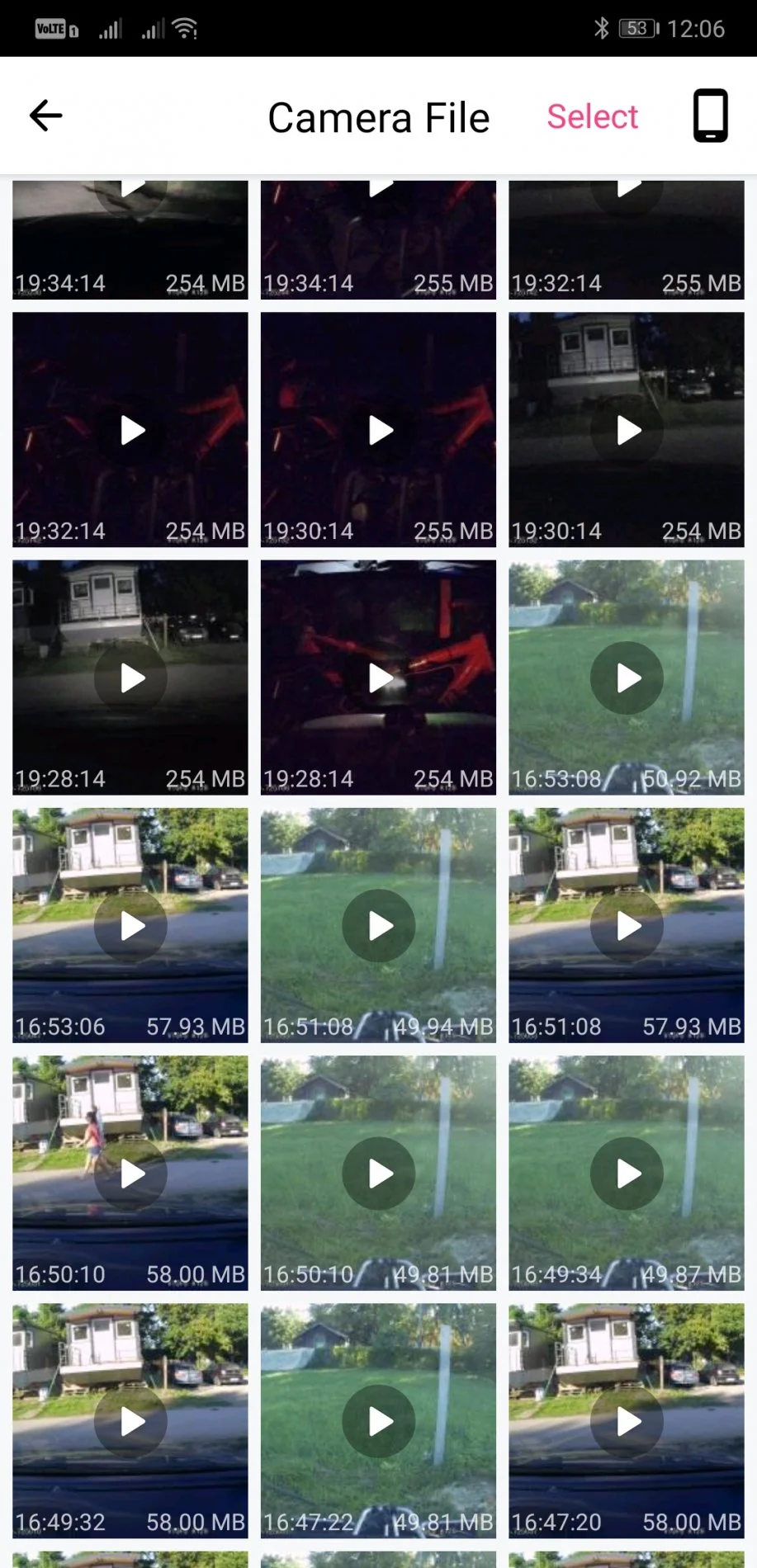

Hello,
My A129 Duo sometimes also stop recording, after a few hours of parking mode.
I have a Blackvue B124 battery back, what is hardwired to my car fuse panel, and the A129 Duo with HK3 hardwired kit connect to B124 battery (the HK3 cutting voltage switch set to the minimum value), and so the dashcam automatically turn on parking mode when stop my car, and back to normal recording when start the car. I use this setup about 2 months ago, the battery keeps powered on the dashcam approx 24 hours in parking mode, and usally works perfect.
But yesterday, and somtimes earlier, after a few hours (2-3) of parking mode stopped the recording, and when I went back to the car, and turn the engine on, started the recording again.
The cam firmware is official 1.9, I using auto detect parking mode.
The B124 battery is fully charged, when I leaved the car, so it should have worked.
The outside temp is about 27-28 degres celsius, but the car was in the shadows.
Has any kind of log of the A129, where I can see why turn off the parking mode recording? Or what is the problem?
My yesterday recording, where appears the gap (16:53 - 19:28).
