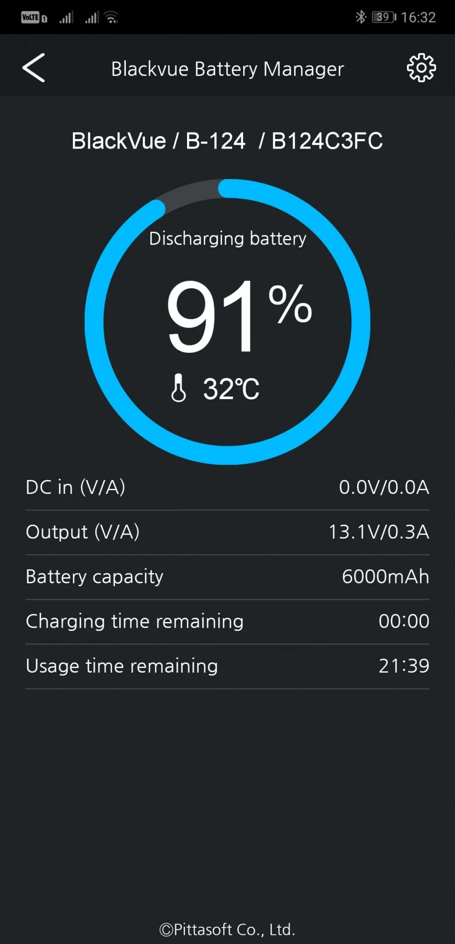

The Blackvue battery has an app, what is connect to the battery via bluetooth, and yesterday I checked the battery, when I went back to my car. At this time the battery pack was about 70%.
At this moment I testing my setup again. I stopped the car about 3 hours ago, the A129 switch to parking mode, and at now it seems working (REC led blinking, and change to permanent light when walk before the camera).
I check the battery: 91% after 3 hours. I think this is good.

Yes, I checked. Today's 4 hours test is perfect. The camera is recorded when motion is happened.
