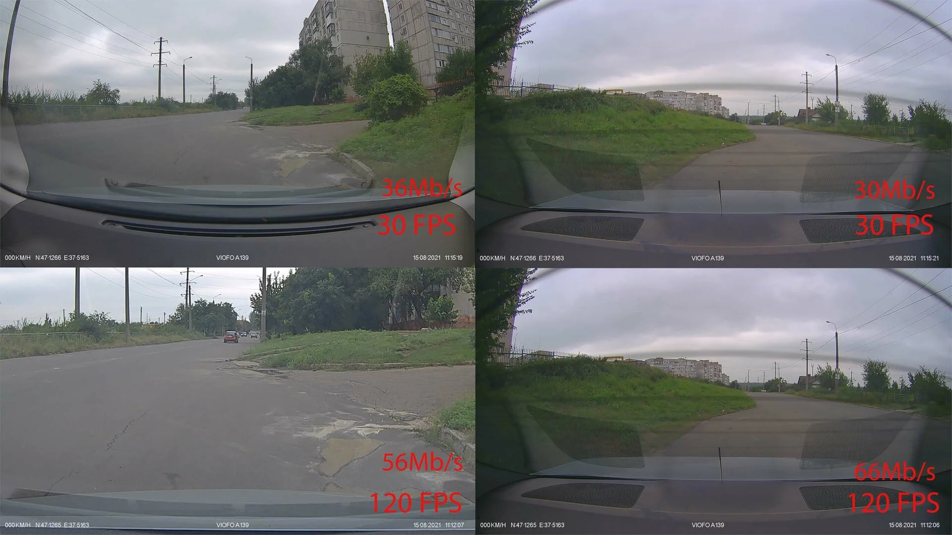

I started to work on firmware for 139 and the first thing I encountered was that, on firmware v1.6 0708, 139 does not switch to card reader mode, but on the official v1.5 everything is ok !!
Is that so for everyone?

@vvs49 I assume you run it in 1Ch setup, any chance of modification 2Ch? (I mean, increasing bitrate also for a remote camera?)
Btw: Why is the bottom left zoomed in? Is that also 1440p, considering it looks like your car haven't moved in compare to the one at the top?

I measured the CPL filter, it naturally does not completely remove glare, but still much better !!
I did not understand the whole post, the translation is not very good.
The bit rate can be changed for any camera, but I do not know how it will affect the parking mode.
So far I just started experimenting and am still waiting for news from VIOFO !!
Ok, you did get the question about bitrate.
That btw part was meant for the attached image. You've mentioned that all the pictures are in 1440p but the bottom left (56Mbps, 120fps) seems like "zoomed in"/ cropped in compare to the top left one (36Mbps, 30fps).
