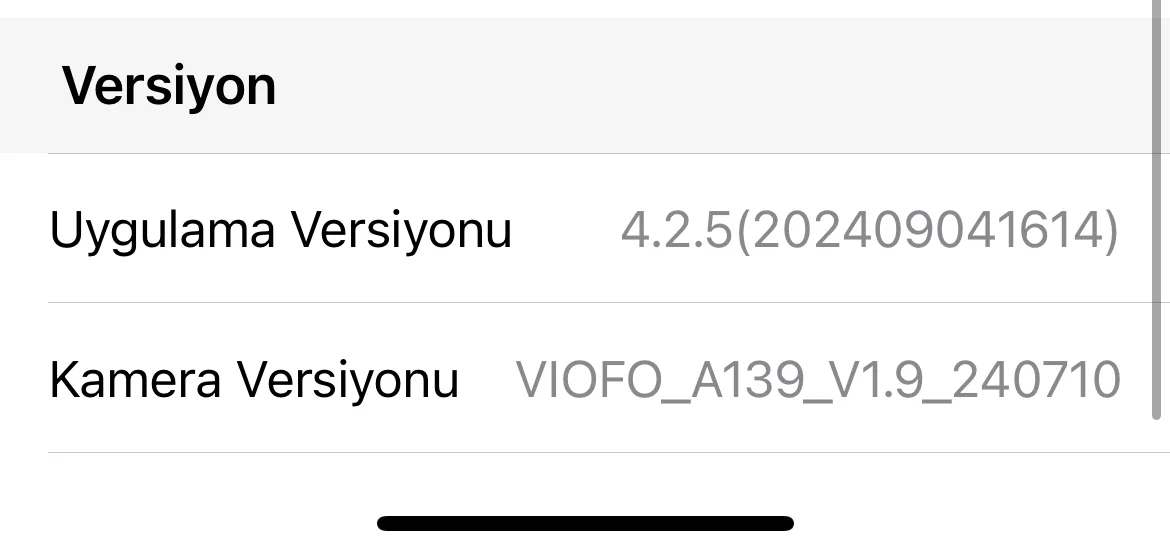

Updated firmware yesterday and i realised that, when I use the app and go settings, after that the notification is wrong: (video protected) it must be (recording started)
I also figured out that, sometimes dashcam looks working well with the leds. but not recording anything. Is that may about my samsung card?

Have you reset the camera after updating? If not, please reset to test. If the issue persists, would you mind update a video showing the issue for analysis? You can uplod it here: https://viofo.wetransfer.com/
Deeply format the card on your PC with our GUI format tool to have a try. It does not help, it is better to change the recommended card to have a try.

If you haven't updated the app recently, it may be worth doing so.
It is a good idea to reset the settings to default after a firmware update, using the option in the setup menu. (Not sure if that is what Viofo Support meant by a reset, or if they meant to press the reset button).
Thanks for reply and support. You mean factory reset with using app?
Pause the recording by short press the REC button first, then long press the emergency button and wifi button at the same time for seconds to reset the camera.
I reset my camera and solved the voice notification problem. But I need time to find out if the fake recording problem is solved or not.
