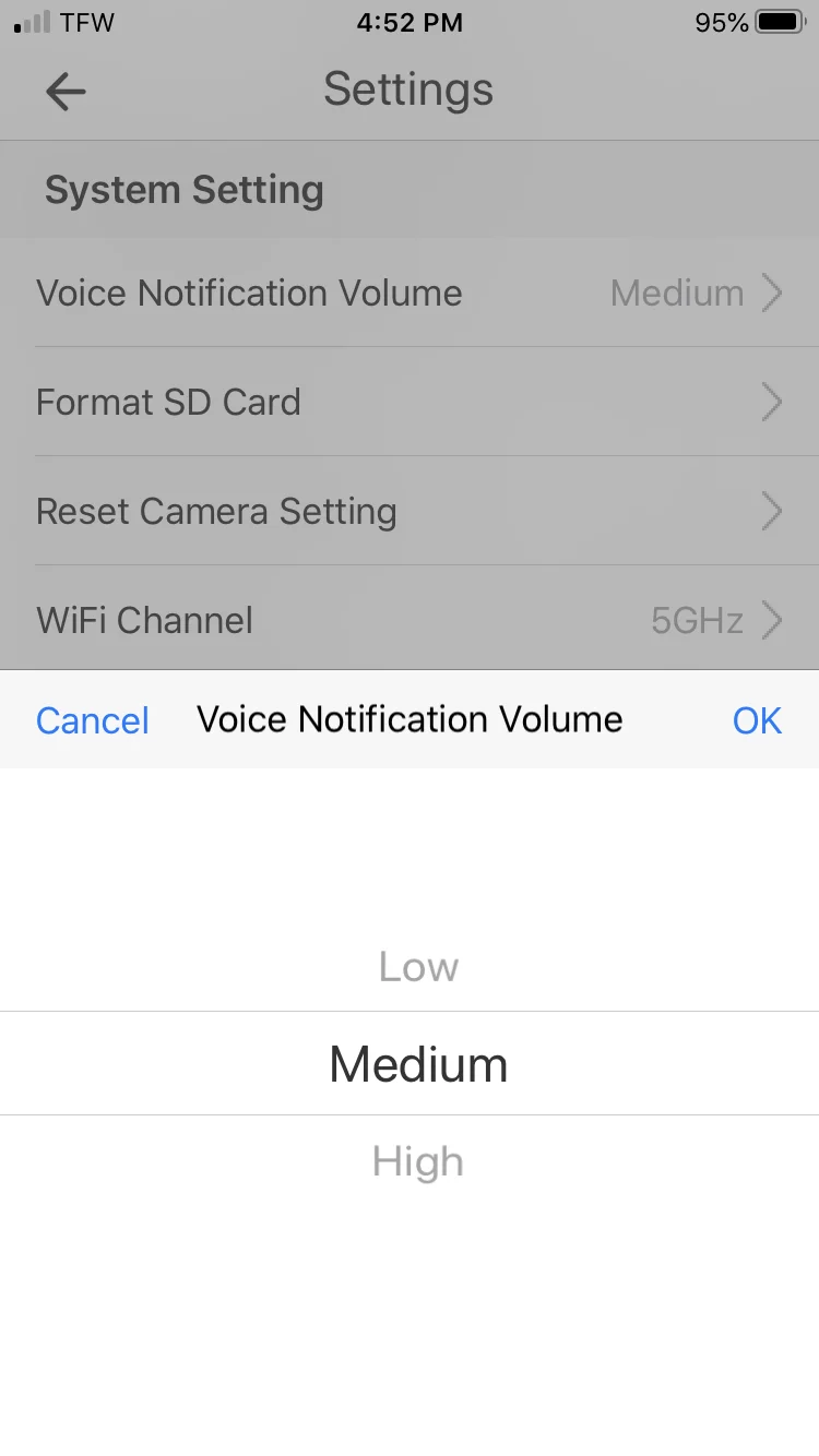

Blown Speaker
About a month ago I noticed the speaker on my A229 was sounding different / distorted during the start up chime, and voice notifications. Now the speaker is blown. Of course when I try to get the malfunction recorded on film it doesn't capture the audio distortion. lol
As a preventative measure I have adjusted the voice notification volume level to Medium on my A139 Pro. In the hopes the speaker doen’t blow on it as well. Since I get these cameras for free as test samples I don’t think I have a right to complain. However, if I was a paying customer I would most likely return the camera as defective within the 30-day return policy, or file a warranty claim with the 1-year warranty, or 18-month extended warranty with registration.
Hopefully @viofo will get around to adding the Voice Notification Volume level in APP for the A229, A119 Mini, and any other cameras with voice notifications. But I hate bothering them with APP firmware update requests that don’t have anything to do with image quality, or reliability.

I agree the same.
I opened a similar thread for this. but for some reason the comments went the other way and there was no support.
