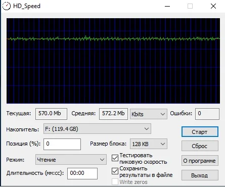

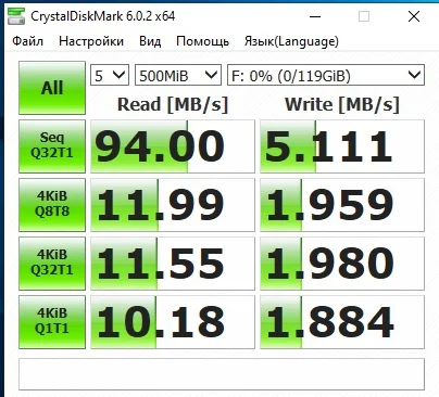

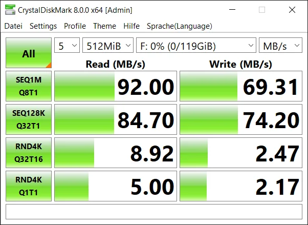

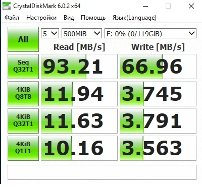

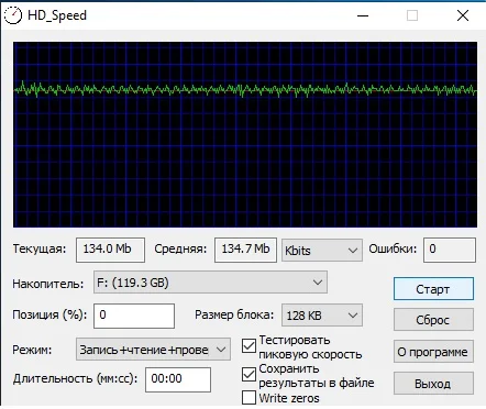

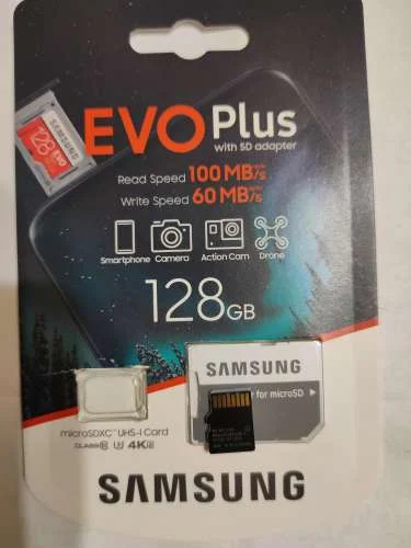

Since such a dispute about memory cards has already begun, I will show a test of two of them with the same name, but with different characteristics.
Several memory card tests. You can ignore the name, as some advise.
According to the declared write and read speeds, both memory cards should be on top.
Memory card test after purchase.
Test after 15 hours of testing in A119V3 with a bit rate of 50Mbps.
This test was done by the user "gse".
Memory card test after 29 months of operation.
This is a test of my memory card which still works in A119V3.
