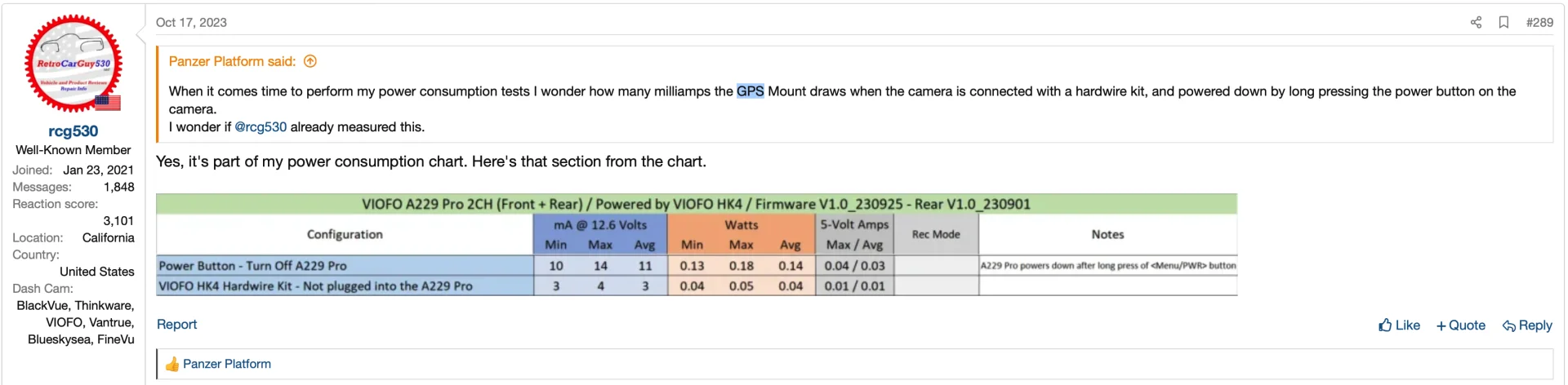

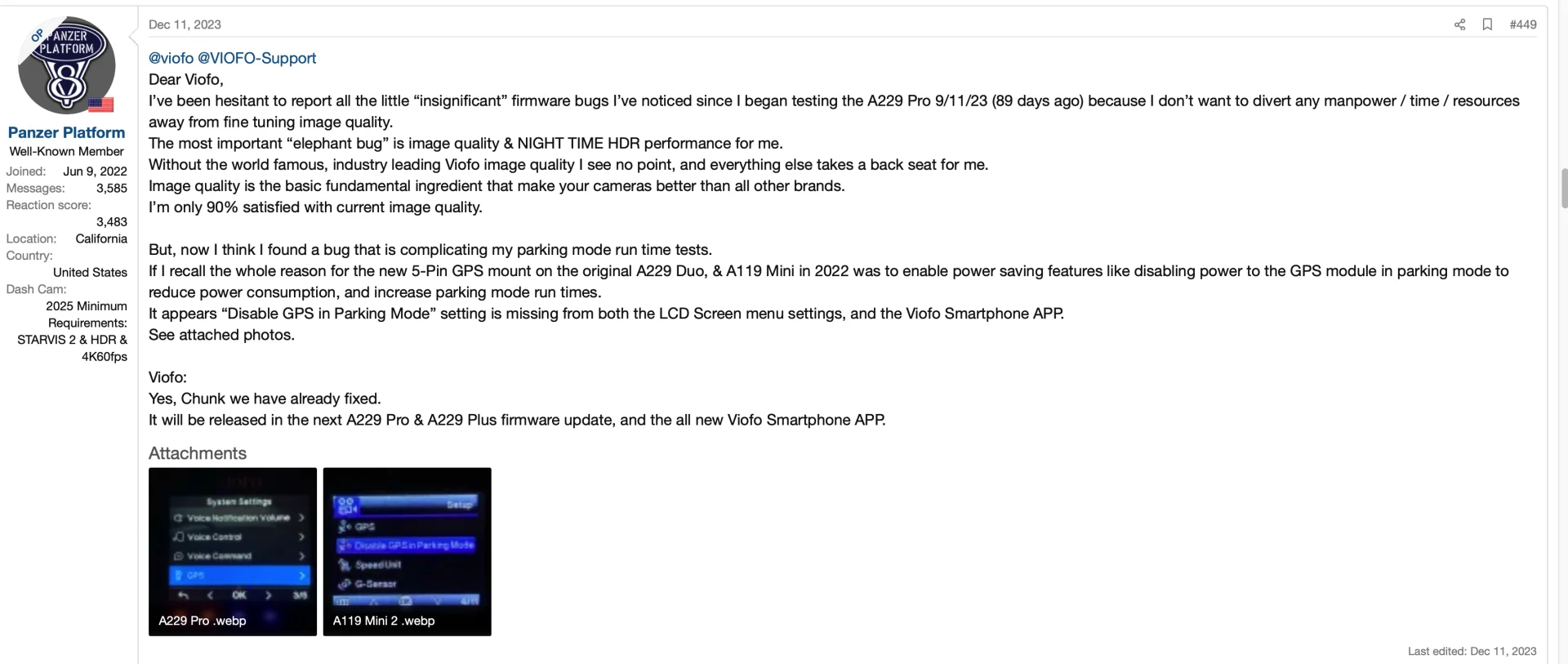

The last post I found regarding GPS power testing in the A229 Pro Test & Review PP thread was Post # 449 on page 23 of 39 but VIOFO had not yet provided "Disable GPS in parking mode" yet.
Post # 289 kind of answered the question showing 140 mW average power from the entire camera assembly including the GPS. The assumption would be most of the power is for the GPS when the unit is powered off. I could use my Powercell 8 app to get a ROUGH idea how much current the camera draws with GPS off vs on in parking mode since I think VIOFO did add the GPS disable capability.
Or perhaps I just missed @Panzer Platform actual test results. I struggle a bit with the "advanced search" feature.
