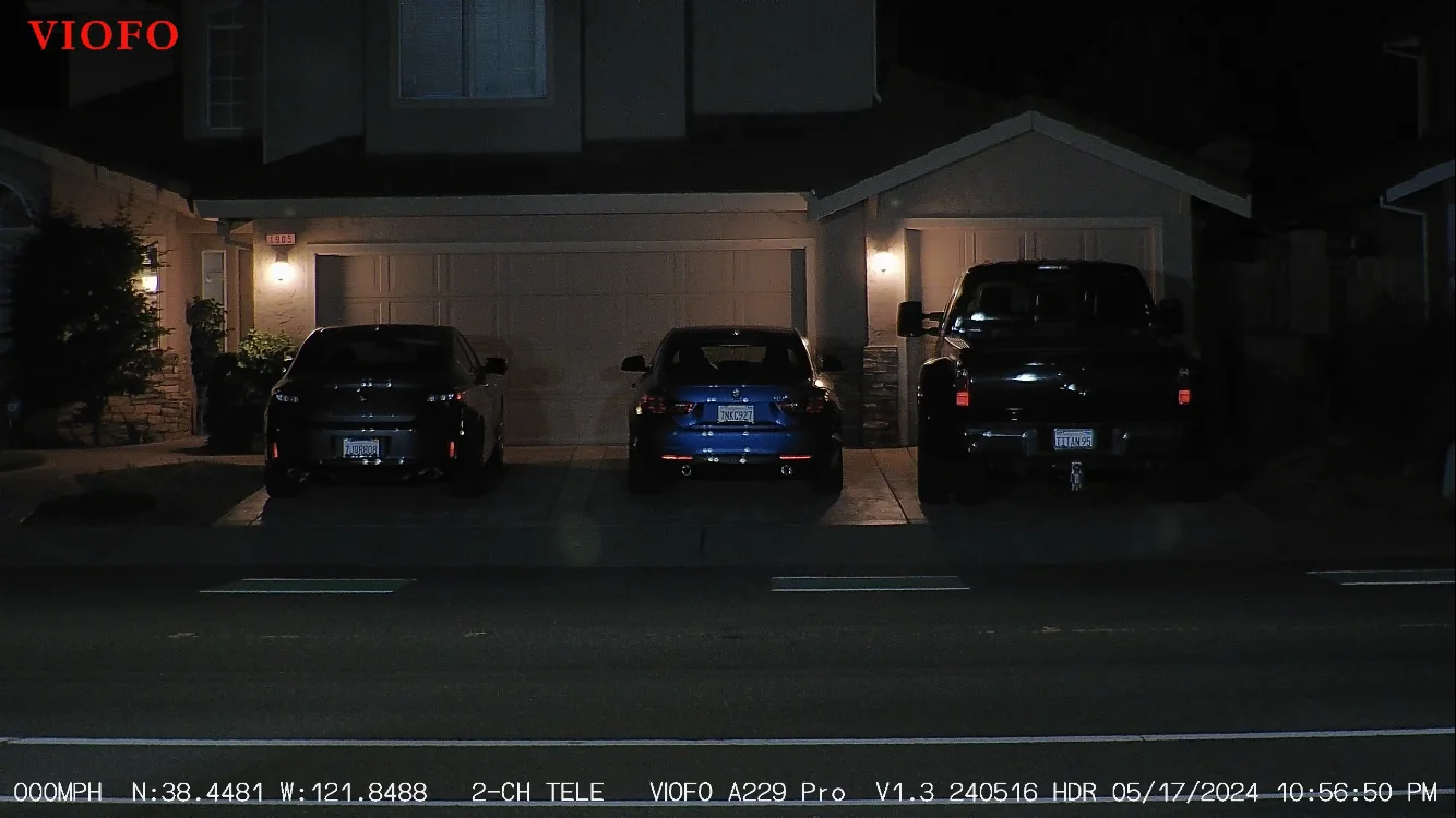

Does this help with night videos at all? I have a slight tint and I can tell with my camera it's hard to read anything.Oops.

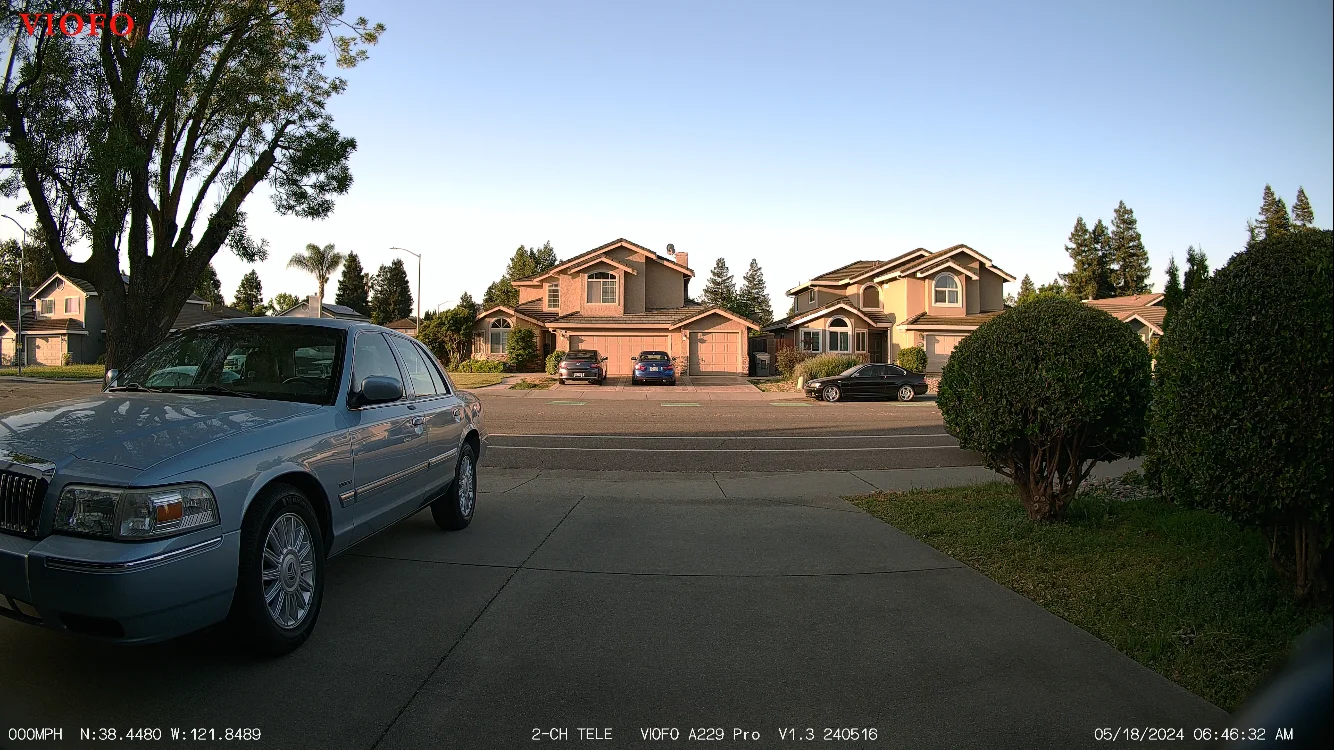

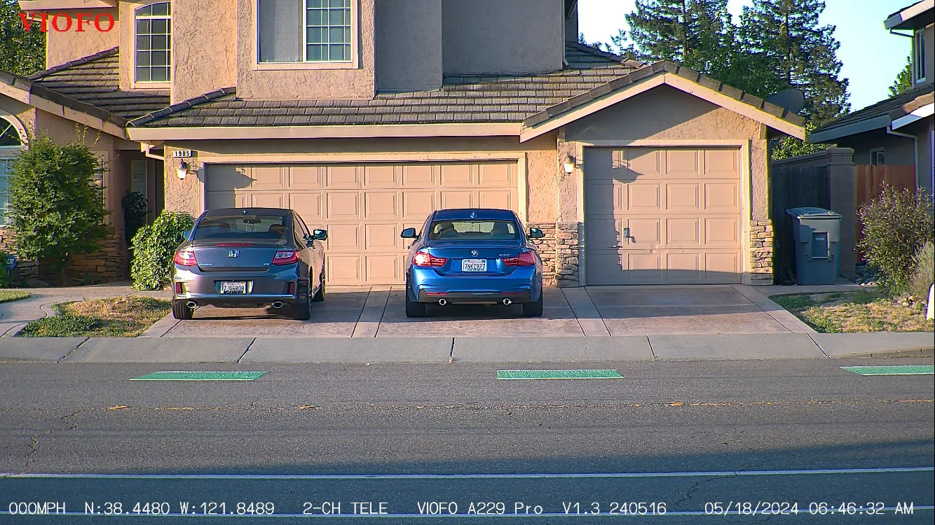

I was so excited to get testing I forgot to take photos of the telephoto cameras.

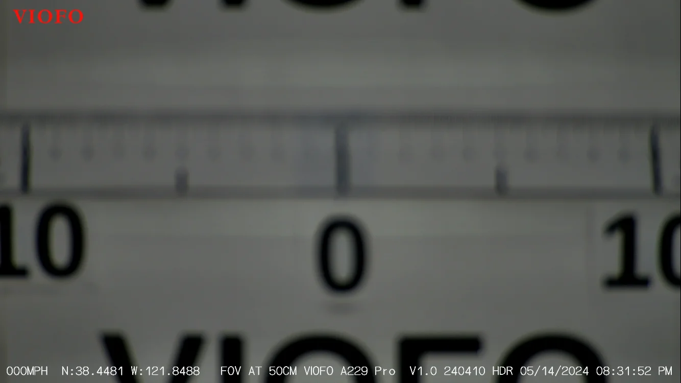

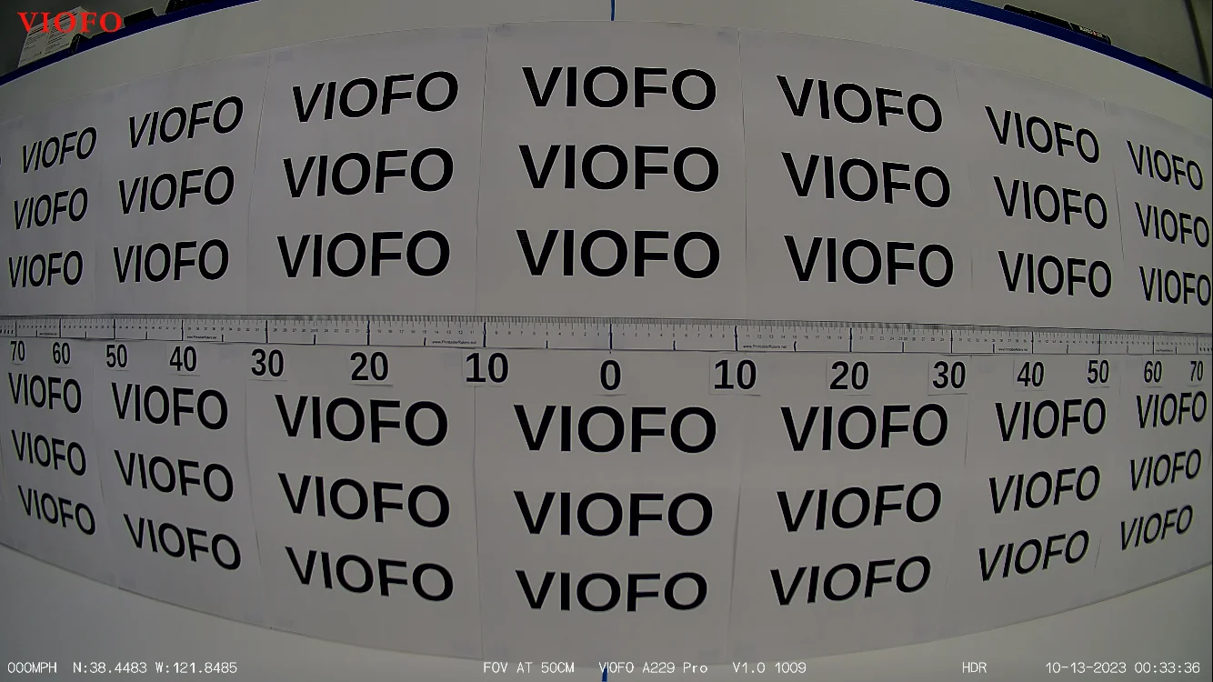

Such a measurement is completely wrong and erroneous. The scale of the angles must be circular24.6° is what I measured the Horizontal FOV to be for the new Telephoto Remote cameras for the A229 Pro & A229 Plus.
For reference I measured the Horizontal FOV of the Front camera to be 112° FOV.
Shooutout to @DAP for suggesting test patterns to check focus.
It looks like I’ll need to modify my testing jig to back off the camera a bit.

The measurement is wrong, but he corrects it using a calculator, see post #611.Such a measurement is completely wrong and erroneous. The scale of the angles must be circular
Incorrect.Such a measurement is completely wrong and erroneous.
Yes, you're right, thank you for pointing that out.Such a measurement is completely wrong and erroneous. The scale of the angles must be circular
Ideally, the distance should be enough for the lens to be in focus, but with a straight scale, more than 50cm is going to be somewhat impractical. Building an accurate circular scale is going to be rather time and space consuming.However, for wide-angle lenses, the distance to the scale should be more than 50 cm, when there is a strong optical distortion of the scale and a possible error in the reading of the detected value
