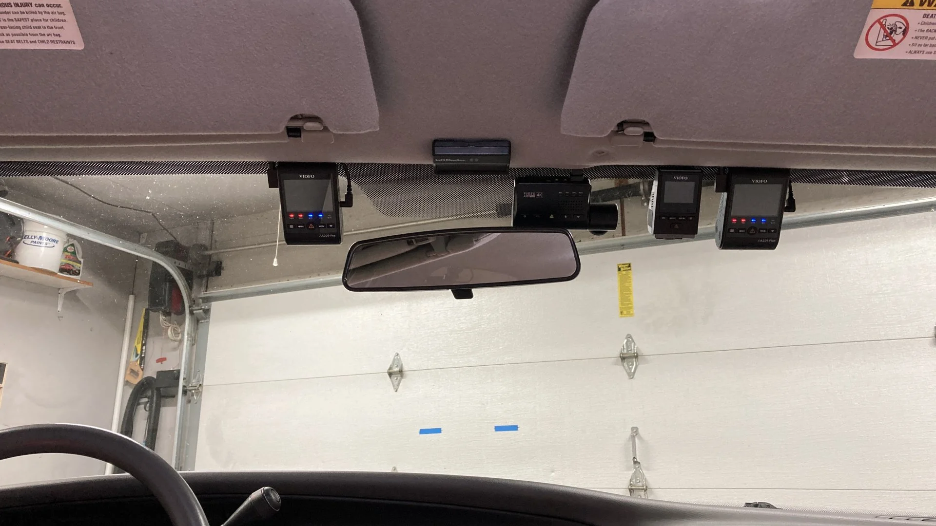

I performed a heat comparison test with the A229 Pro 3-CH & A229 Plus 3-CH in Low Bitrate Parking Mode.
When I performed this comparison test September 27, 2023 the cameras were in Normal Recording Mode;
To get baseline measurements I let the cameras get to normal operating temperature by letting them operate in Normal Recording Mode for 3 hours.
I configured the cameras with identical settings, (Max Resolution & Bitrate etc).
After 3 hours I took measurements with my TOPDON TC004 Thermal Imaging Camera.
Time: 12:20PM
Garage Ambient Temp: 65℉ (18℃)
Cooking Time: 3 Hours
Firmware: V1.2 240227 (both)
Bitrate: Maximum
IR LED’s: OFF
Pro SD Card: Viofo 64GB
Plus SD Card: Viofo 64GB
Loop Record: 3 Minute
Pro Hottest Temp: 134℉ (56℃)
Plus Hottest Temp: 124℉ (51℃)
Difference: 10℉ (5℃)
Next I enabled Low Bitrate Parking Mode, and let the cameras operate for 2.5 hours.
Time: 2:50PM
Garage Ambient Temp: 75℉ (24℃)
Cooking Time: 2.5 Hours
Pro Hottest Temp: 133℉ (56℃)
Plus Hottest Temp: 125℉ (51℃)
Difference: 8℉ (5℃)
Time: 12:20PM
Bitrate: Maximum
IR LED’s: OFF
View attachment 72092View attachment 72093
Time: 2:50PM
Difference: 8℉ (5℃)
View attachment 72094View attachment 72095

Cool fun tests
So the only real difference is that they heated the garage up by 6°C between the two readings, while the cameras stayed at the same temperature!
