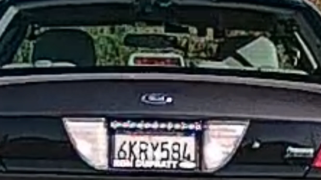

Q: What is the maximum stationary distance the Telephoto can capture a US license Plate?
A: Approximately 40 Meters.
I will confirm the exact distance with NIGHT TIME testing.

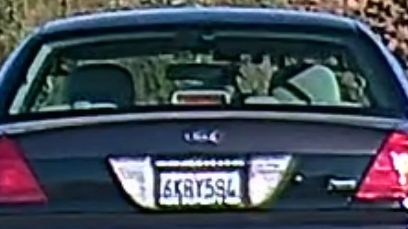

Q: What is the maximum stationary distance the Front / Main can capture a US license plate?
A: Approximately 10 Meters.

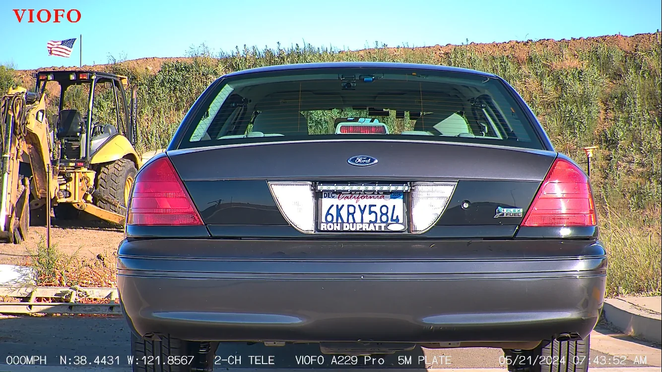

Q: What is the minimum focus distance of the Telephoto?
A: Viofo informed me the minimum focus distance is 20 Meters.
However, It looks pretty darn good at 5 Meters.

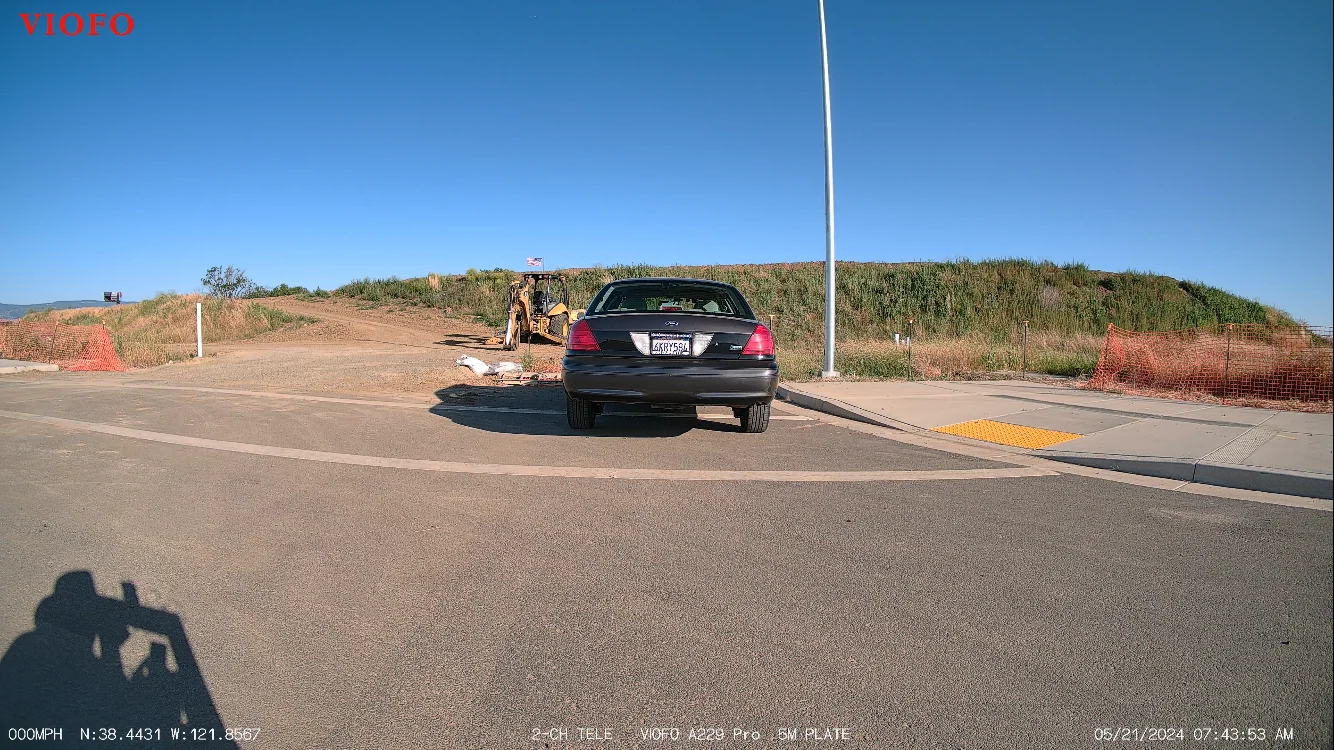

Also here’s the Front at 5 Meters for comparison;

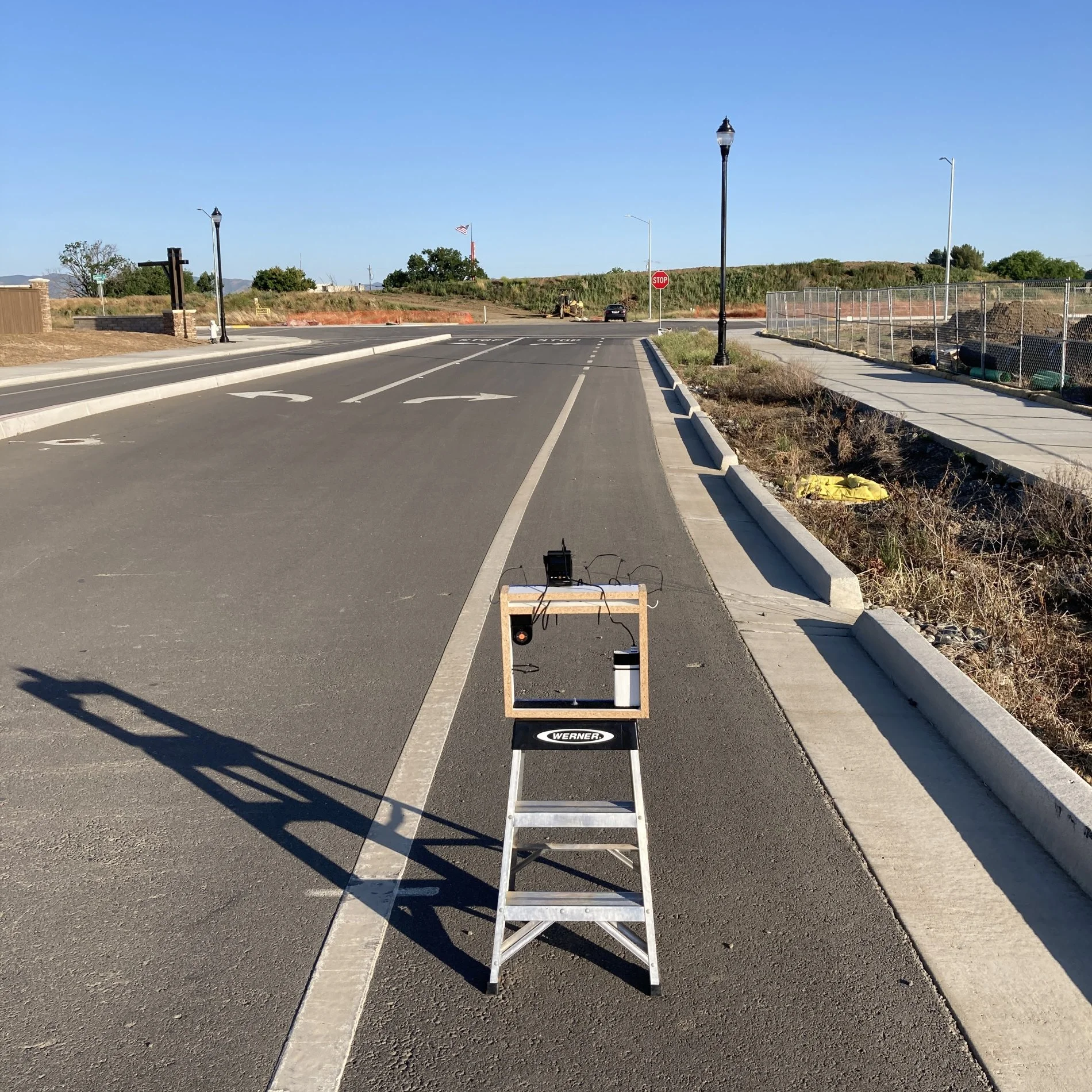

I started at 100 Meters, and made stops at 90M, 80M, 70M, 60M, 50M, 40M, 30M, 20M, 10M, 5M.

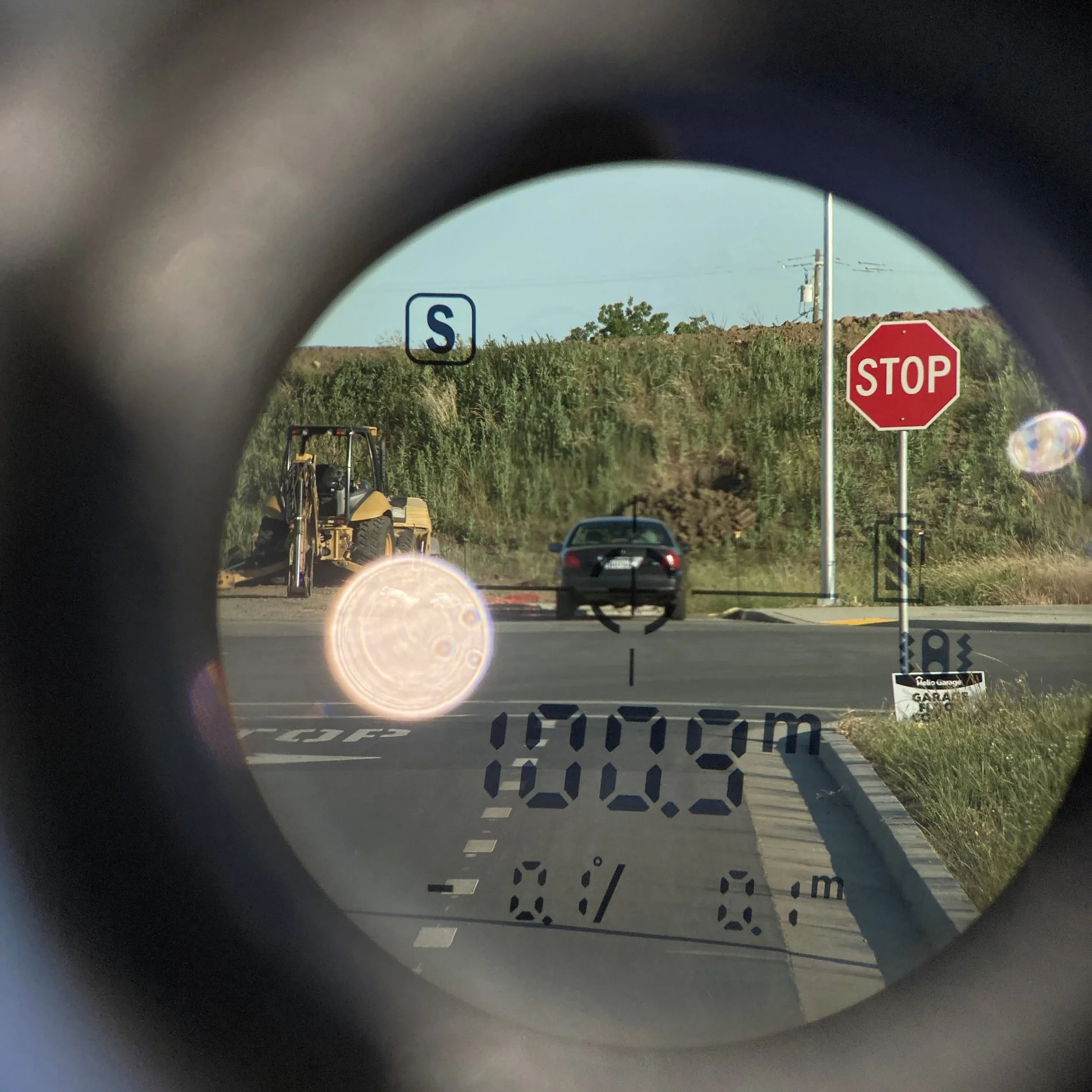

Here’s photos standing at 100 Meters, and Laser Rangefinder reticle;

That is definitely in focus at 5m, I guess Viofo are only saying 20m for warranty purposes, since it will be difficult to get them all in good focus at 5m and 80m, yours might have had some extra care put into the focusing.
It will probably have the plate out of focus if you stop directly behind someone?
But it will be in focus to see what is on the phone screen being held by the driver.
