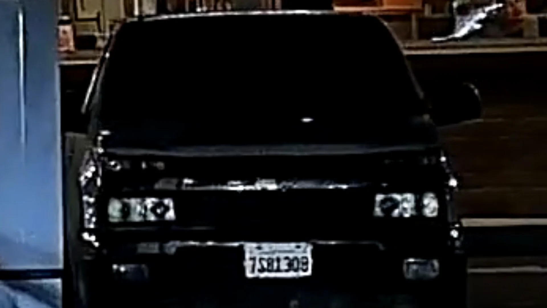

Let’s look at the first 5 Seconds of the 2K Telephoto, and 4K Front clip.
At 0:00 there is a small pickup truck parked across the street almost directly in front of me.
At 0:01 I turn on my low beam headlights, and the front license plate lights up like a billboard. lol
CA Plate #7S81308 2005 Chevrolet Colorado Z71
(yes, I have low quality, cheap, non-DOT approved, aftermarket LED bulbs in my traditional reflector headlamp housings, not ideal)
I had my trusty laser range finder with me for measuring exact distances just for occasions like this, but I was not aware at the time I would need the measurement.
Next time I leave the house I will measure, and update this post with the exact measurement.
Using my “Kentucky Windage” I would say the distance is around 25 Meters.
Let’s see how good my guess is.
*****(edited 8/4/25 8:18PM well I was way off, I just got back from measuring the distance with my laser range finder, and it's a whopping 42.2 Meters!)*****
Here are some screenshots, and a split screen video.
The first two screenshots are the original size.
The last two screenshots are “zoomed in”.

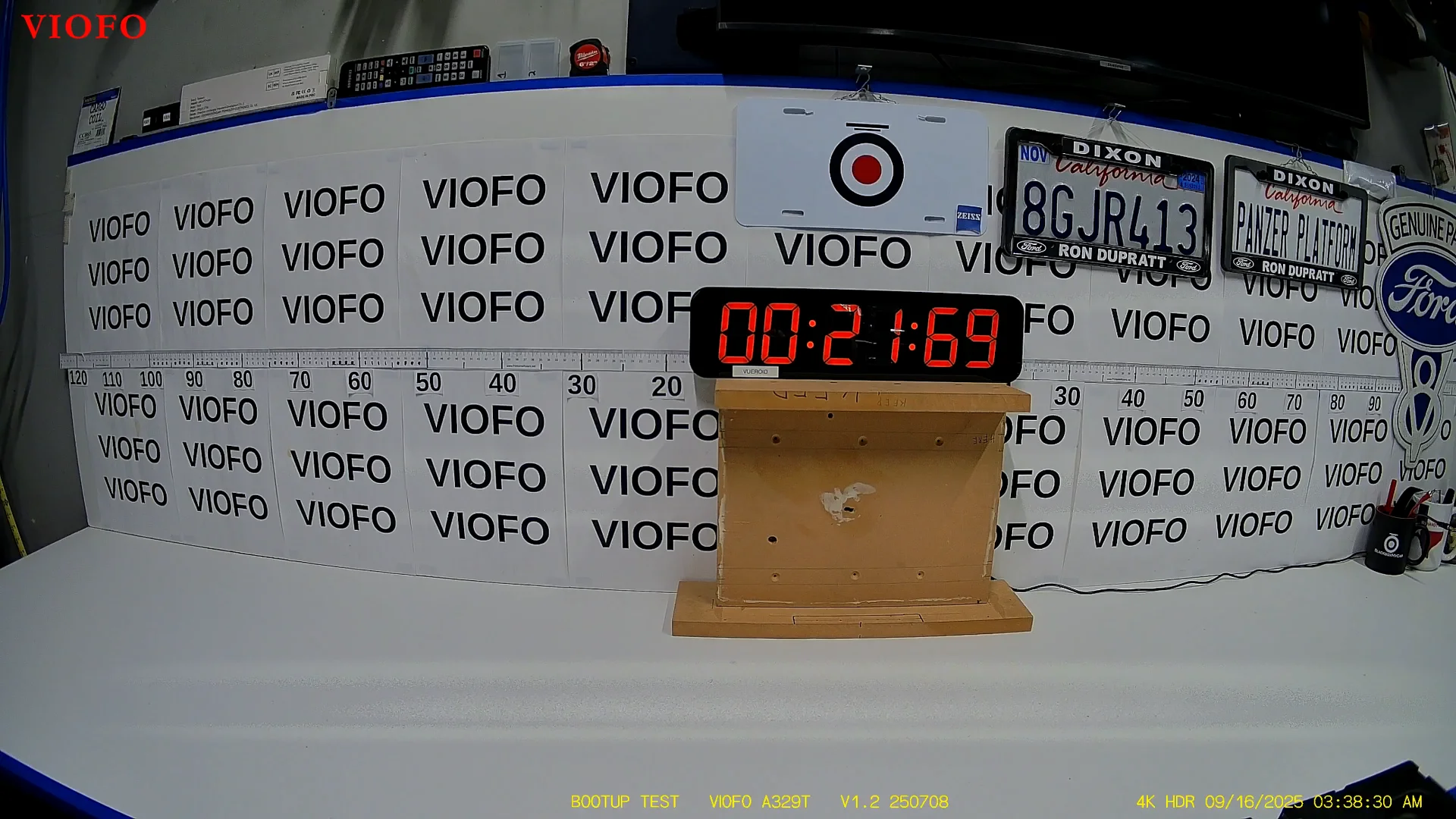

The A329S 3CH (2025) & A329 2CH (2024) have the same processor.
BOOTUP SPEED TEST
13.69 Seconds A329
21.69 Seconds A329S

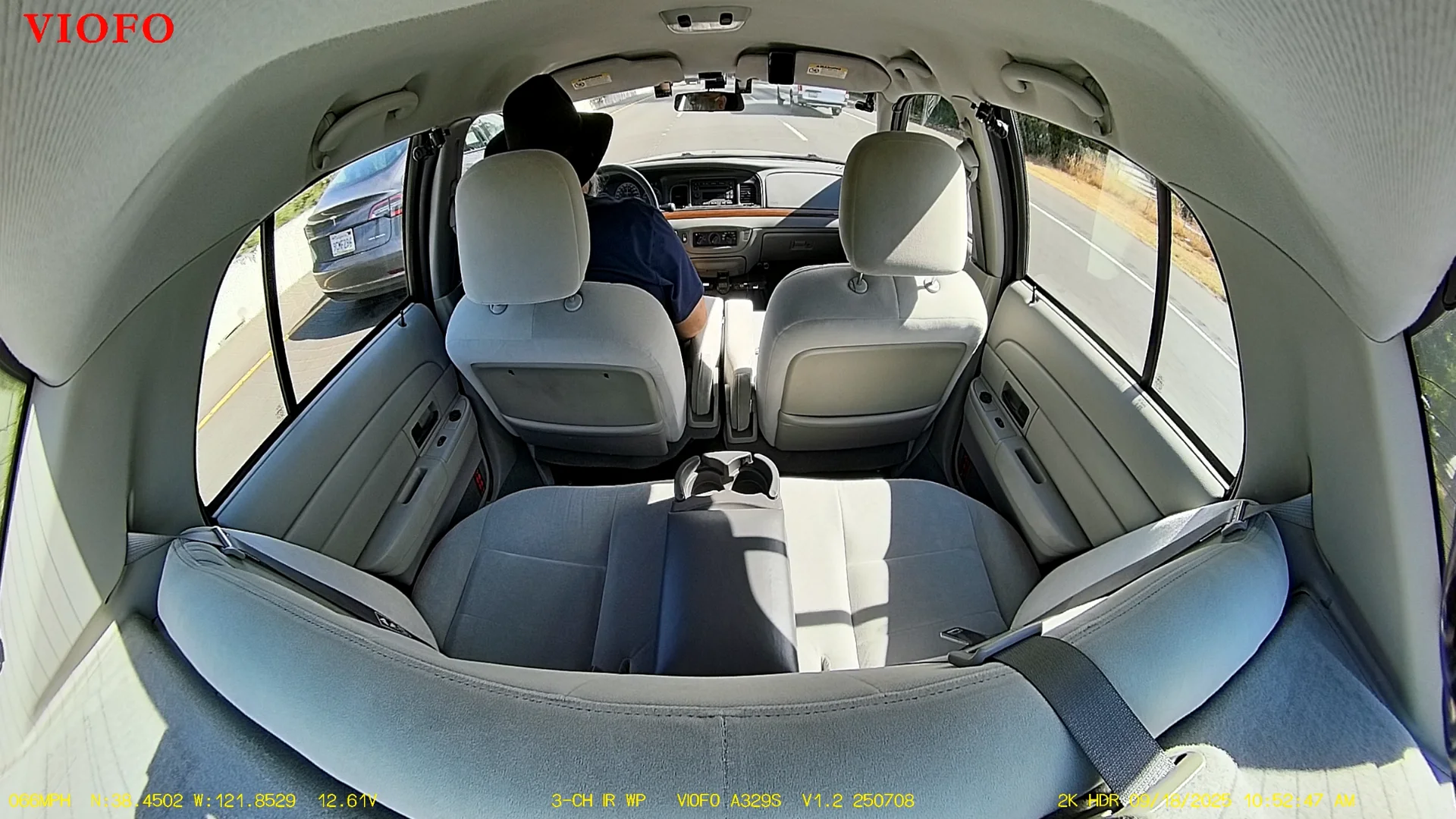

Here’s a random screenshot showing the difference between S1-4K & A329S IR Interior FOV.
Both are able to capture plates of passing cars;
CA Plate# 9CMF296 2022 Tesla Model 3 Long Range
145° Measured Horizontal FOV S1-4K
179° Measured Horizontal FOV A329S
I’ll follow up with night time footage in IR B&W, and also show how accurate / fast each camera is at transitioning from B&W to Full Color, and back to B&W.

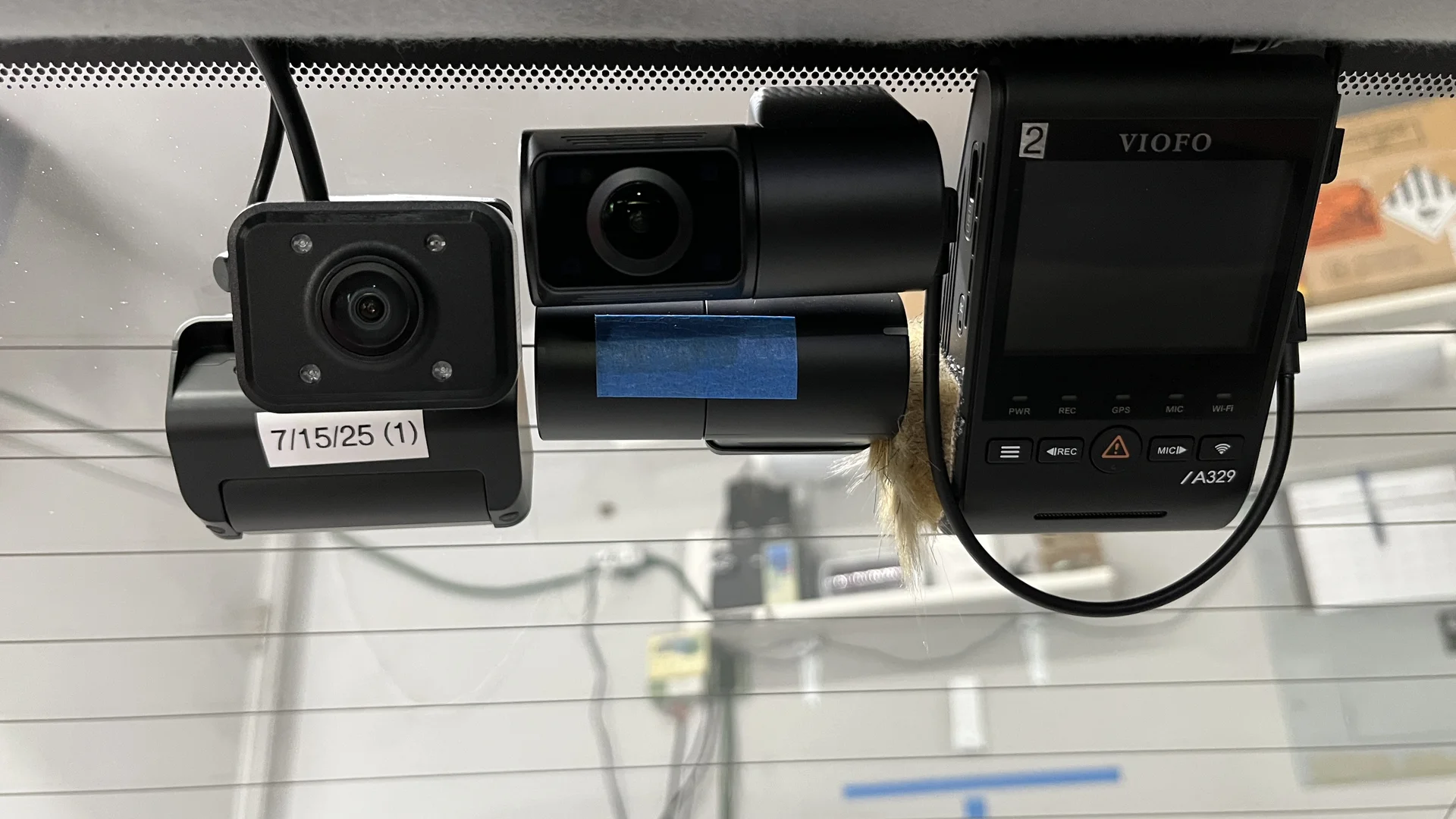

Here’s a photo showing how both IR Interior cameras are mounted;
Nobody ask what the star trek tribble is, (it’s a dead cat for wind noise). Lol

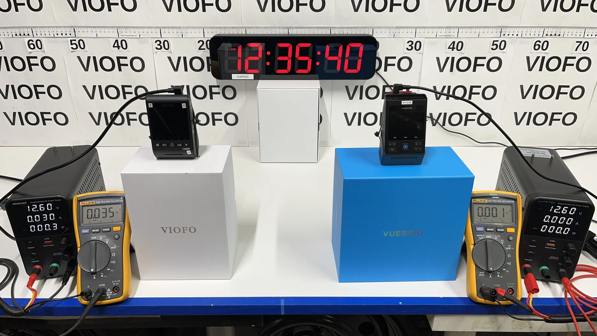

A329S vs. S1-4K - Power Consumption / Heat Signature / Parking Mode Wake Up Speed Test
Q: What is the difference between A329S vs. S1-4K?
1.) Power Consumption: ELPM (Extreme Low Power Mode) vs. LPID (Low Power Impact Detection)
2.) Heat Signature: ELPM vs. LPID
3.) Parking Mode Wake Up Speed Test: ELPM vs. LPID
A:
POWER CONSUMPTION: ELPM vs. LPID
1mA x 12.6 Volts = 0.0126 Watts S1-4K
35mA x 12.6 Volts = 0.441 Watts A329S
HEAT SIGNATURE: ELPM vs. LPID - Garage Ambient Temperature 81℉ (27℃)
85.7℉ (29.8℃) S1-4K
92.2℉ (33.4℃) A329S
6.5℉ (3.6℃) A329S Hotter

PARKING MODE WAKE UP SPEED TEST:
1.11 Seconds A329S LPID
1.18 Seconds S1-4K ELPM
TESTING NOTE: Performing the parking mode wake up test is extremely difficult because it requires me to start the clock, and trigger an impact at exactly the same time.
This introduces my own human error of reaction times into the test data.
I practiced this around 10 times, and when I got it down I performed multiple tests to get an average time for each camera.
We need these results to be confirmed & verified by other testers.

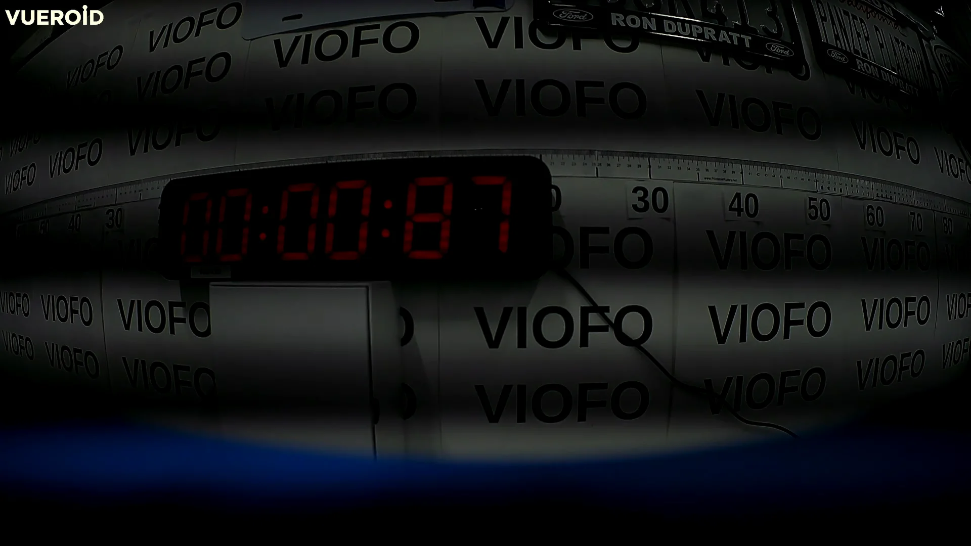

I can see the clock on the S1-4K at 0.87 Seconds, but it’s so dark I don’t think its useful, so I’m going with 1.18 Seconds when the image illuminated to almost full brightness.
LMAO! I just watched the Sony Action Cam footage in 1/4 slow motion, and it looks like I start the clock about 0.25 Seconds after I slap the table.
Man, I’m way off. lol

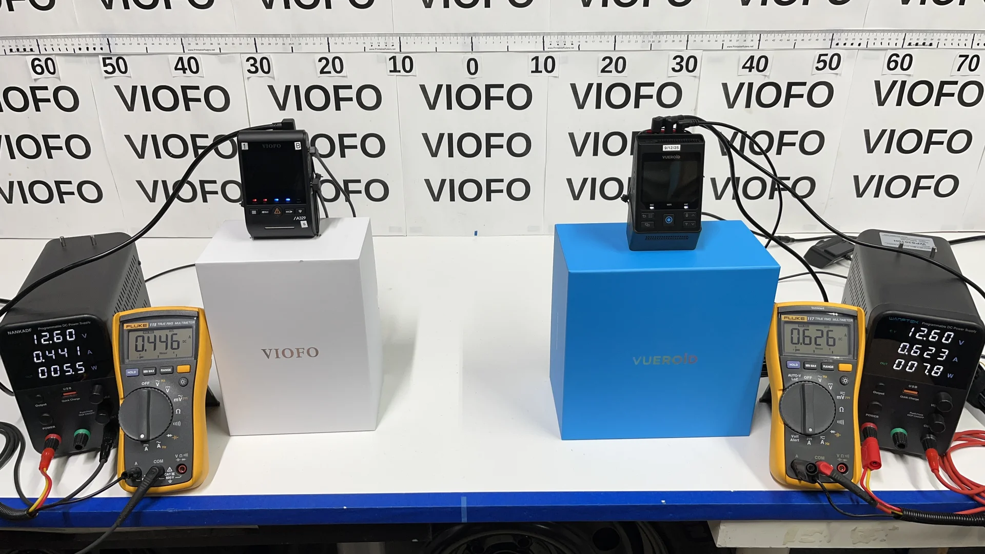

A329S vs. S1-4K - Normal / Driving Mode - Power Consumption & Heat Comparison
Q: What is the difference between A329S 3CH & S1-4K 3CH in power consumption, and heat signature in Normal / Driving Recording Mode, (daytime driving conditions).
A: See Below
A329S Settings;
3CH Front + Rear + IR Interior
Firmware V1.2_250708
256GB Viofo SD Card
Wi-Fi Off
LCD Screen Off
Maximum Bitrate
HDR Off (front & rear)
HDR On (interior)
IR Interior LED’s Off
S1-4K Settings;
Firmware 1.2.0
256GB Vueroid SD Card
Wi-Fi Off
LCD Screen Off
Maximum Bitrate
Driving Recording Only Memory Allocation (to prevent going into parking mode)
HDR On (default)
IR LED’s Off (there’s no On / Off / Auto setting so I had to put a light in front of the interior camera light sensor to make sure they did not illuminate)

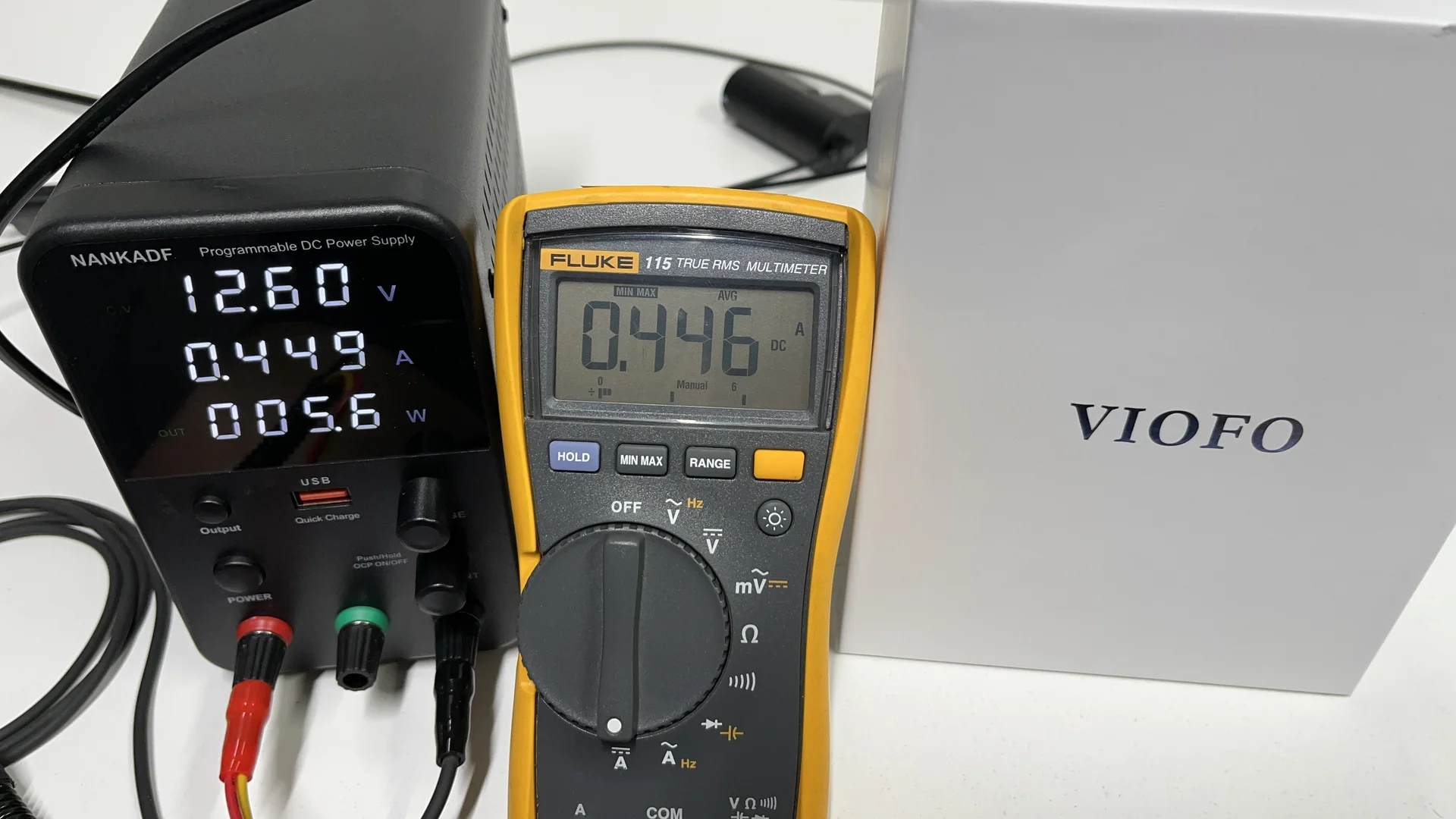

I let the both cameras operate in normal / driving recording mode for 1 hour.
I used the MIN / MAX / AVG function on my Fluke 115 & 117 to get the average amperage / current draw.
POWER CONSUMPTION:
446mA x 12.6V = 5.6 Watts (A329S 3CH)
626mA x 12.6V = 7.9 Watts (S1-4K 3CH)
2.3 Watts More S1-4K

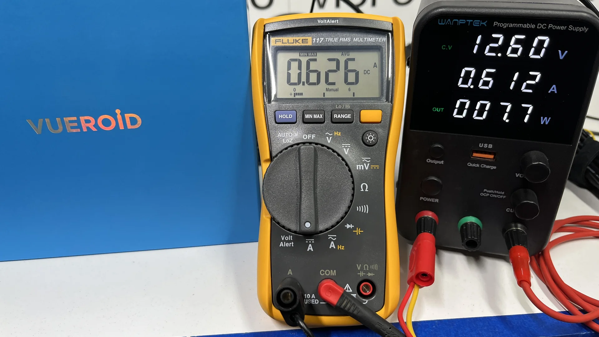

A: See Below
A329S Settings;
256GB Viofo SD Card
Wi-Fi Off
LCD Screen Off
Maximum Bitrate
HDR On (interior)
S1-4K Settings;
Firmware 1.2.0
Wi-Fi Off
LCD Screen Off
Maximum Bitrate
HDR On (default)
POWER CONSUMPTION:
HEAT SIGNATURE (highest observed temperature)
Garage Ambient Temperature 76℉ (24℃)
147℉ (64℃) A329S
166℉ (75℃) S1-4K
19℉ (11℃) S1-4K Hotter
View attachment 85486View attachment 85487
View attachment 85488View attachment 85489
View attachment 85490View attachment 85491
S1 4k has embeded Hardwire kit. that's why the temperature is higher. ( the input voltage of S1 is 12V , and make 5V inside the S1, it make some heat).
If I perform the comparison again powering S1-4K through Type-C input, (5V instead of 12V) will the temperature be lower?
Most of my testing / comparisons provides little value.
This was to satisfy my own curiosity.
I doubt the camera would experience overheat / malfunction in normal driving mode, driving down the road with A/C & airflow.
