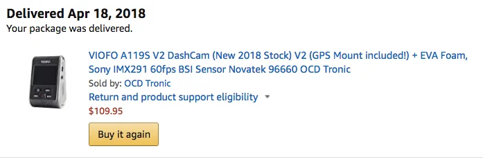

A little confused here.
When I go on my past Amazon orders, the seller shows as "OCD Tronic".
When I click on the link to that product that I ordered, it takes me here to Viofo's store.
So who sold me the item? 😕
When I bought my FIRST Viofo A119S, I bought it from a merchant on Amazon called Light In The Box. They took it back with no questions asked, so I went through OCD Tronic, because they were more legit with reviews.
@OCD Tronic will be able to look up the order number and confirm
Wow, they're a member here? That's convenient! 😎
One thing I noticed is...in my OP, I said I had this dash cam for 6 months before things started to go awry...but I think I'm mistaken. April 18th means I've only had it for 2 months. Even less time. 😵
