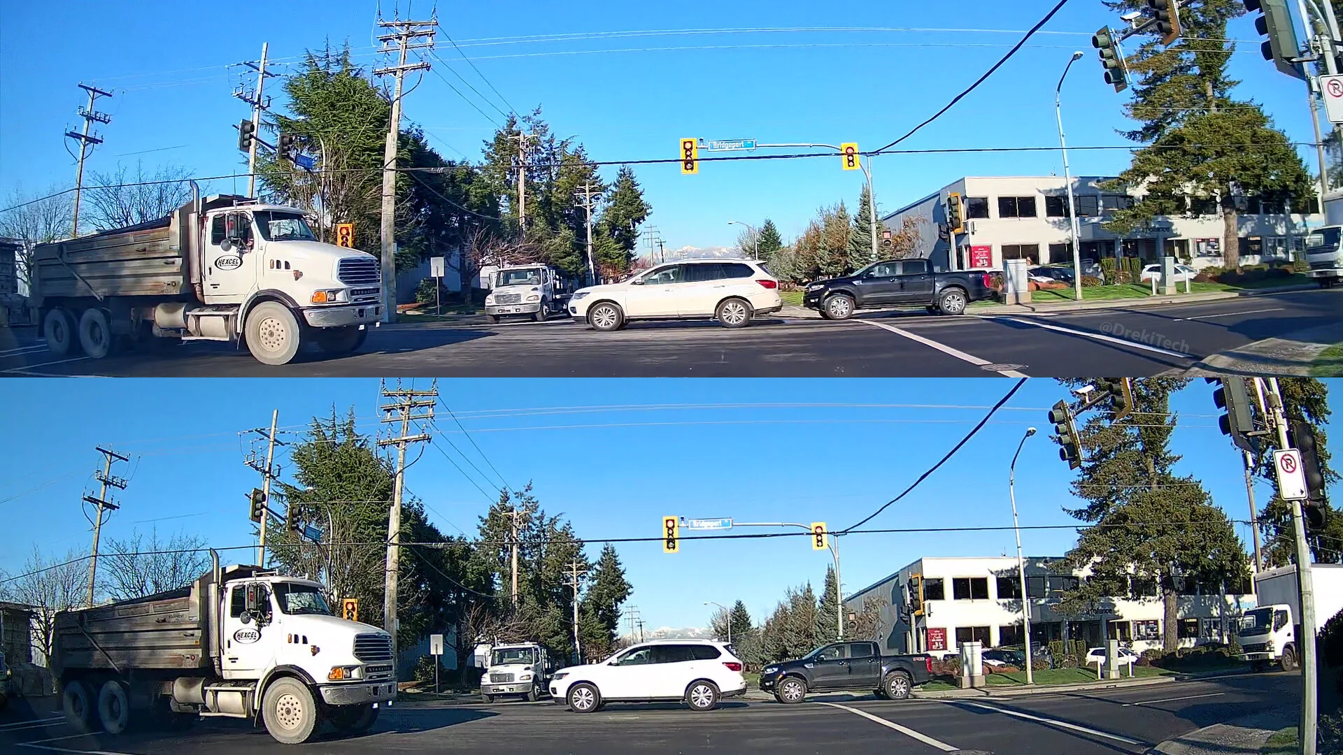

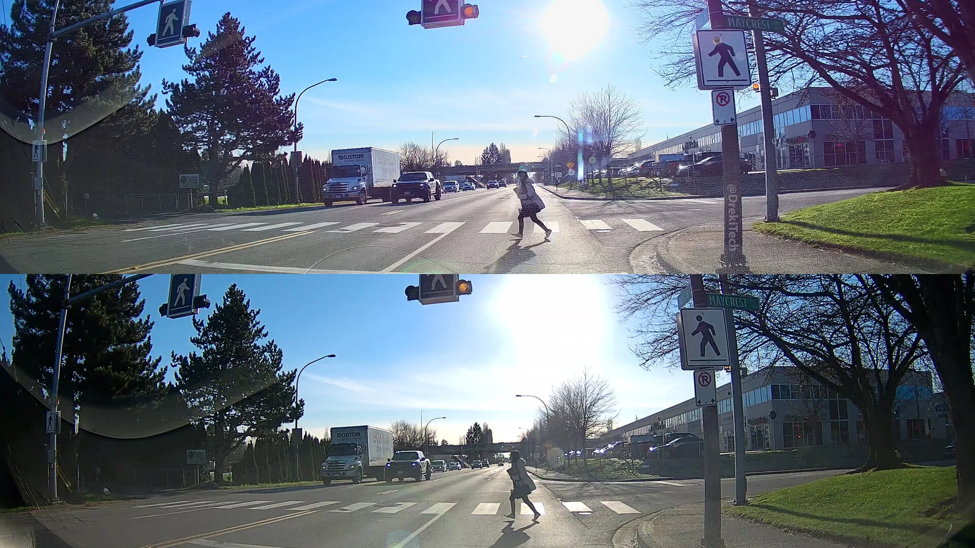

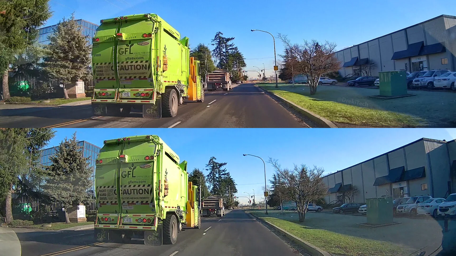

I have included some screen shots below. I'm curious what you like about them. And if you have specific questions you want answered about this camera I'll do my best!
Spoiler about which camera is which:
- Top is Hikvision
- Bottom is Viofo A139
I do have to say that I had the same reaction to the notion of using "HIV" as a file name pre-fix due to the unavoidable association with the disease. I assume "HIV"is meant to imply "Hikvision" in some form but perhaps it should have been (or still could be) something like "HVIS" or something similar.
Aside from that the screen shots are impressive, especially the overall control of dynamic range compared to the Viofo A139.
Question: Is the file name HIV used throughout the Hikvision product range, including CCTV cameras? Or is it just confined to the dash cams?
Impressive!!
I was looking at the pictures very well looking at different points of detail before revealing the spoiler to see which one was which, and to my surprise the one that I found the best to my liking is the Hickvision.
I also find interesting the use of HIV as a file name pre-fix since it has almost universal meaning for a nasty disease.
