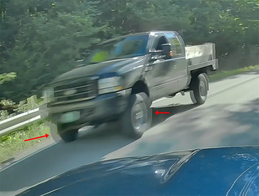

Unfortunately, there is a flaw in the way HDR was implemented on the SoC on the V3 that causes a serious issue during daylight video capture. HDR works by using the 60 fps capability of the camera to capture two 30 fps images simultaneously, with one image optimized for the shadows and the other optimized for the bright highlights and then superimposing them together as a single frame (as you mentioned). On the A119 V3 these images end up as an out of registration double exposure rather than a single image in each frame and this causes a kind of "ghosting" effect. The images appear to be captured consecutively rather than simultaneously. This same effect happens to facilitate the ability to capture license plates at night if the numbers and letters are large enough and the plates are reflective enough.
Here is a screenshot I posted a couple of years ago that demonstrates what I'm talking about. Notice that the hood (bonnet) of my truck does not suffer from the effect because as far as the camera is concerned it is not moving. Still, the dynamic range of the image is well controlled for highlights and shadows, so HDR is actually doing what it is supposed to do even with the flaw.

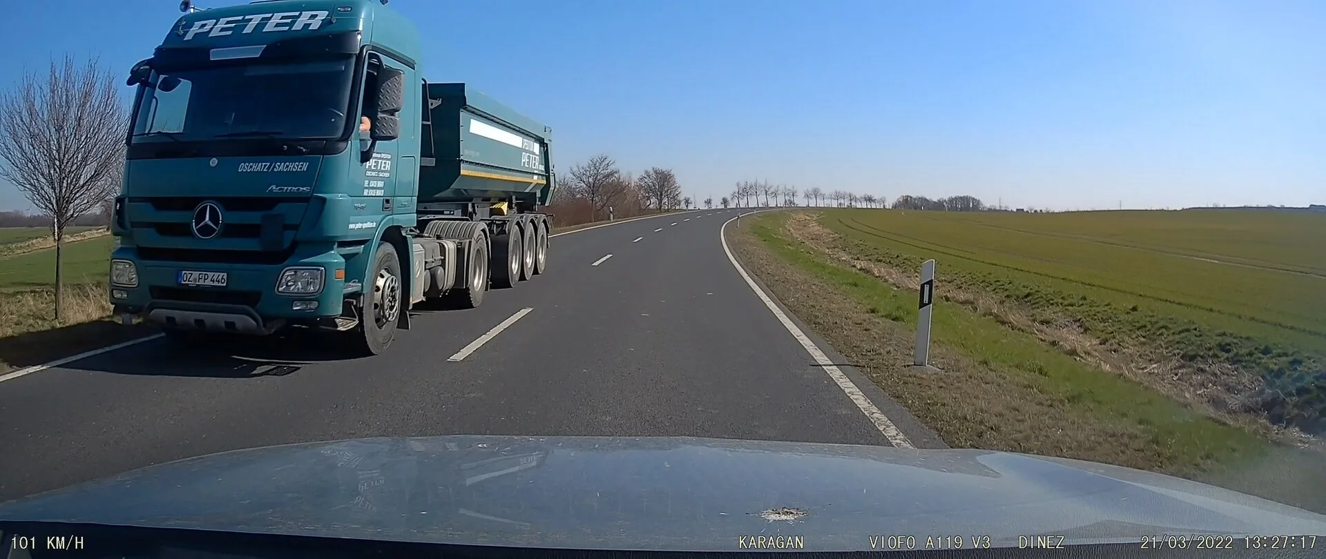

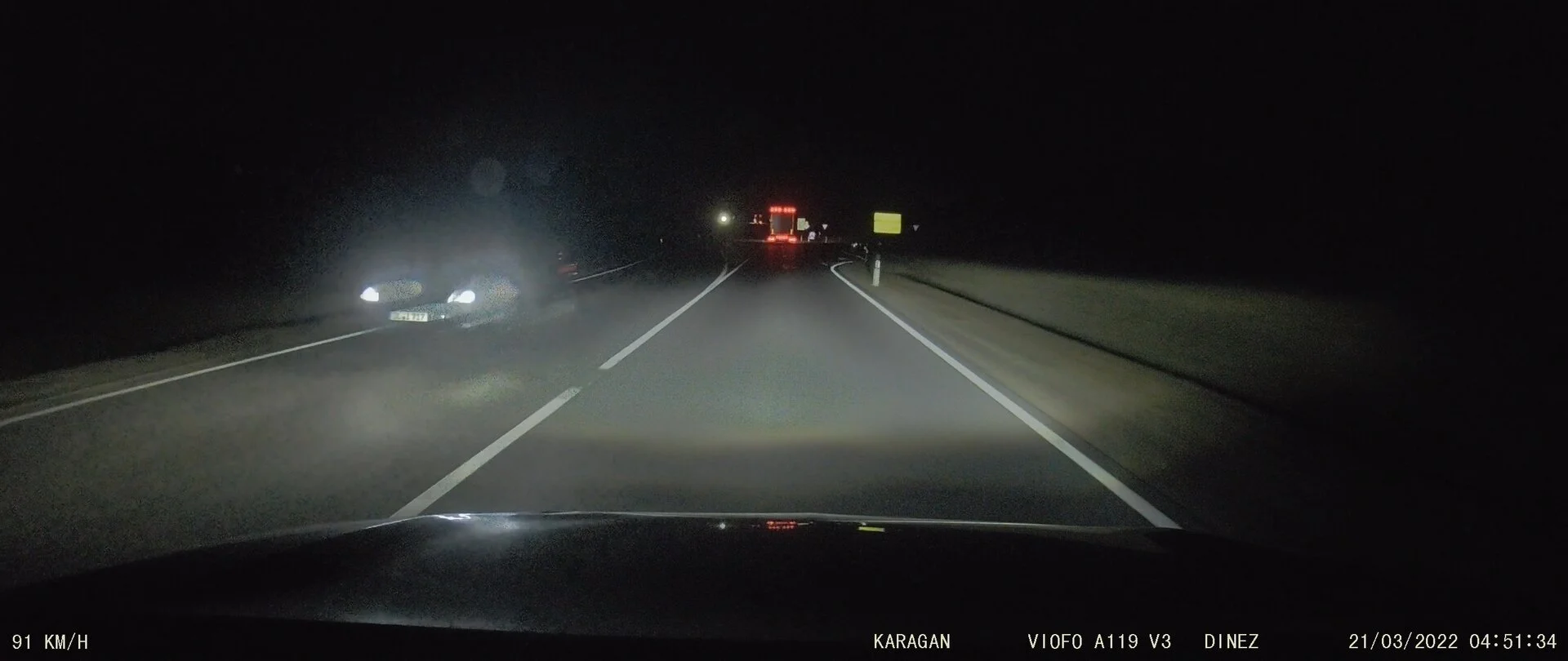

V2.6T_(20211203)_HDR_Auto
2560x1080
High bitrate
HDR_Auto (Day=Off, Night=On)
EV=-1,3
30fps

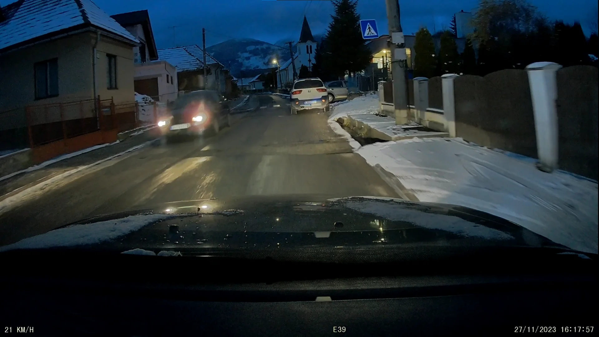

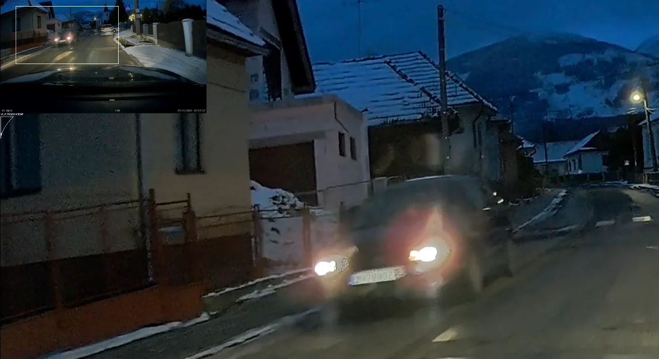

I don't understand how can you read licence plate in such speed. Here is how it looks on my camera if I go 20 km/h and opposing car maybe 30 km/h - it looks worse than your screenshot at 100 and it was not even that dark. HDR clearly worked, as the plate is somehow readable, but still, if I go more that 50 I have no chance to read any plate at night.
I am using newest software and my exposure was at 0, but apart from that my settings are the same. I just don't get it, do you think it makes sense to try 2.6T? Or maybe even 1.3 and no HDR?

I've frequently found the same
No matter which firmware and which settings I just can't reproduce some of the screenshots posted here
