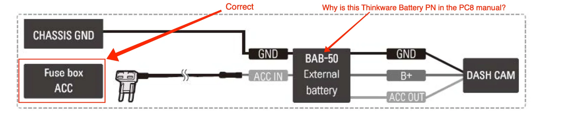

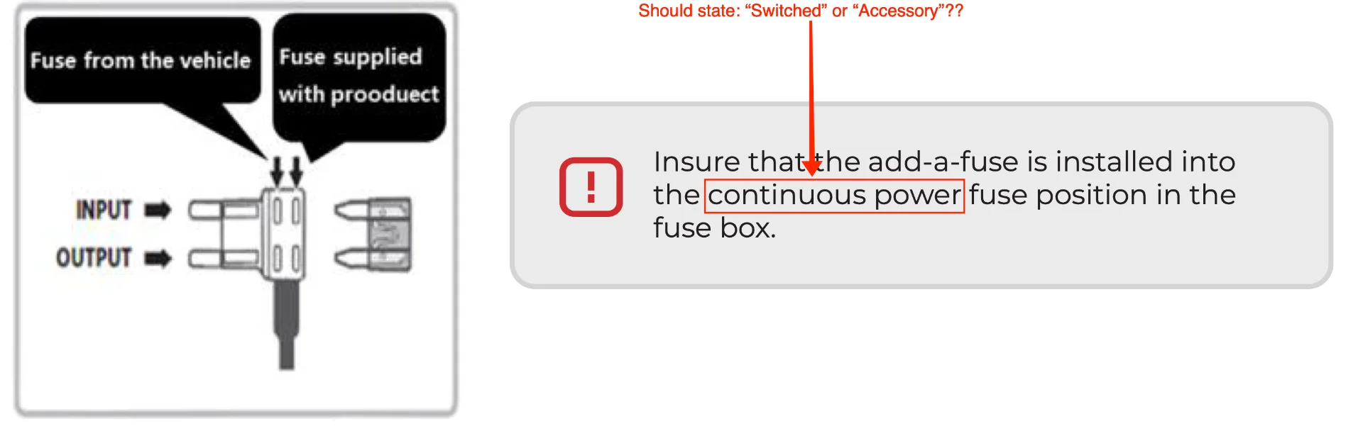

There appears to be a mistake (or two) in the installation manual for the Powercell 8.
1. Why does it state to feed the PC8 with continuous power? A second diagram in the manual looks to be correct.
2. Why is the Thinkware Battery pack PN in the PC8 Manual?

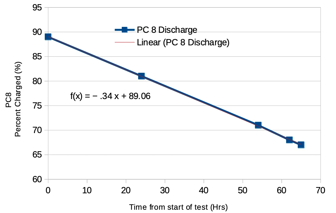

I completely disconnected the HK4 and camera from the PC8 yesterday and it still dropped by about 8% in 24 hrs. My alternator is working harder just to charge the unloaded PC8. This is disappointing for such an expensive battery which is only 5 months old.
Below is my sorry discharge curve after 65 hours of testing (A229 Pro Camera OFF, 2 CH Rear, HK4 Cable)

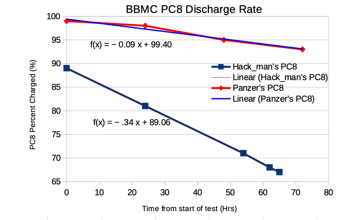

I plotted the two curves for comparison
Panzer's PC8 is discharging at 0.09% per Hr
Hack_man's PC8 is discharging at 0.34% per Hr
It might be interesting to plot some voltages, just to see if the charge % is following the voltage. It is possible that the voltage curves for yours and PP's match and it is just the % that doesn't. Probably the voltage is dropping fast too, but if not then you have found where the problem is.
Unfortunately I don't have Panzer's superior data collecting skills, so I did not record the PC8 output voltage 🙁
How old is your PC8?
The difference is huge.
Are the both test setup identical, i.e. dash cam and HK4 disconnected, WiFi and Bluetooth enabled, not sure what else is there ?
My PC8 is 6 months old.
Both setups had the A229 Pro powered off but connected by HK4 cable to PC8.
One difference is Panzer disabled bluetooth on his phone, I did not but don't think this would matter assuming my phone was out of range which it was. My WIFI was OFF and Panzer did not mention WIFI in his test setup.
I contacted BBMC and they requested I power off the PC8 and determine how much it discharges in a week. They are suggesting the Bluetooth and BMS are causing the discharge, which may be true, but #1 the discharge rate is much worse than it was 3 weeks ago and #2 the discharge rate I experienced in the past was very similar to what Panzer published (I don't have hard data but I was mentally keeping track). In other words, the discharge performance of my battery has clearly degraded recently.
I did not want to wait a week to complete the test BBMC recommended so I cut it short and will share the results soon.
6 months is a relatively new, so there is definitely something wrong with your PC8, I think it is better to replace it under warranty.
