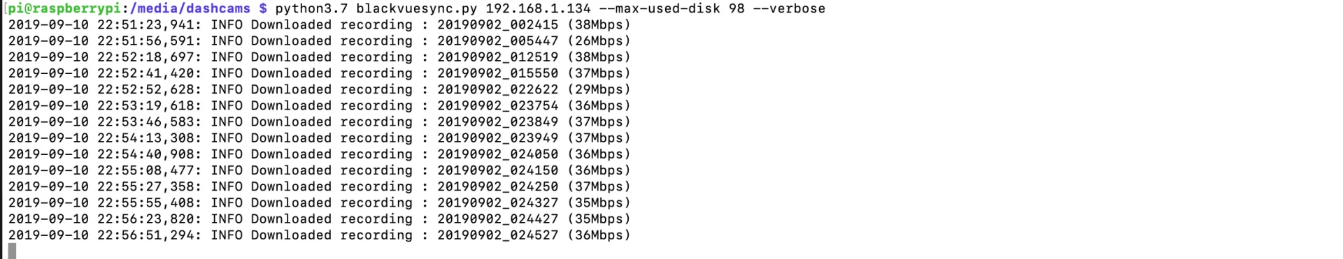

Managed to get it running tonight and getting 35Mbps or so; it was 49Mbps on my Mac so not that shabby really. Raspberry Pi CPU is running at around 49%. Think its a raspberry pi 2.
