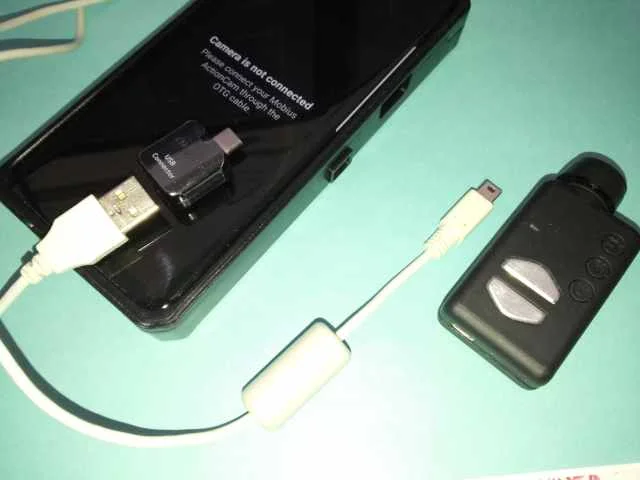

As far as viewing Mobius on my phone. This setup is not working.
Or maybe it's the app. But the app does not recognize the camera.
Mobius > OTG Cable > USB to C adapter > S9+

Unfortunately not all USB OTG cables are the same, and not all phones behave the same. I have tried three different USB C OTG cables for my Pixel phone but none of them work with a Mobius. I kept my old Samsung just to use with the mobius app.
If you just want to review the video quickly you can pop the card out and put it in one of these, which are small enough to fit in any travel bag.

That's a good option. Not for focusing, but to save my as.
So... I'm looking for a Micro USB to C adaptors. That'll work with the S9. The C port will read the card. Thanks.
