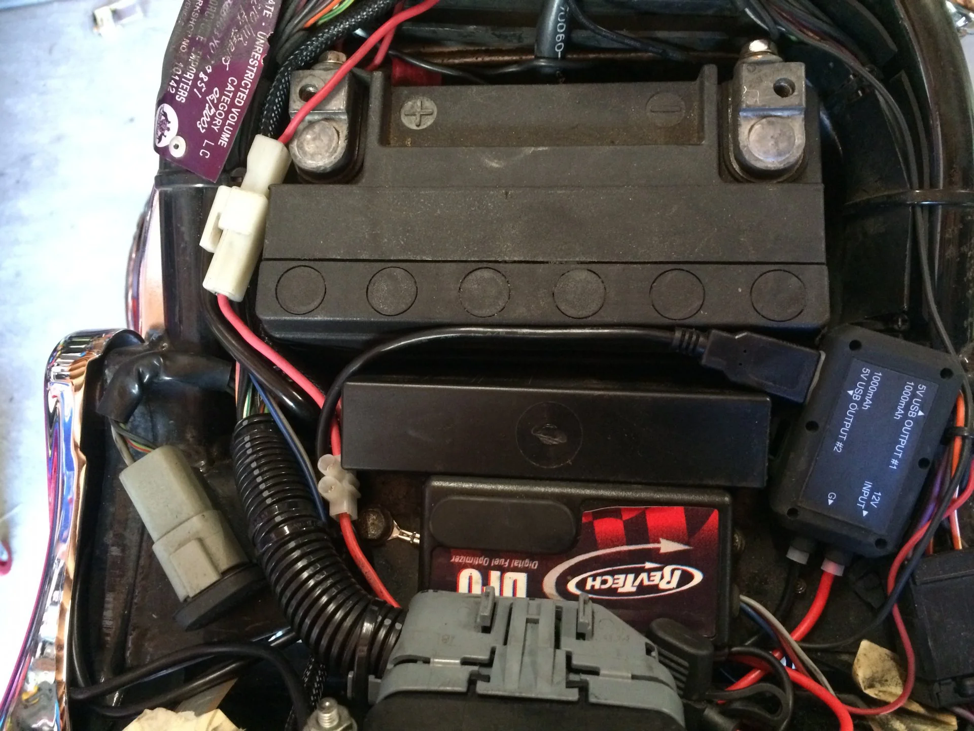

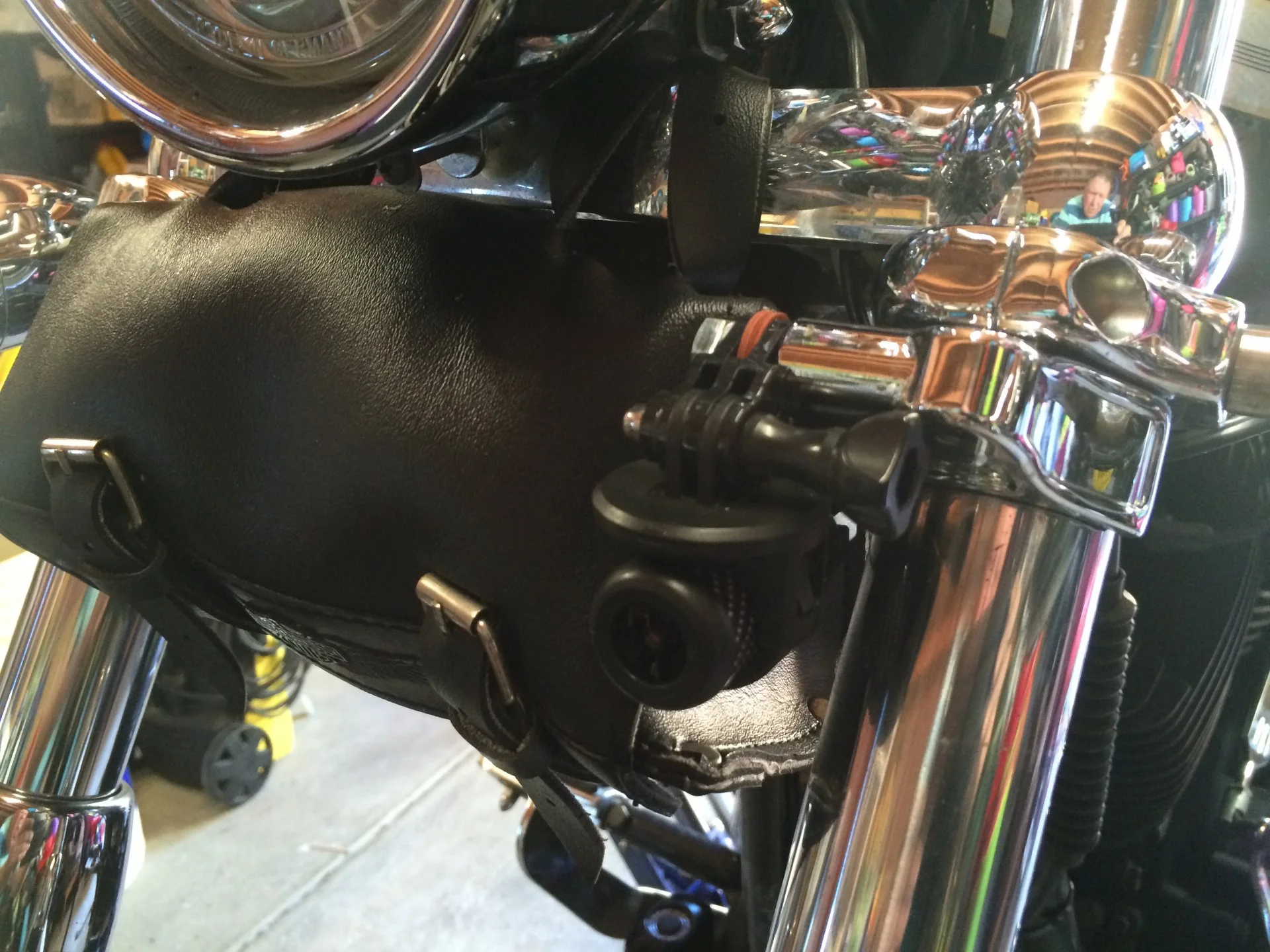

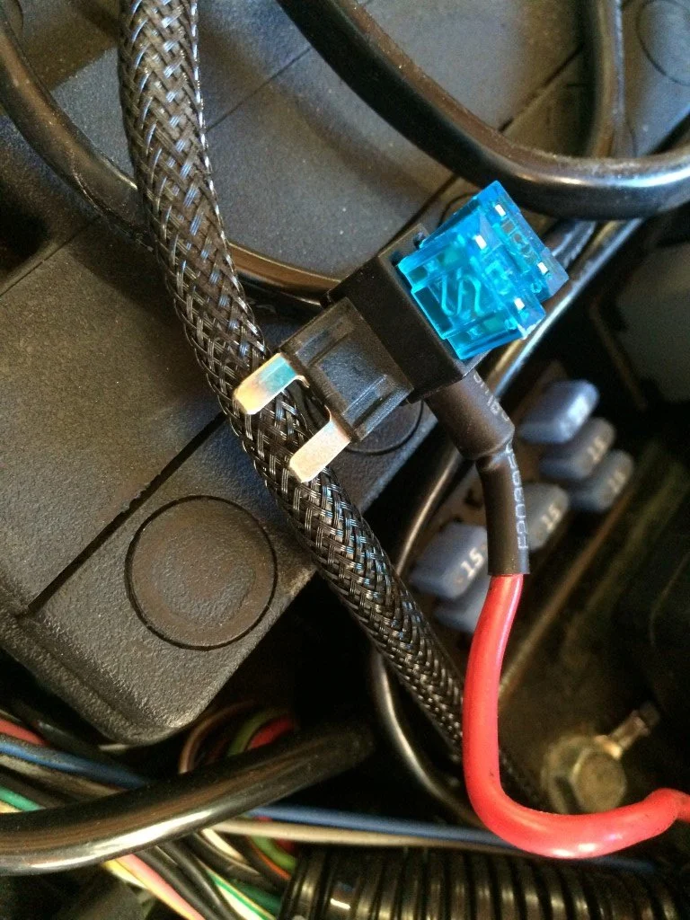

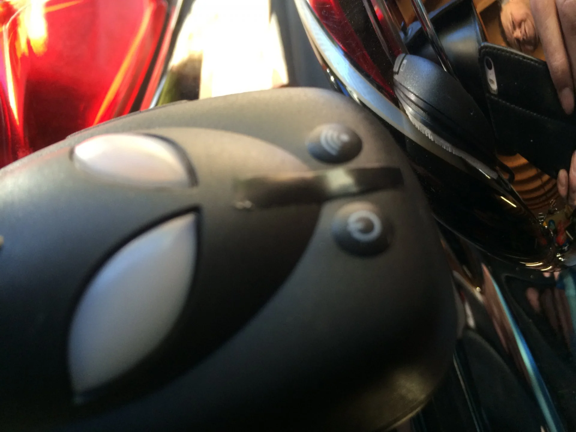

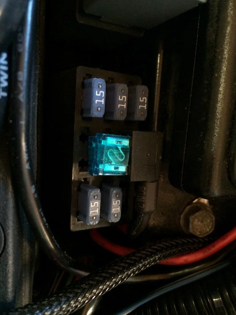

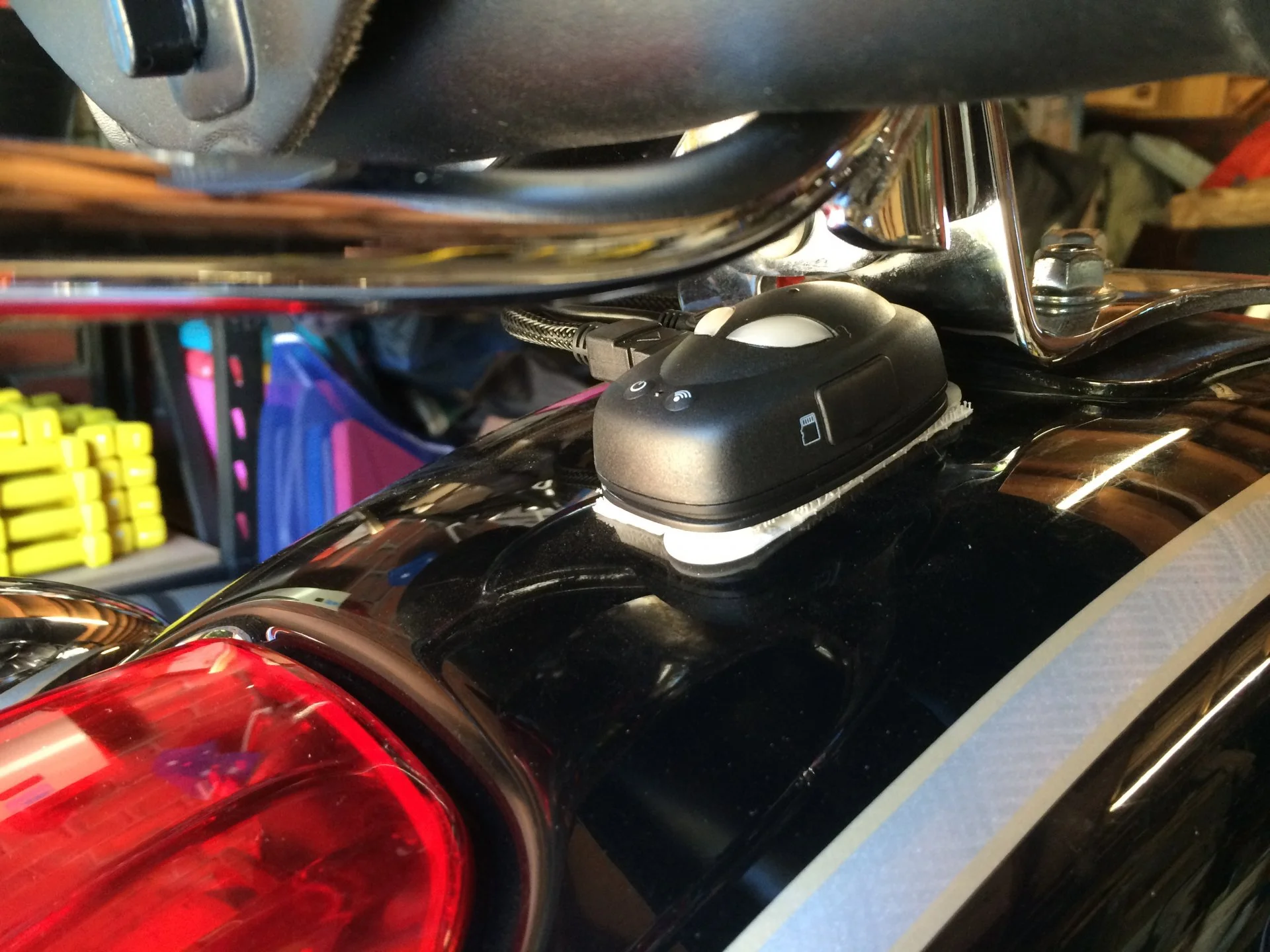

Hi folks. Did a little cleaning up under the seat of the Harley soft tail this morning.
Took some pics which may assist others looking for installation solutions.
Currently mounted camera discretely on bracket on forks near tool bag, Recorder on Velcro strips under carrier on back mudguard until issues resolved then hopefully full time under seat.
Used a little fuse splitter from jaycar to patch off my power from the fuse box without having to cut into power wires.
Umbilical cable running under tank. Going to use the camera this weekend and see if there is an improvement. Also put a tiny piece of tape over microphone so still get sound but not wind noise. Going to check that out as well. Regards IMG_2545.JPG IMG_2546.JPG IMG_2547.JPG IMG_2548.JPG IMG_2543 (Medium).JPG IMG_2544 (Medium).JPG
