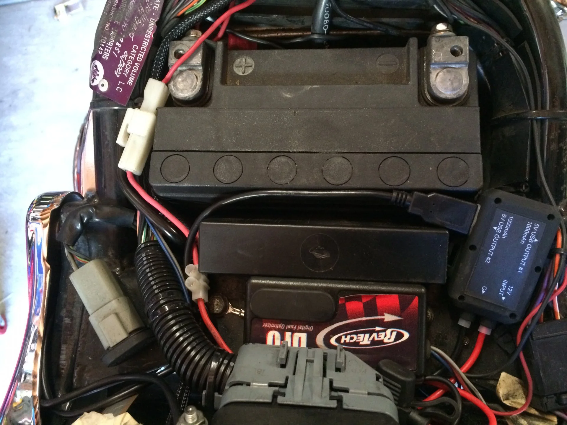

In meantime, I got hold of a small 2200mah phone recharger battery which I plumbed into the existing wiring. HDBiker pro USB charges charger, Charger powers the recorder. I turn the unit on and off at the recorder manually now. Had no problems over a few of an hour or two duration rides. No lock ups at all. I've included pics of the setup. Charger fits into indent in battery.

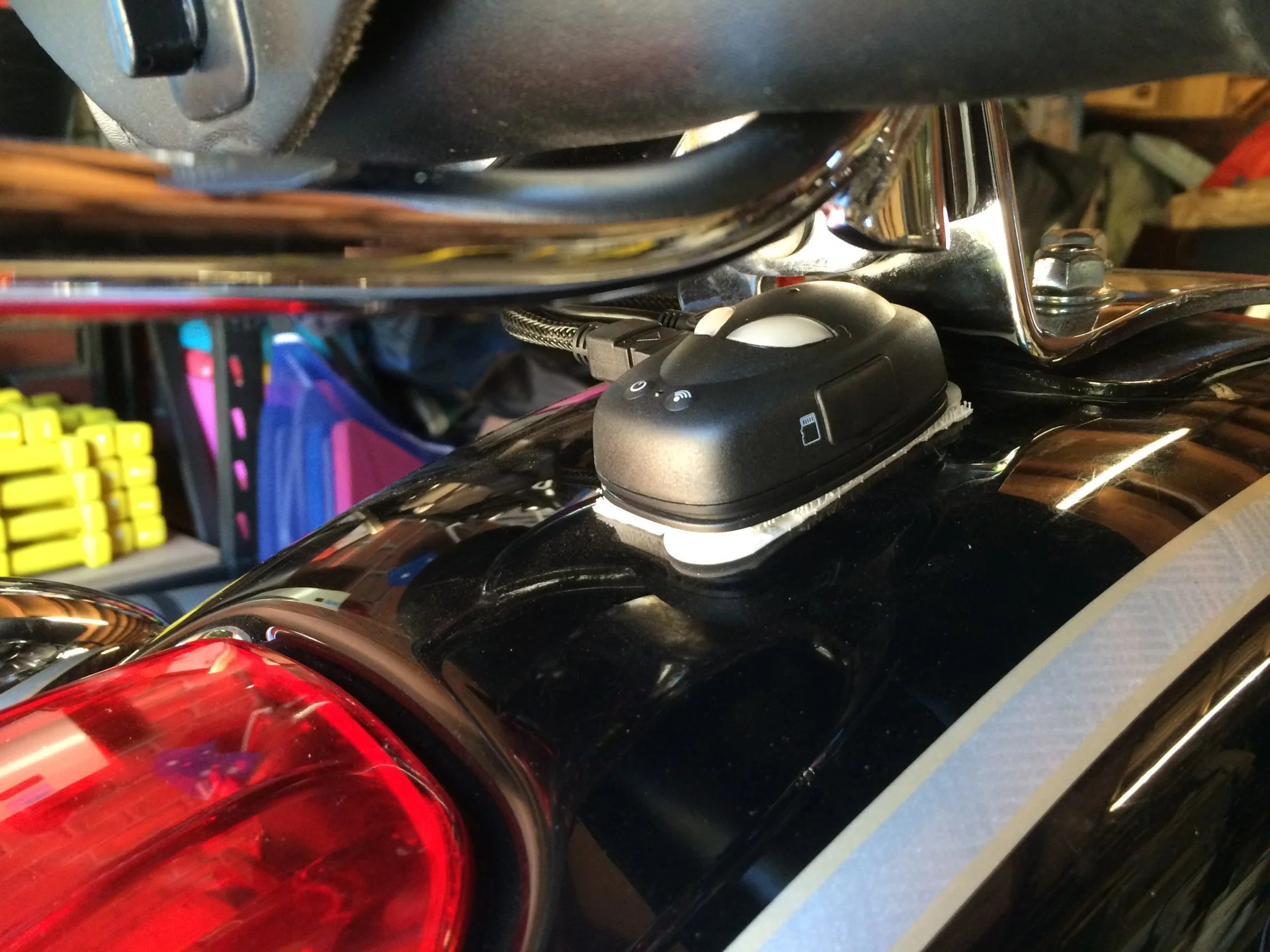

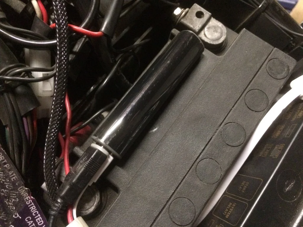

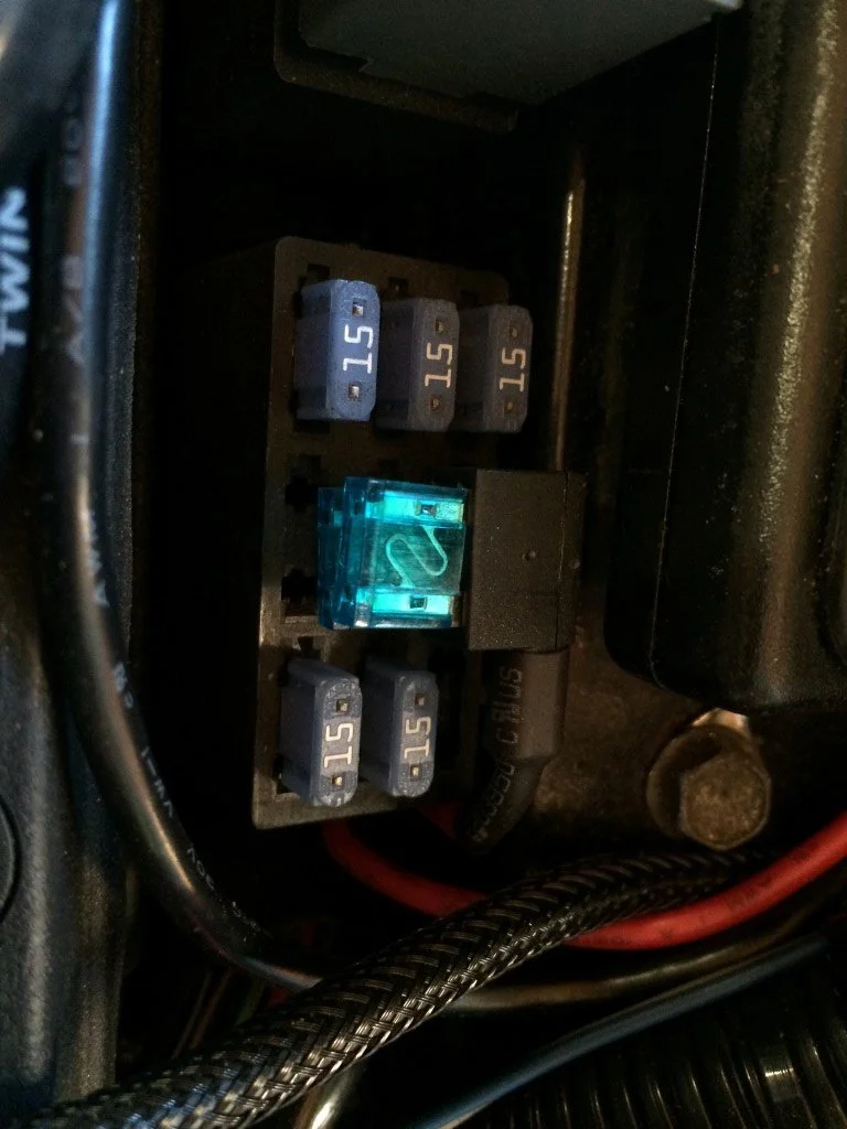

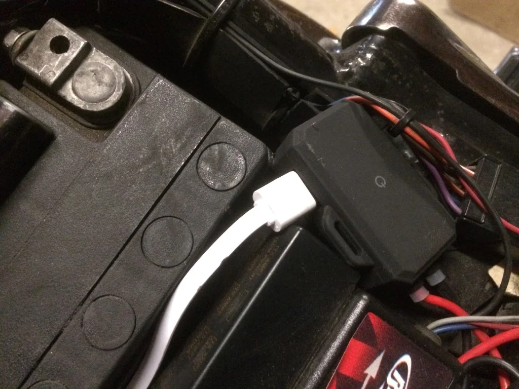

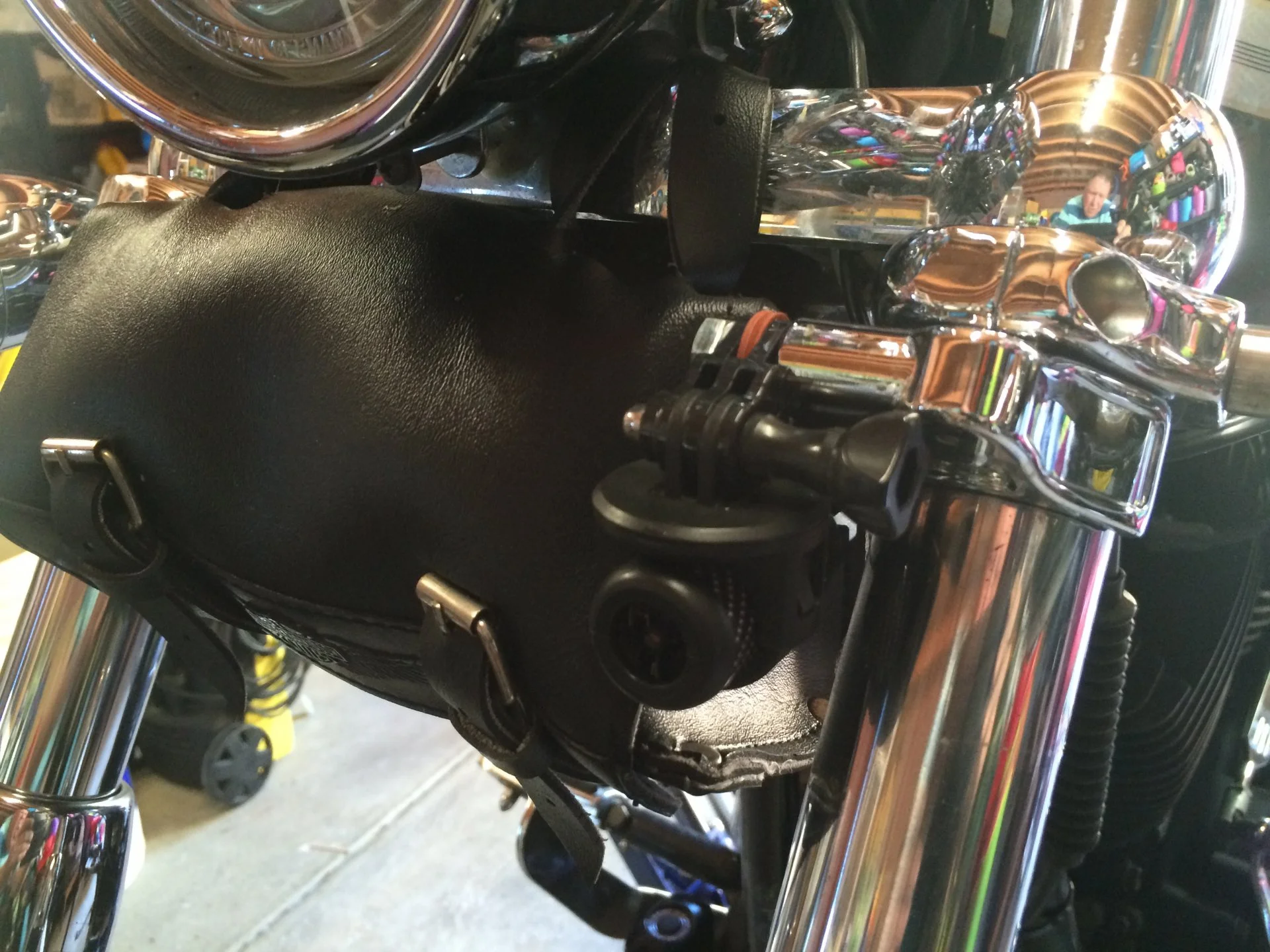

Hi folks. Did a little cleaning up under the seat of the Harley soft tail this morning.
Took some pics which may assist others looking for installation solutions.
Currently mounted camera discretely on bracket on forks near tool bag, Recorder on Velcro strips under carrier on back mudguard until issues resolved then hopefully full time under seat.

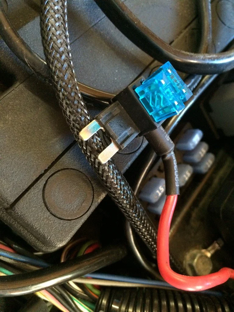

Used a little fuse splitter from jaycar to patch off my power from the fuse box without having to cut into power wires.

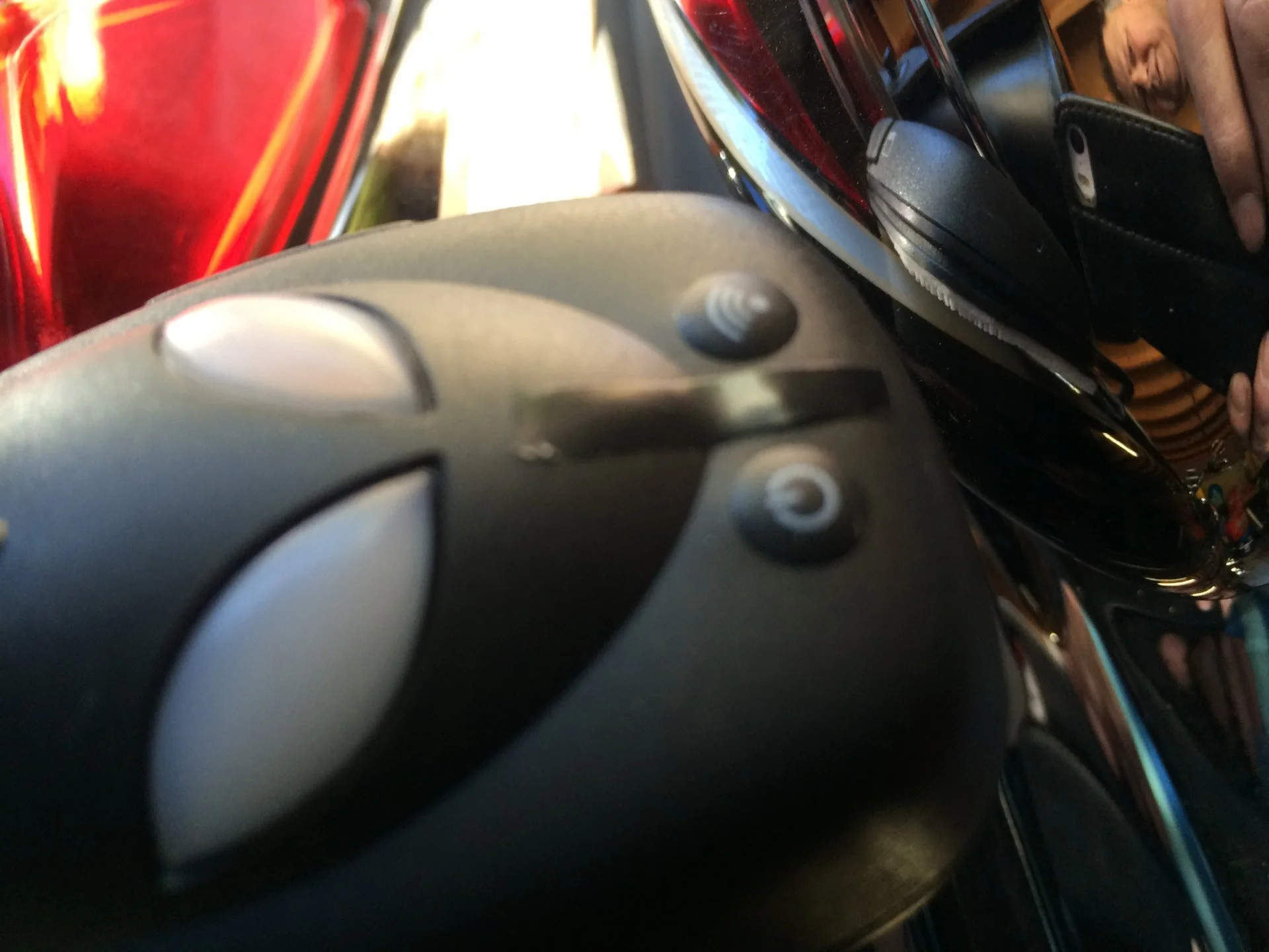

Umbilical cable running under tank. Going to use the camera this weekend and see if there is an improvement. Also put a tiny piece of tape over microphone so still get sound but not wind noise. Going to check that out as well. Regards View attachment 21728 View attachment 21729 View attachment 21730 View attachment 21731 View attachment 21732 View attachment 21733

sorry its taken me some time to respond. The fuse jumper units which have the thinner slightly pointed prongs / teeth are for motorbikes. The ones with the larger square prongs are for cars. Jaycar only had bike ones when I looked. Get a spare 15amp fuse (or the same size as the one you are jumping
