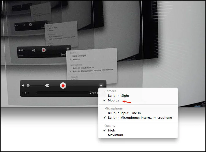

Are you using Quicktime Player for webcam mode with the Mobius on your Macbook?
I tried QT player & photo booth, both don't work. I'm on El Capitan 10.11
For some reason, I've never ever had any luck getting a Mobius to mount as a web cam in Photo Booth (although the software can see the camera) but I never have any problem mounting a Mobius as a web cam in Quicktime Player.
I'll assume you know the proper technique for using the Mobius as a web cam in QuickTime Player. Maybe it is yet another thing broken by El Capitan which I have avoided so far after hearing so many issues and complaints.
Mobius mounted into QuickTime Player:
I tried what you have in the screenshot.
If I select H264 in the mobius, QT freezes when I pick the Mobius as source.
If I select MJPEG in the mobius, QT doesn't have Mobius as option in the source.
I believe El Capitan broke it but it wasn't working for me in Yosemite either.
Sounds like yet another El Capitan bummer.

BTW, one thing you might try for re-focusing your Mobius is to use the AV cable and plug the camera into an HDTV. Not the best of all possible worlds, but it works.
This is a good idea. I'm going to try this.
