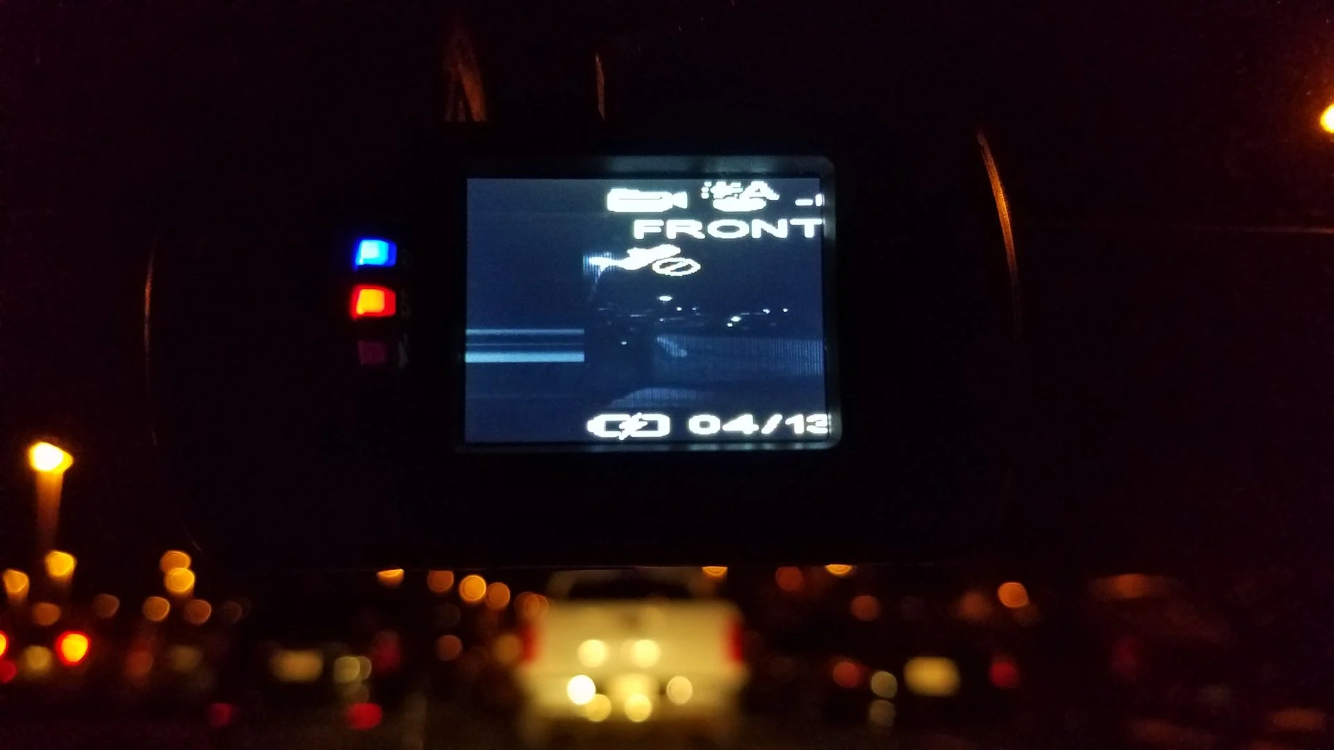

Yes!! I did notice the same result a few weeks ago, in my case when I was connecting the rear camera the screen split in a weird way
and the recording always came up corrupted.
(also reset when it was hot and left in car) when my second camera doesn't behave like this one at all.
I did update the camera with the last "update" and so far it's been working fine but that really defeat the purpose of having a dual camera! I did try to contact the seller and never had an answer!
P.s. so far stop resetting but when I connect rear camera still get corrupted screen image, recording and it reset.
