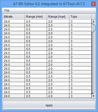

Right then, I've just done another two custom G90 firmwares using @Tobi@s' A7Tool based on firmware r441MP.
The first one is ultra HQ and uses the following settings:
![upload_2014-8-19_12-12-57.png upload_2014-8-19_12-12-57.png](https://dashcamtalk.com/forum/data/attachments/7/7159-6240ee59d8375ea959559f40ffe1bc17.jpg?hash=YkDuWdg3Xq)
So basically we're looking at a minimum of 12Mbps and a max of up to 48Mbps - this is VBR and it will adjust accordingly as required so hopefully no data will be lost like I showed in the comparison yesterday. In my initial testing it seems to run as CBR 48Mbps though.
In all fairness a CBR 18Mbps should be enough but there's nothing wrong with tweaking and covering your bum to try and ensure the MPEG compression doesn't go and lose something you really need (ie a numberplate).
Please note this means the potential for huge filesizes (~800MB per 3 mins) and extra heat as the A7 chip will be working harder so your milage may vary when using this in hot climates. It's a good way of testing the camera is stable though as if it doesn't fail with this then it's going to be stable with lower bitrates![Smile :) :)](https://cdn.jsdelivr.net/joypixels/assets/8.0/png/unicode/64/1f642.png)
The 18Mbps firmware offers slightly better quality than standard in my experience which tends to run around the 15Mbps mark.
To install, copy the relevant file below to the root of your memory card and connect the camera to a power source (not a PC) and upgrade when prompted.
https://mega.co.nz/#!Qc8XRKpL!DxGNTWYKVE6JnpdaGqBK5tRVjbUcusKUy9x3QxnLaRc
For those who don't want the crazy file sizes of the above firmware then you can use the 18Mbps version here:
https://mega.co.nz/#!FM9x0RQQ!voeMcMaBeL6AIgHES6bmDVT5Msj5bjmdbbPmTyOXNic
And then finally a totally different spin - a firmware which reduces the bitrate of most steppings by 6Mbps - this means potentially reduced quality but you'll fit more onto the memory card, and some of the settings are still 12Mbps (same as the Panorama) with this one:
https://mega.co.nz/#!UZVihKxa!XwGZv_CDTGWBdq7L32fIvmWvKhSZVEy2lmjnYAEmJXI
