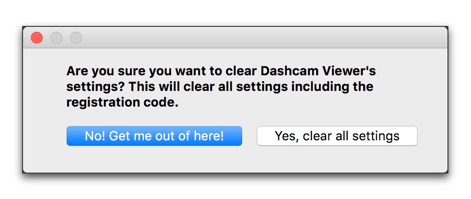

what's the process again to reload defaults when launching the program?
Run Dashcam Viewer with the Shift-key held down. You will be presented with the nuclear option:
Clicking ‘Yes’ will erase all the stored settings, such as window positions, window sizes, button settings, map settings, and preferences. These settings will revert to defaults. Also note that your registration code will need to be re-entered if you select this option.
