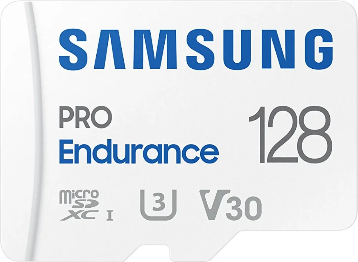

I don't yet know if it is the card, but this is the card I was using when the problem occurred. H2testW completed with no errors.

EDIT: I ran this test several times. Reading speeds were always around 87-88 MB/s, writing speeds around 60 MB/s. A 64gb Pro Endurance (also blue and white) tested at about 88 MB/s reading speed, but writing speed was only in the 10 MB/s range. I don't know why the two would be so different.
