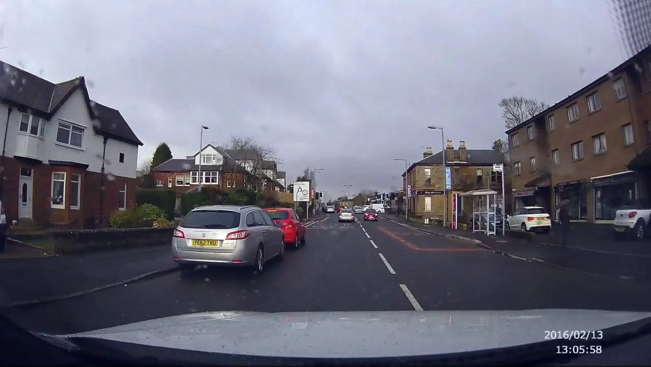

Here's a screen cap and somes clips from the ION camera I've temporarily replaced my 0826 with. Not bad really, although not as feature rich and still unable to extract the GPS data from the mov files. Does anyone know how?

Turns out it's embedded in the mov files, which I think quite a few dash cams do. I've tried all the usual players and none of them will read the GPS data. There is one which seems to be able to but not in Super HD resolution, only 1080p.
Registration Viewer has always been my favourite but it requires separate GPS files. Kinomap will read the GPS data but sod having to upload to it and I'll also have to change my rewrites to 1 min as 5 min is too big a file to upload efficiently, in fact even a 1 min file is big for uploading. If I chop the mov file it seems to lose it's GPS data on the re-export. Either way, far too much hassle. But, not really all that important for private use, so long as I have the video footage. Don't really want my speed to be shown! lol

Tried the subtitles things and all sorts of other methods. Also came across some computer uni guy was trying to code a problem to extract the gps data but gave up. The ION is fine for me and my car but for the HGVs I need to see the speed and GPS mapping without any hassle.
