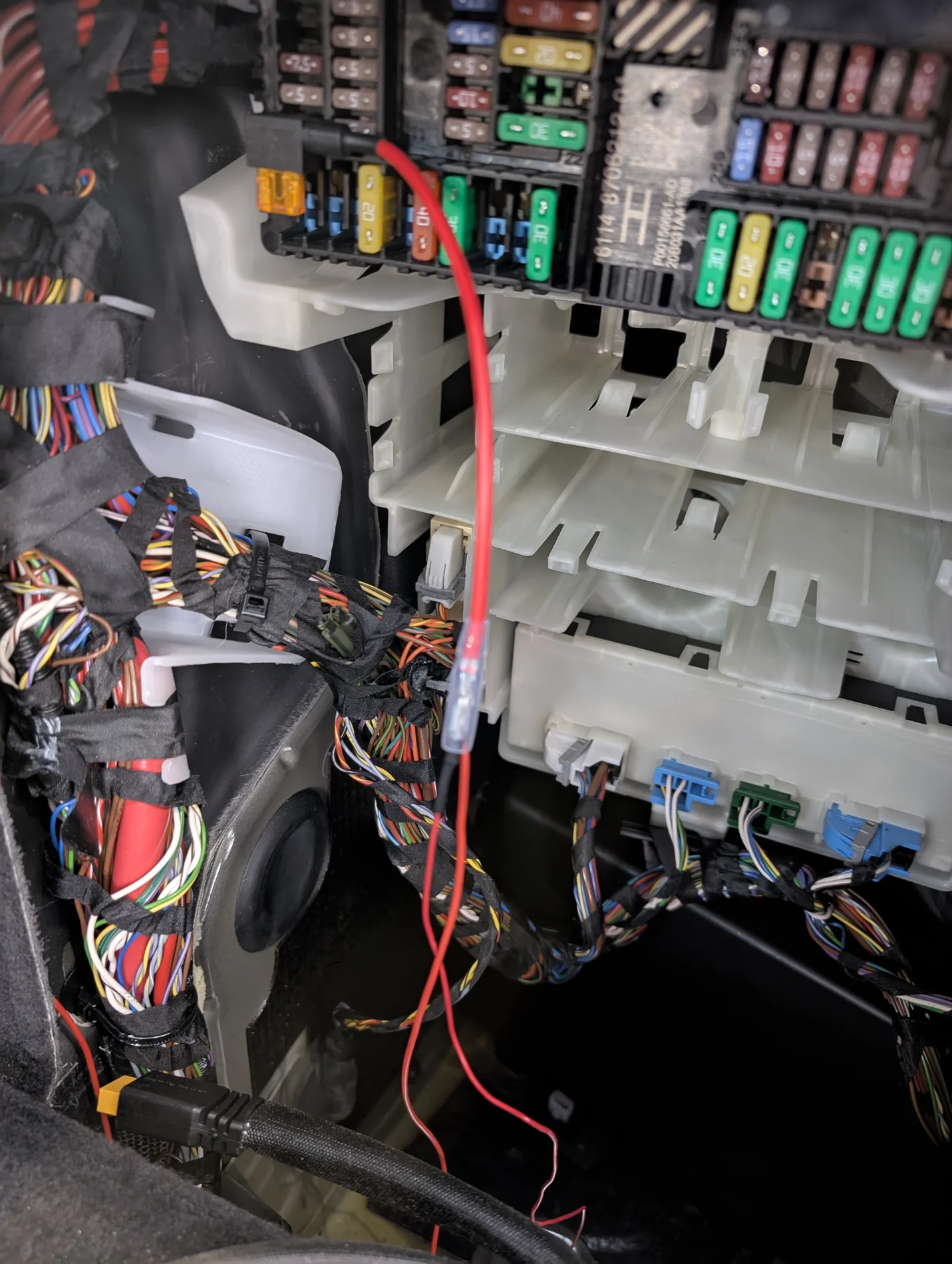

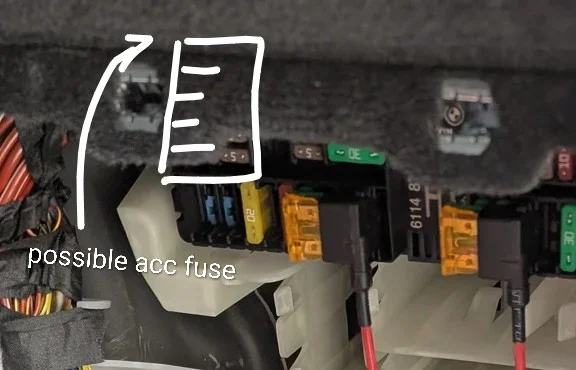

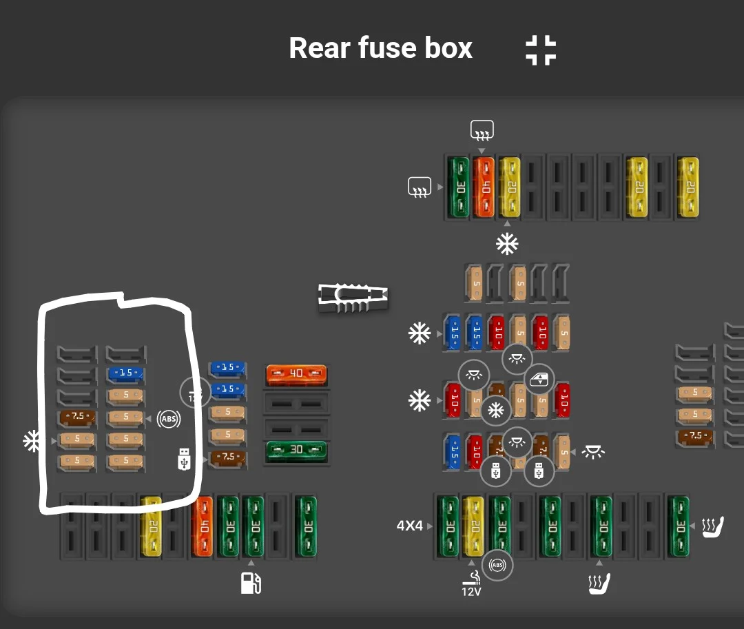

Wow that's perfect, thank you both champs. My BMW feel like it keeps all the trunk fuses active for like 5mins, unfortunately. I could search for other fuse boxes though maybe something else loses power instantly.
I've worked on a few BMWs and so far I've been able to find a trunk fuse slot that would immediately turn off with the ignition and was also a spare(no fuse but had contacts). I've included a few images below to use as reference for the specific fuse slot I've used before on a BMW X3 and one that could work for yours.
I've worked on a few BMWs and so far I've been able to find a trunk fuse slot that would immediately turn off with the ignition and was also a spare(no fuse but had contacts). I've included a few images below to use as reference for the specific fuse slot I've used before on a BMW X3 and one that could work for yours. View attachment 90056View attachment 90057View attachment 90058

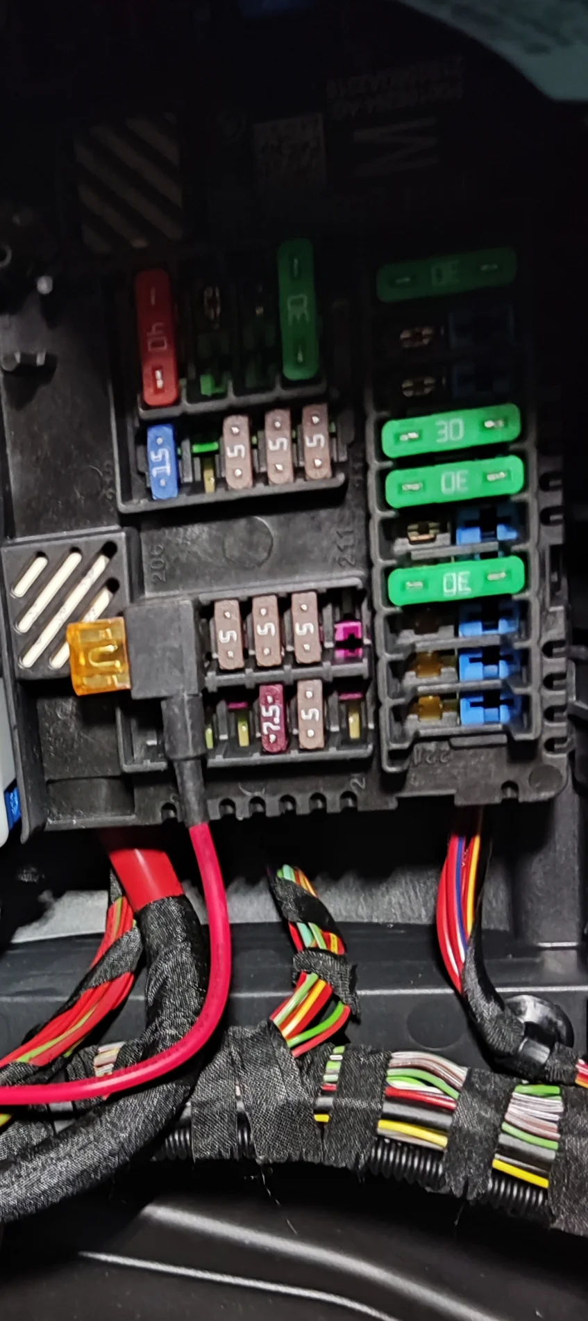

Thank you all, your comment combined with some googling helped me find an instant off, fuse 205 the left bottommost 5 amp where you circled. And bonus it's unused (what's it say that fuse does on your map?)
Anyway thanks again all I'll be back in a couple days once I attempt this install, just gotta wait on a couple more parts to come in but everything seems ready.
@EricSan @GPak So I started the install this weekend in the BMW and now it's time for the troubleshooting lol.
The good news is that the car battery is charging the River 2 and it seems to be working flawlessly. Starts charging after about 10s and nothing seems to be getting hot so that's a huge win, that was the part I was most scared of. Problem I'm seeing today is the dashcam isn't powering on at all. It works testing with a cig lighter adapter just not with my wiring that I did.
My thought is that I used too small gauge wire coming from the fuse box into the fuse adapter; it's probably around a 10' run to my dashcam and I was using 22awg. Other possibility is bad soldering of joints, either way same solution rewire with better wire.
My test DID use a poor temporary connection that I'm not even 100% was a correct way to connect in the first place, but see below I have the two ACC receivers, the relay and the hardware kit/voltage regulator, pinned together under the fuse tap. Everything else is wired exactly as in the diagram it's just 22awg specifically from the ACC fuse to the relay, and from the ACC fuse/USB to the hardware kit.
