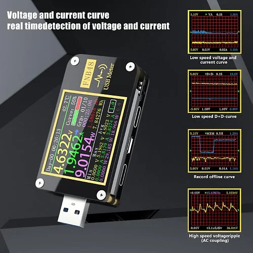

I never get more than 12 hours with my 250 Wh of Powercore. I should use a multimeter to see if my car is sending enough current to it. Or give up this quest.
I don't know how you've got the Powercore wired in or how you are using it but you might consider getting one of these USB inline multi-meters. They will show how much current passed from the battery to your device and record how many hours/days/minutes/seconds the current was flowing, plus a lot of other data. There are many of these on the market at different prices and with different capabilities. These things are pretty handy if you have dash cams and power banks or external battery packs. I have a couple of cheap, basic ones like the Charger Doctor and the Keweisi I paid only a few dollars each for and they do a great job but some of the newer more sophisticated ones that have since become available are very appealing.
Features graphing
Price £23.82 on Amazon UK

I've got one of those power meters. I wonder if it would interfere with the magical parking mode line of the USB cable though?
I also have ordered a multimeter so I can measure how much current is coming from my car to the Powercore when it is charging.
River Max double speed charging looks very promising.
#obsession
That's a good question I hadn't thought about.
It could be that the meter would provide a lot of useful data anyway even if you can't trigger parking mode while using it.
