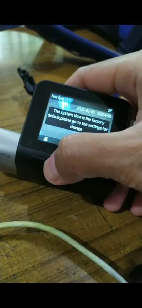

every time I do it is still successful but this time when I insert the memory card and restart the a500s, there is no light, but when I remove the memory card and press the start button, the light comes on again
Help me please !
Do you need international or Chinese firmware?
Try another memory card. Format it in the computer in FAT32.
And connect to a good power source.
Do not connect to the USB of the computer.
Thank you !
I had international firmware.
I usually use 32gb sd card and it works
But this time it doesn't change to english
Do you have email ? I want to send the video to you
Help me. Thank you so much !
I think " Firmware from the archive "FW96580A.bin " doesn't work anymore
watch and help me please !
