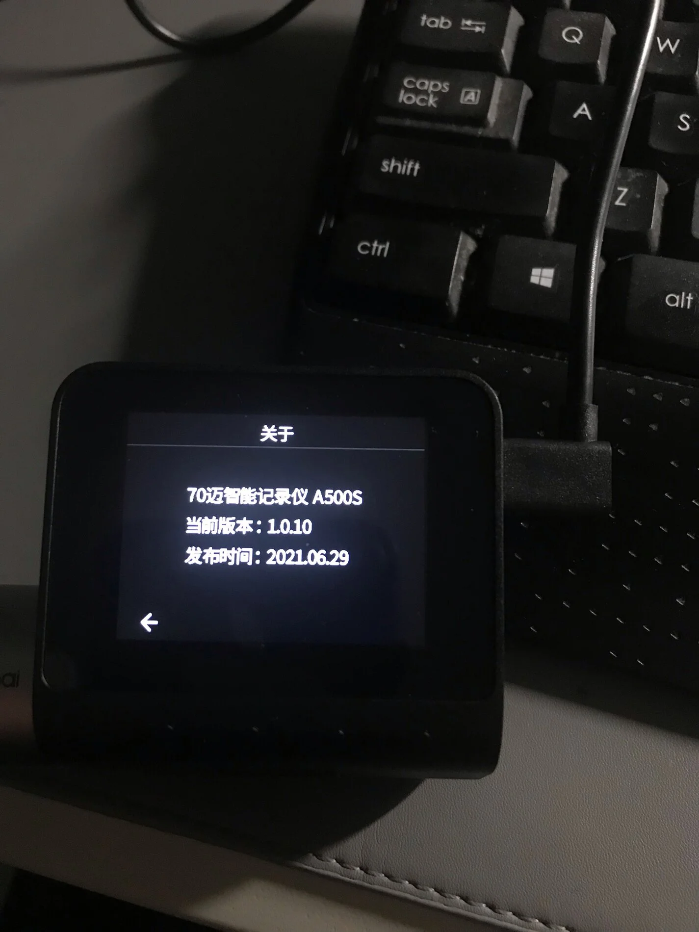

I have the A500S - Chinese Language Version - and I need to change it to - English Language Version.
The Firmware Version currently is - 1.0.10 Dated - 2021.06.29 (Refer to Photo)
I order to update to the English Language Version - which Firmware (Bin File) - should I use.

1. Turn off A500s
2. Remove microSD
3. copy FW96580A.bin at the root microSD
4. Insert microSD to A500s
5. Turn on A500s.
6. Wait...Blue LED flashing... Upgrade comlete.
Good luck!
