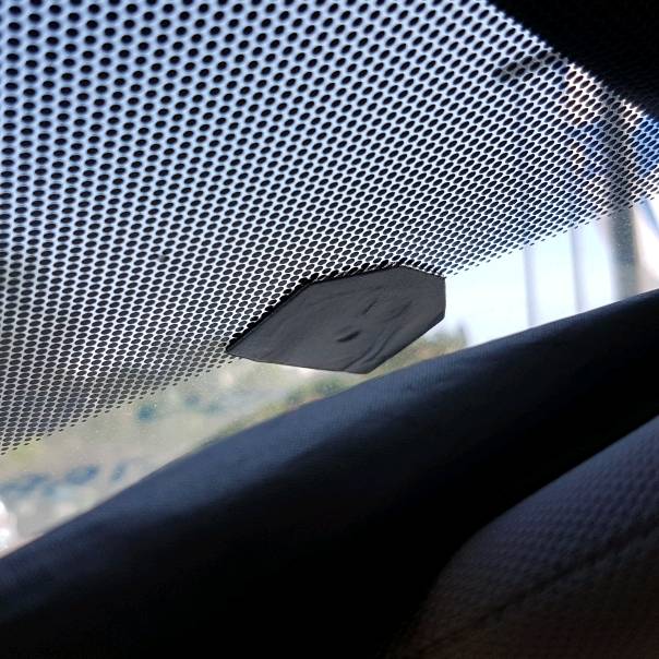

For that reason, I started to follow up this conversation. I didn't check the footage yet, but i found the camera disconnected. The double sided glue didn't survive for the weekend. I will have to use my 3m one. I will also check the image quality.

I have the updated batch of 3M VHB tape and can send you some. (Assuming you bought from Street Guardian USA). I recall shipping a few to Israel recently.
Thanks. I did order from you. Is the tape pre-cut to the shape? Since i only have the retail narrow version. Please send if you can. My order 3755119. Let me know if you need additional info.
Sent from my SM-G930F using Tapatalk
Replacements are on the way you should have received an email just now. Yes it's custom die cut to fit perfectly. Press and hold for two minutes and wait 20 minutes before applying weight. You'll want to clean the surface good before as well

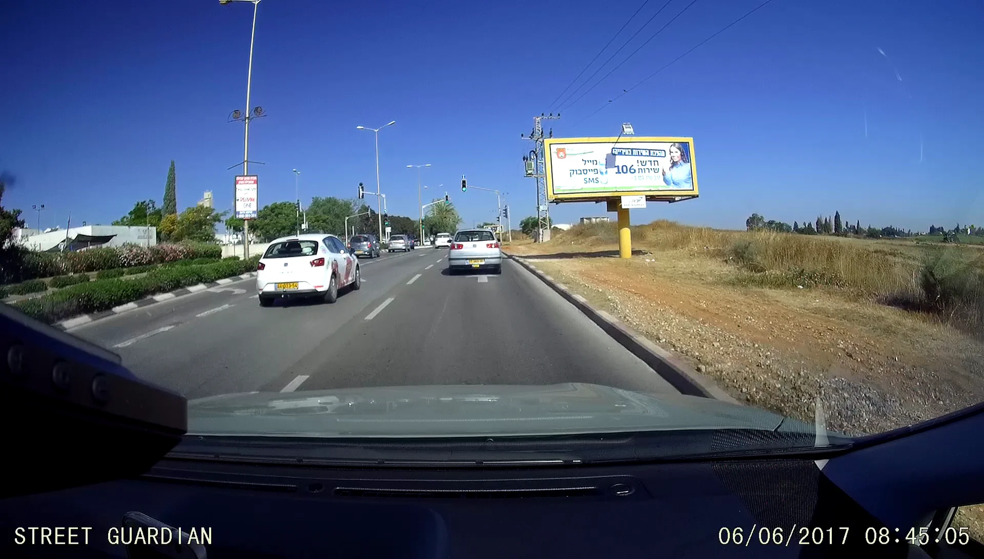

I have another question after a week of use. I needed a video sample of a car in front of me. I took this snapshot via VLC and I see that the dashboard is in focus, but it looks like that the details are missing about the car in front. I understand that the lens is fix-focus one. Is this the quality that I should get or something is wrong in my case?
thanks,
Sasha
Agreed that's a bit far away for details, over all image looks normal.
The Native 1080P 2MP sensor in the GC has larger pixels to capture more light resulting in better night / low light performance.
A 2K sensor dashcam might give a bit more more details further out in the daytime but night / low light performance suffers (smaller pixels)
