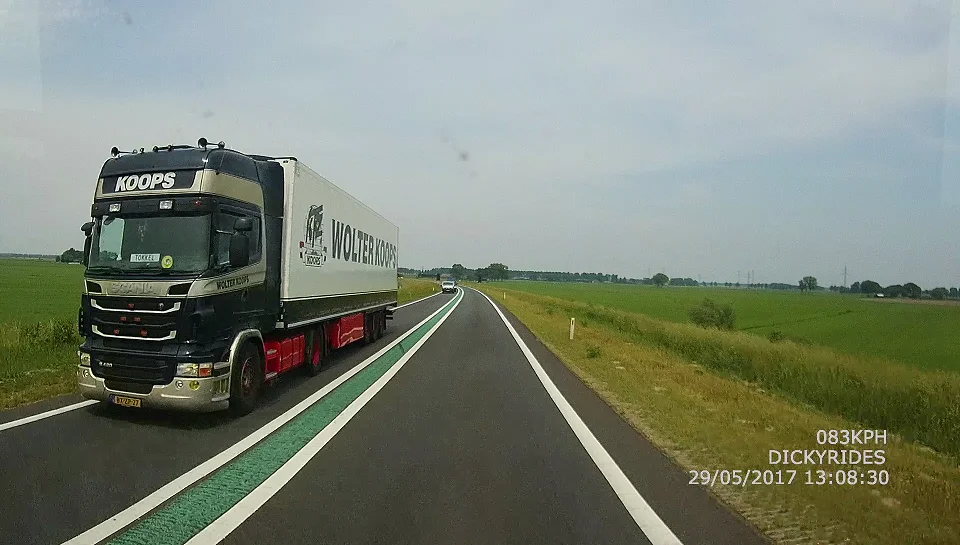

JooVuu X
Mobius (1) with C2 lens without IR filter
L2
L3
Don't touch that dial folks!

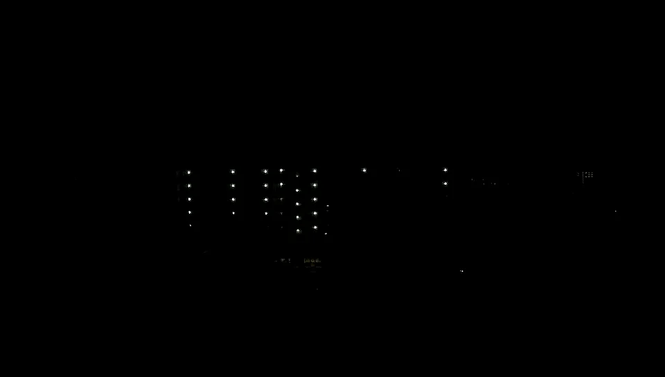

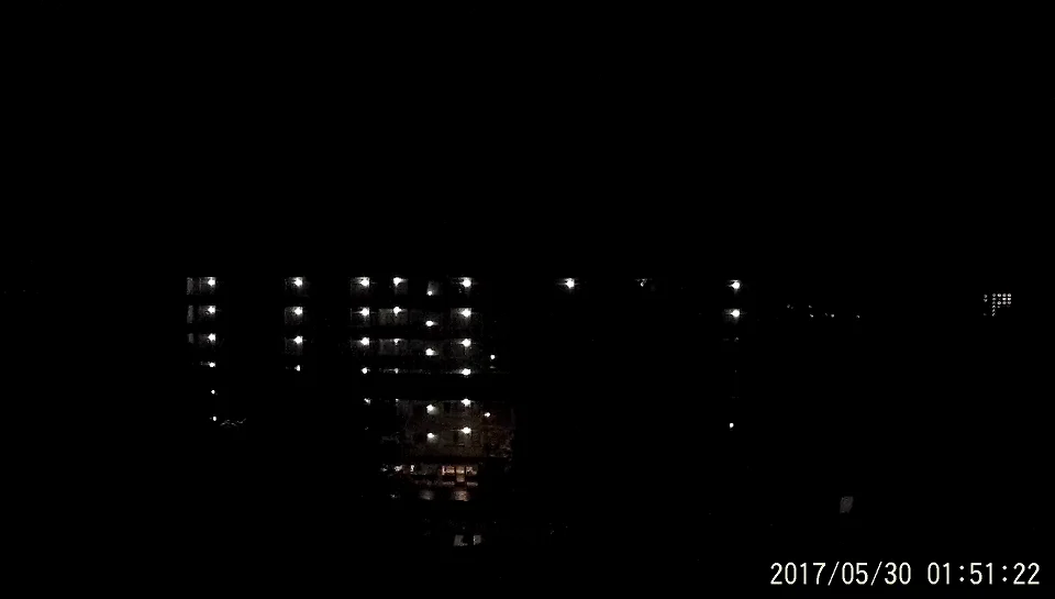

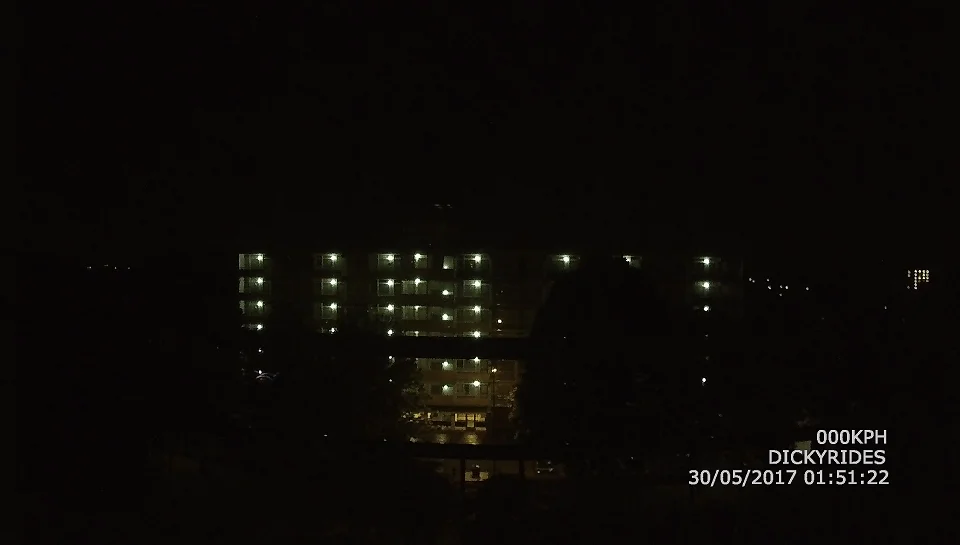

Night shots (taken from video, stationairy from our appartment):
L3 1080P/120 (I tried 60 and 30 as well, 60 same as 120, 30 only slightly brighter)
L2 1080p/60
JooVuu X 1080P/60
As you can see JooVuu ftw, and I can NOT get date/time stamp back in L3 video's...

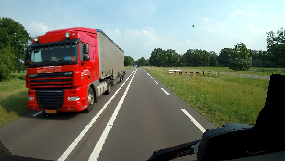

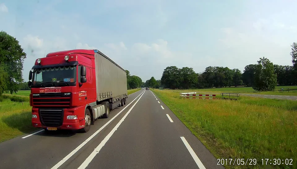

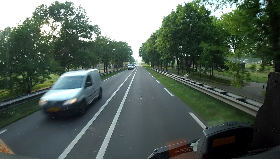

I dont think L3 are OOF, but it use a slower exposure and so things moving have more motion blur.
Perhaps their code miss.
If low light, ramp up ISO before lower exposure.
It seems the left side is out of focus on L3?
It's NOT out of focus, it's definitely motion blur.
I checked, standing still gets sharp image.
I believe Max ISO is 1600 or 3200, I asked but got no answer yet.
In the menu settings we can set maximum ISO to 1600. But, in auto mode the ISO should be 3200, but I have no documentation or proof for it.

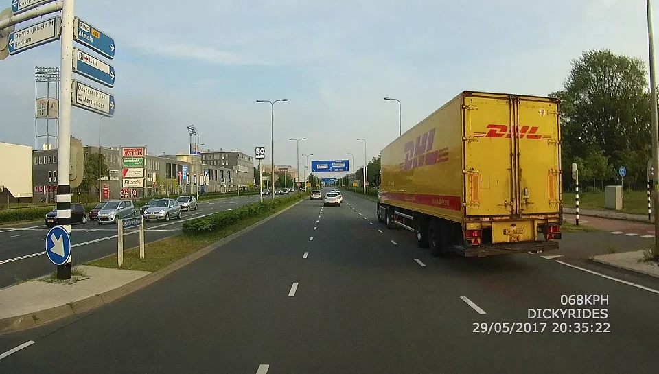

Night ride with the L3:
Just to satisfy you're curiosity, here's the same ride with:
JooVuu X, and Mobius C2 lens (NO IR FILTER) in B/W.
Well, now that I've satisfied my curiousity, I'm selling my L3
It's obviously really more usefull for RC fly recordings.
If you're interested, PM me.
Yeah, still unbeaten for night recordings.....
What'd you think of the B/W....?
