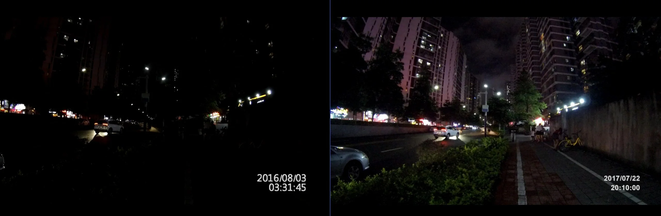

For night recording, maybe worth waiting GitUp F1?
Attached is F1 compare with other Ambarella A12 camera.
Of course, more brighter, more noise.

I thought the split will be the best for low light recording as using 2MP sensor.
I heard they are also working on the IMX117 12MP sensor version.
