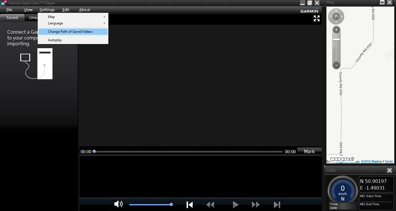

Open "Garmin Dash Cam Player" and check/select path for video files from which to extract GPS points.
Close "Garmin Dash Cam Player".

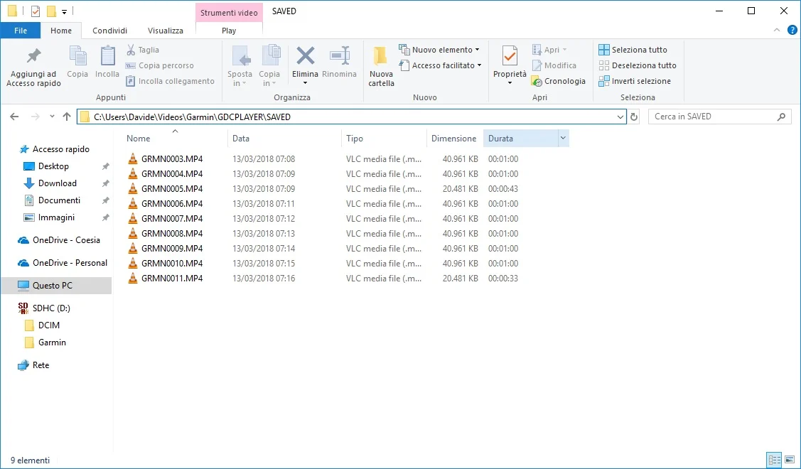

Open the folder and copy the video files in it.

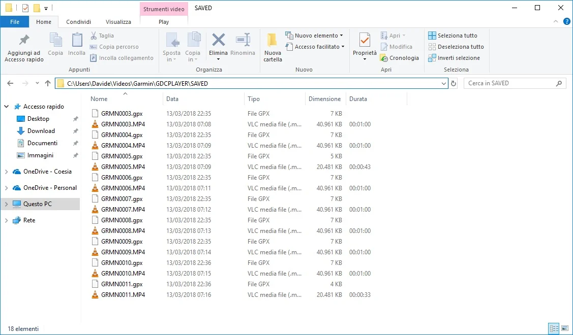

Open again "Garmin Dash Cam Player". It will show video files on the left column. Select one by one and export GPX files.
Definitively close "Garmin Dash Cam Player".
The GPX files are saved in same folder of video files.

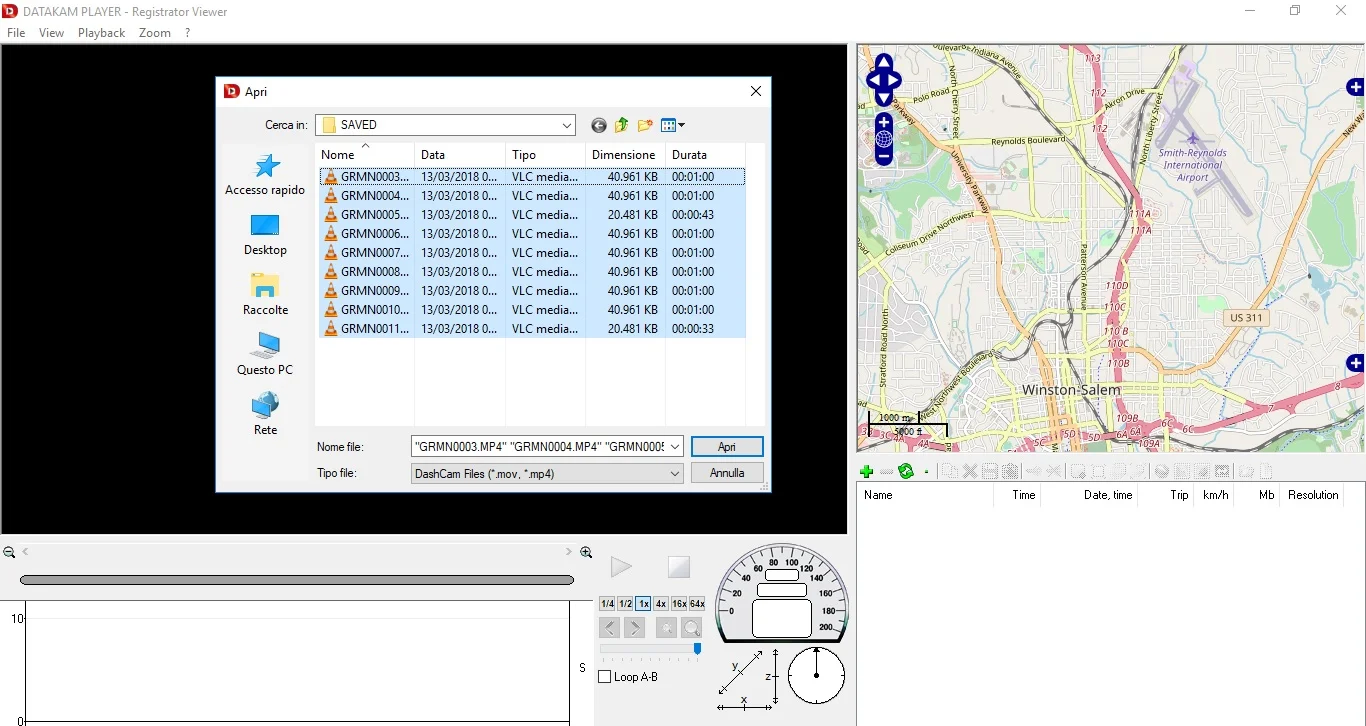

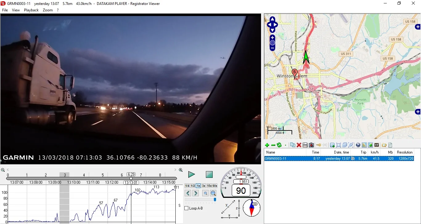

Open "Registrator Viewer" and add all the video files.
It will make group of the trip with GPS data.
