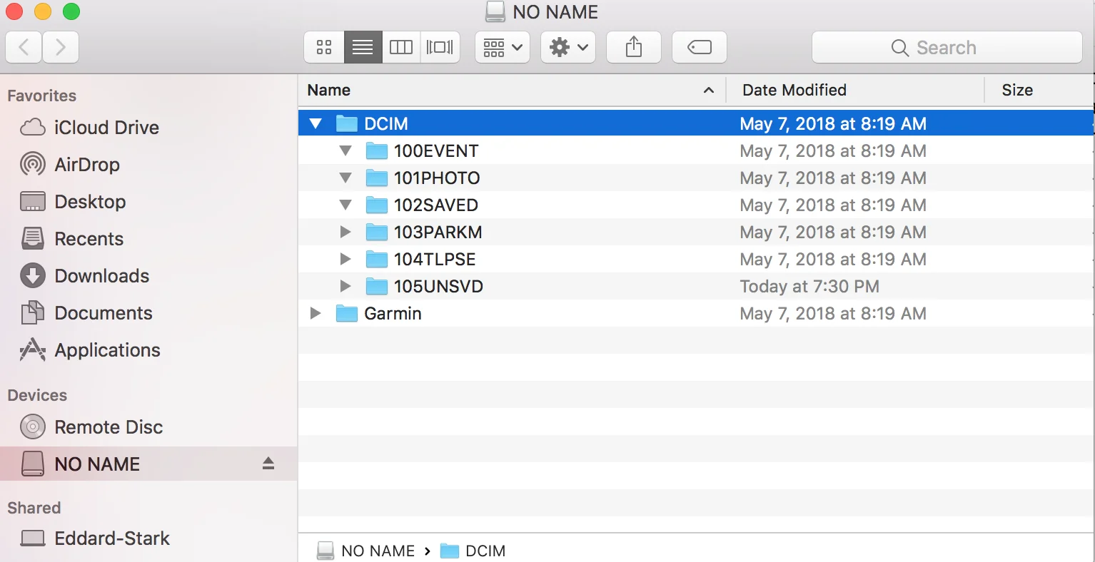

Number one problem with most dash cams is the memory card. Before returning your 55, get a high quality one (32-64GB) Some manufacturers label it as "High Endurance"
Step two, format it in your camera and drive a little trying different functions (travelapse, save picture, video)
Step three take the card out and insert it to your computer. Do not use any program but file explorer (finder)
You should see following structure:
root
+DCIM
++100EVENT
++101PHOTO
++102SAVED
++103PARKM
++104TLPSE
++105UNSVD
Depending on what functionality you invoke, there will be files in some folders.
If you cannot open it on your MAC, get a new one 😉
Lac
Here it is in a more graphical way. The MP4 files will open in QuickTime player by default.
