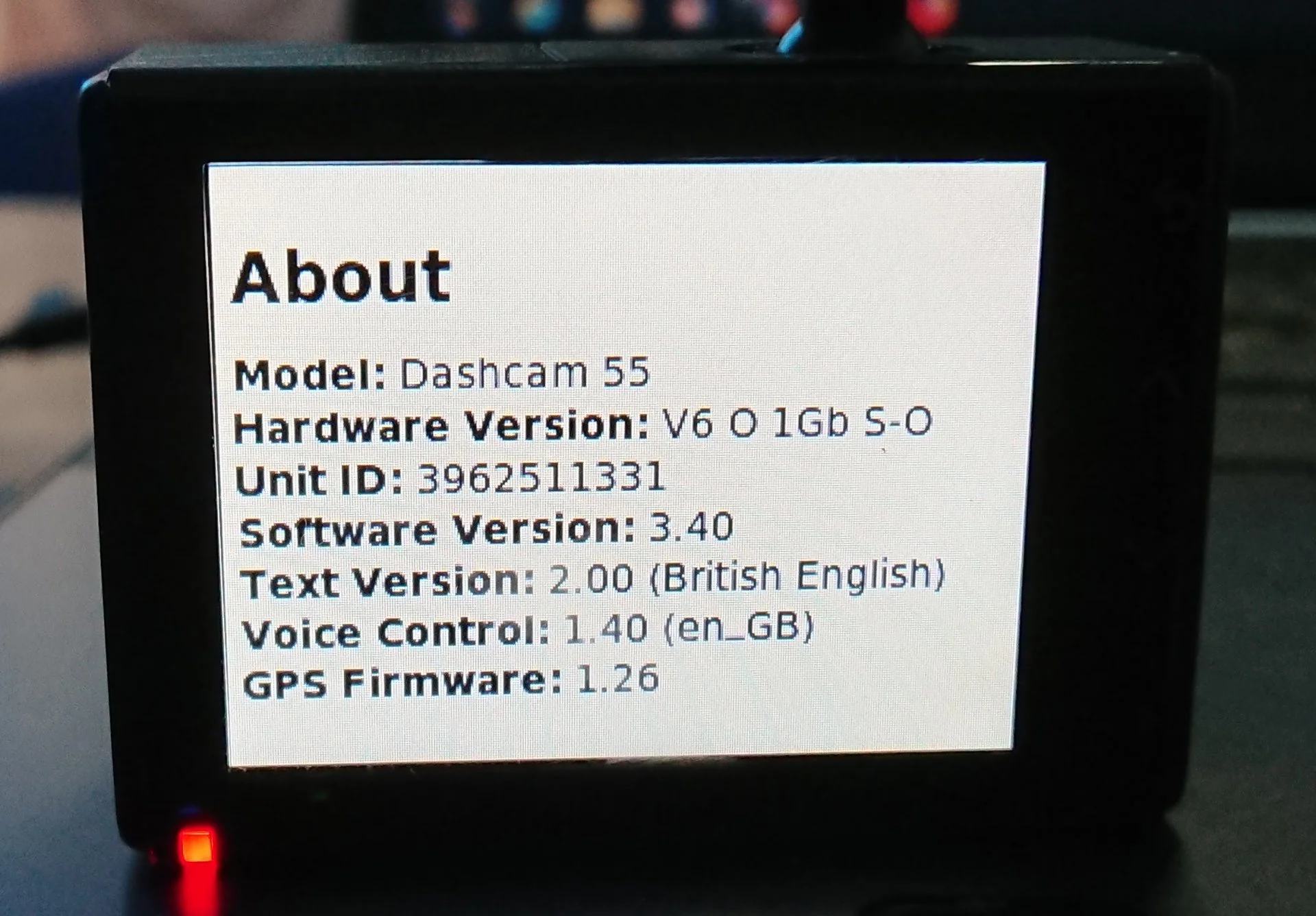

Thanks - same here! At some stage the update corrupted my first Garmin - I lost the voice command and other functions. As I said elsewhere I’m on my second thanks to Halfords (excellent customer care).

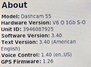

It’s software is version 3.4 but the cyclops camera update is still showing as the Jul 2017 version.
I had a weird problem with voice update the other day. Every time I would plug the camera to the PC, Garmin Express would say that there is a voice update.
Update would complete without errors, but the next time it would offer the same update again. Upon closer inspection of the internal file system I discovered that instead of en_GB folder I had en_GB zero length size file. I recreated the folder from downloaded .zip file and the update finally completed. Now my voice version shows as 1.40.

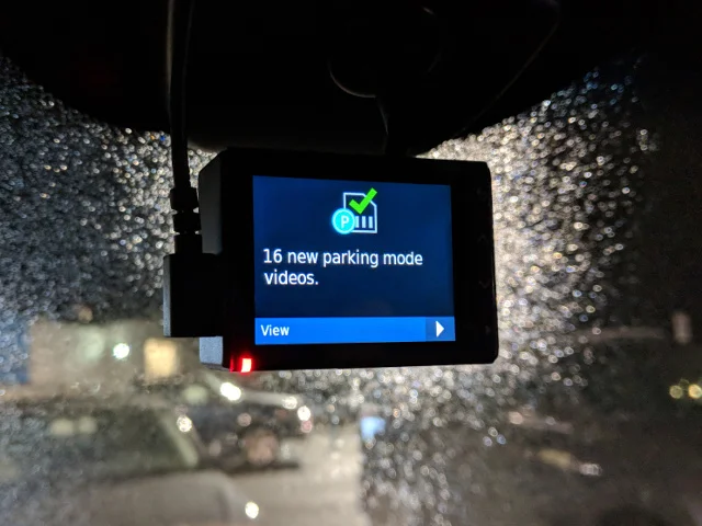

This is what the new parking mode message looks like:
Marginally useful, especially since you don't know how much time/space is left for general recording. They could have at least displayed something like "16 new, 120 total..." or "12GB (~1 hour) remaining for driving videos"

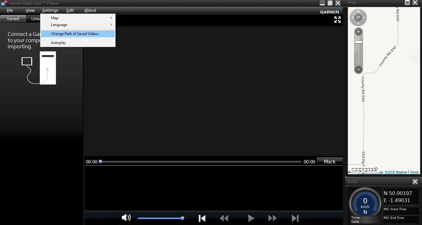

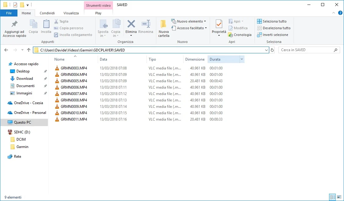

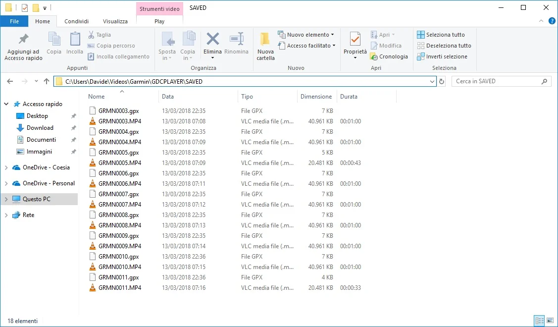

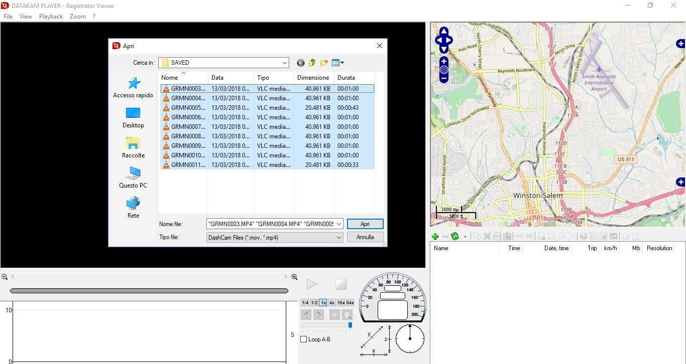

I received the camera and i started my experiment to extract GPS points from video files. "Virb Edit" already uninstalled, the application can't do that operation (crazy, is Garmin made...).
Sw:
- Garmin Dash Cam Player (not officially compatible with Dash Cam 55 and the new 2017 models - another crazy thing by Garmin...) - used to generate GPX files
- Registrator Viewer 6.0.0.22 - everybody here know the potential of this application
link to sw download: https://drive.google.com/open?id=0B...dqa2gzSXUxVkdEMHp6bF9oWDBkRjZaVnA4cU5iQTFXZmc
Open "Garmin Dash Cam Player" and check/select path for video files from which to extract GPS points.
Close "Garmin Dash Cam Player".
Open the folder and copy the video files in it.
Open again "Garmin Dash Cam Player". It will show video files on the left column. Select one by one and export GPX files.
Definitively close "Garmin Dash Cam Player".
The GPX files are saved in same folder of video files.

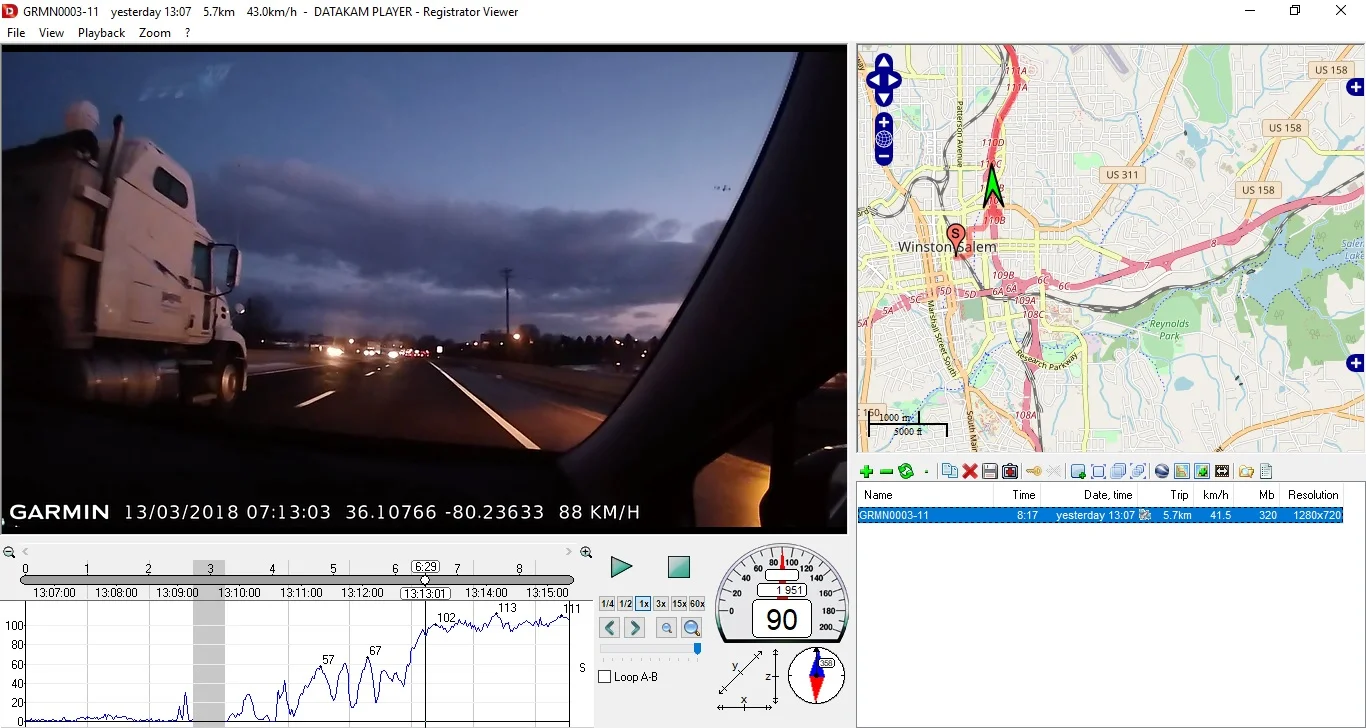

Open "Registrator Viewer" and add all the video files.
It will make group of the trip with GPS data.
I don't know why each video recorded by the Dash Cam 55 is only 1 minute long (in the Dash Cam 20 is about 4 minutes); if the trip will be hours, extraction of GPX will be exhausting. Camera is good stuff, but software support horrible. Thank you Garmin, for 199€ you could make a little effort...
