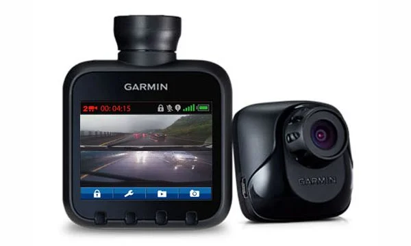

I have a question, since the manual that came with the GDR35D is not in English, and has no pictures of the symbols, I'm not sure about one. I noticed the other day that a symbol has popped-up on the screen. It looks like a balloon, and is right next to the green GPS strength level bars (in the photo). What is it? I've went through all the items in the settings, and I'm at a loss. Any help would be much appreciated, thank you.
This is G-sensor indicator. It is shown when G-sensor is turned on, that means unit can react on impacts/collisions. If you set G-sensor sensitivity to Off, this symbol disappears from the screen.
