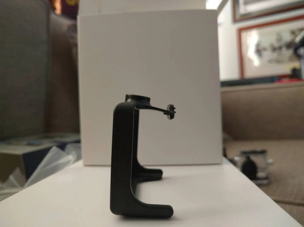

I just got my Git2 and I have a question about the frame mount. It meant to very hard to put the camera in and put out as mine is. Here is a picture of the frame mount.
Well you don't want it falling out when you drive over a pothole in the car!
It is a tight fit, but with a little practice you should find it OK, it doesn't need much force, just correct positioning, the clip is a little flexible - put it under that last when putting it in and lift that first to get it out.
Please check this video about how to setup the camera to the frame, file size is only 1.63M.
https://dl.dropboxusercontent.com/u/22493212/git2/install git2 to the frame.MOV
Thanks for the info on the frame mount.
