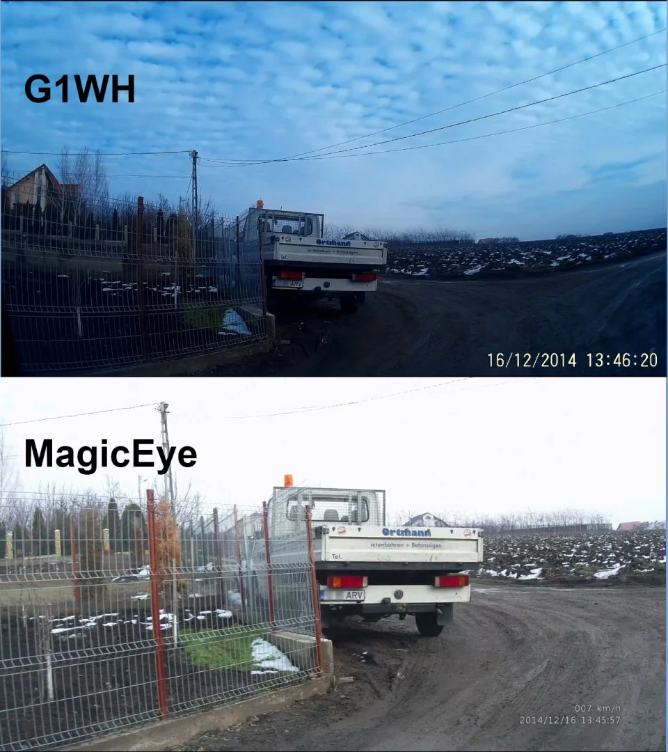

After updating iTracker SM5E5HGB.130812.V1 to magic eye HD50G_v436.030912 the camera doesn't switch to nightmode anymore.
The image is however much better now during day, even better than G1WH with default settings.
TheGPS signal was good and the automatic time update was enabled.
Any ideas ?
Here is a comparison between G1WH and magiceye:
I changed the firmware to texet TX5E5HGB.131019.V1 and now in menu is possible to choose the hours when to start and stop the night mode.
