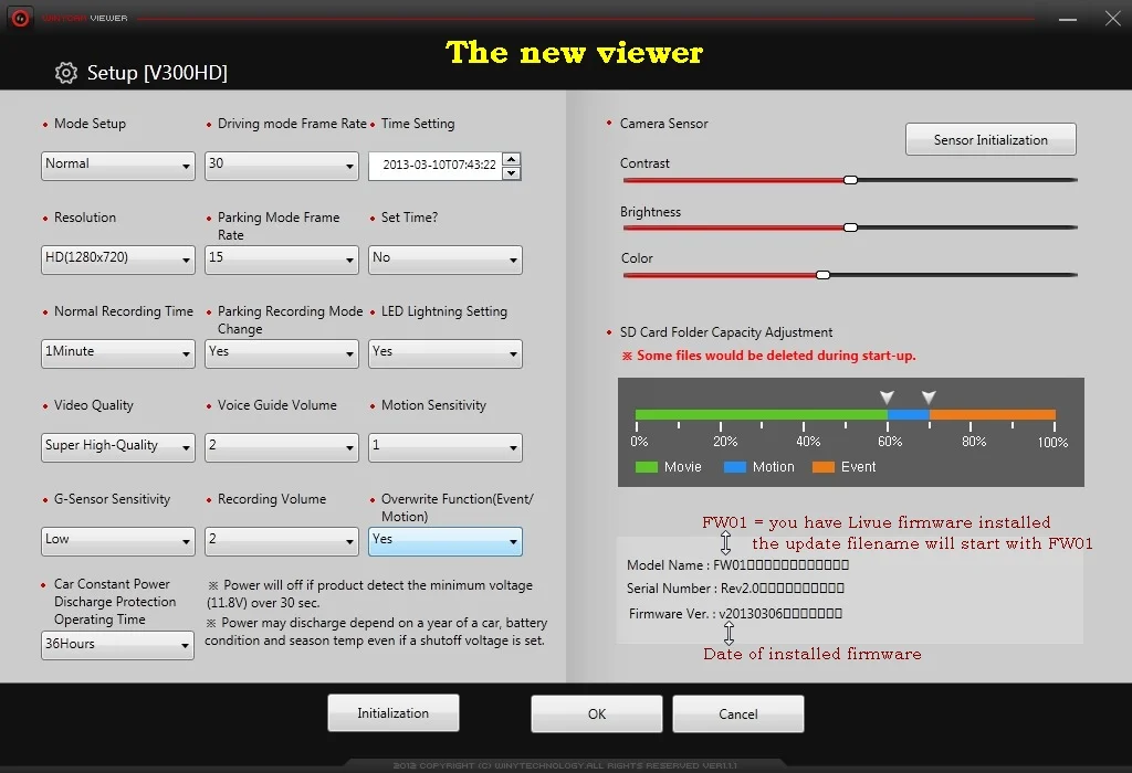

The power save feature can be turned Off or On for the english firmware and for the korean firmware you can set also the hours for the camera to remain on in the parking mode.
If you are setting your camera with the PC Viewer and the settings are not saved this means your viewer is for the other firmware. If you are using only the firmware and viewer from the SD Card you should have no problems with the camera setup.
You can't have installed on the same PC also the WinyCam and the Livue software. If you want to use the camera with the Livue firmware you can use as PC software the Livue Viewer (which is in korean) or the New Viewer (which is in english). The advantage of the New Viewer is that you can see all files in the same list, not only based on N E P mode, and you can setup the hours for the power safe feature. But for this New Viewer for the moment you must use the latest Livue LB100 firmware called FW01_130306.bin now.
