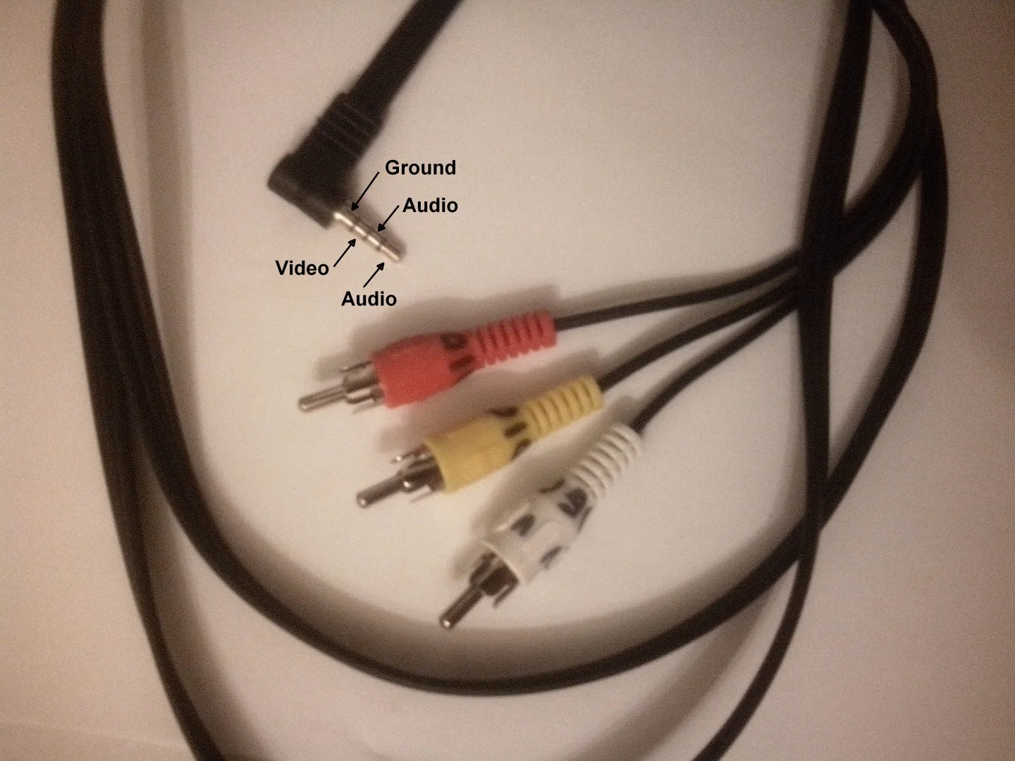

another question, I have a satnav screen in my car which I have modified to allow standard video input, if I connect the Livue using the optional video output cable (do you know where I can buy this?) is it possible to play back previous recordings when the sd card is still in the camera? or is the video output just for live view of the output only? I guess it can only record to card and not play back from it?
I suppose I could carry a small media player in my car that can read videos from sd card, remove the sd card from Livue insert into media player and playback on my nav screen instead. (I don't have an android phone, only an iphone so I can't use that)
You can use any standard "AV 3.5mm Jack Plug to 3 RCA Adapter Cable Audio Video" with 4 pins. I found on a local store one for $2 and 90 degrees angled. "Standard" means the first pin to be ground. The others are not important and we need only the video connection.
It is not possible to play videos from any dashcam without display or which don't have some USB input. Only live streaming is available because of the video out connection. The video out connector can't be used to access the memory card just to stream the video as standard definition through to the RCA cable.
If you already have that media player is OK to try it, but if it have its own operating system is possible to not play the Livue video files. Here is a Livue LB100 sample. A PC or some Android device will play these files.
