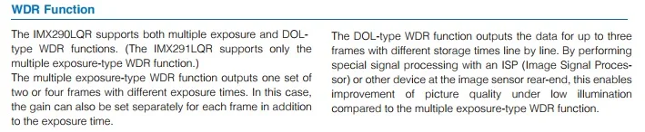

well you can blame Sony for that, they don't use the term HDR but they still do multiple exposure
that's the information Sony provide, is there a reason I shouldn't believe what they have to say about what they do and how they do it?
As a camera manufacturer I think you should strive to educate customers rather than add to the confusion. When you say things like, ""99% of manufacturers don't even quote accurate FOV numbers" and "there's no way for an end user to know if the spec offered is correct or not either" you are part of the problem.
that's what happens, whether you like it or not it's the reality of what goes on, there are thousands of companies making cameras, the majority out of China and I could think of maybe 5 or 10 that publish accurate information, too many just cut and paste whatever was on their last model and accuracy goes out the window
