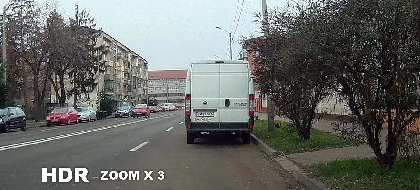

Test HDR vs WDR
yes, there is more life in video with HDR On, and not only after the sunset. πŸ™‚
Why is the field of view a few pixels narrower on the HDR version?
