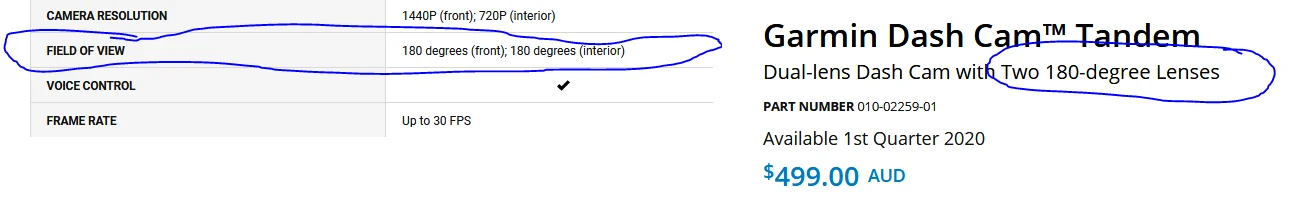

I think the Garmin 66W (and then Tandem which gets you two way view front and back, though only the front gets 1440p30 and the rear 720p30) has a 180 degree angle view, unless go pros show more than this giving the fish eye view effect?
the Garmin viewing angle is likely around 110Β° tops, no brand name dashcams are doing 180Β°
Hmm yes, definitely 110 degrees tops. :watching:

Be careful of those FOV published specifications. Some years back I compared an SG9665GC (120ΒΊ FOV) against a 'generic' A118C (168ΒΊ FOV) - the SG camera was actually wider by a couple of degrees than the A118C. This is due to a couple of factors: 1) Horizontal versus Diagonal measurement, and 2) marketing 'exaggeration'.
Has anyone actually bought either the Garmin 66W or and the Tandem and have tested their advertised 180 degree field of view, compared to say one that's advertised at 150 or 120 degrees? And what's the difference between horizontal and diagonal measurement of 180 degree field of view?

Has anyone actually bought either the Garmin 66W or and the Tandem and have tested their advertised 180 degree field of view, compared to say one that's advertised at 150 or 120 degrees?...
I doubt it except for possibly some 'consumer protection' group or possibly an independent testing organization. Try searching for reviews and see how detailed they might be.
...what's the difference between horizontal and diagonal measurement...
Edge-to-edge versus corner-to-corner.
A quick look on YT, and it is clearly not 180, it is fairly wide for a dashcam, maybe a bit too wide, but it is not 180.
With 180 you would clearly be able to see down the road we are joining at this T junction in both directions:
