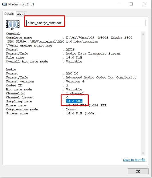

Below I post the original voiceover from firmware 1.0.14. See the name of the folder with your language and the AAC file format. It is important. The AAC file format should be as in the original:
Format : ADTS
Overall bit rate mode : Variable
Format : AAC LC
Format/Info : Advanced Audio Codec Low Complexity
Channel(s) : 1 channel
Sampling rate : 16.0 kHz
Compression mode : Lossy

Yes, actually I saw your post and followed that but unfortunately both on mac and windows we are not getting the same codec that you have in screenshot. I had the same problem like @awr above and the exported aac is not working in the cam.

Are you sure?
Original AAC:
Yes, absolutely sure, factory AACs are 16kHz, RAWs are 8kHz. You showed AAC screenshot, but i talked about raw sounds eg. bootsound.raw and key_tone.raw and as i wrote, you can prove it easily with audacity that they are 8kHz sounds.
