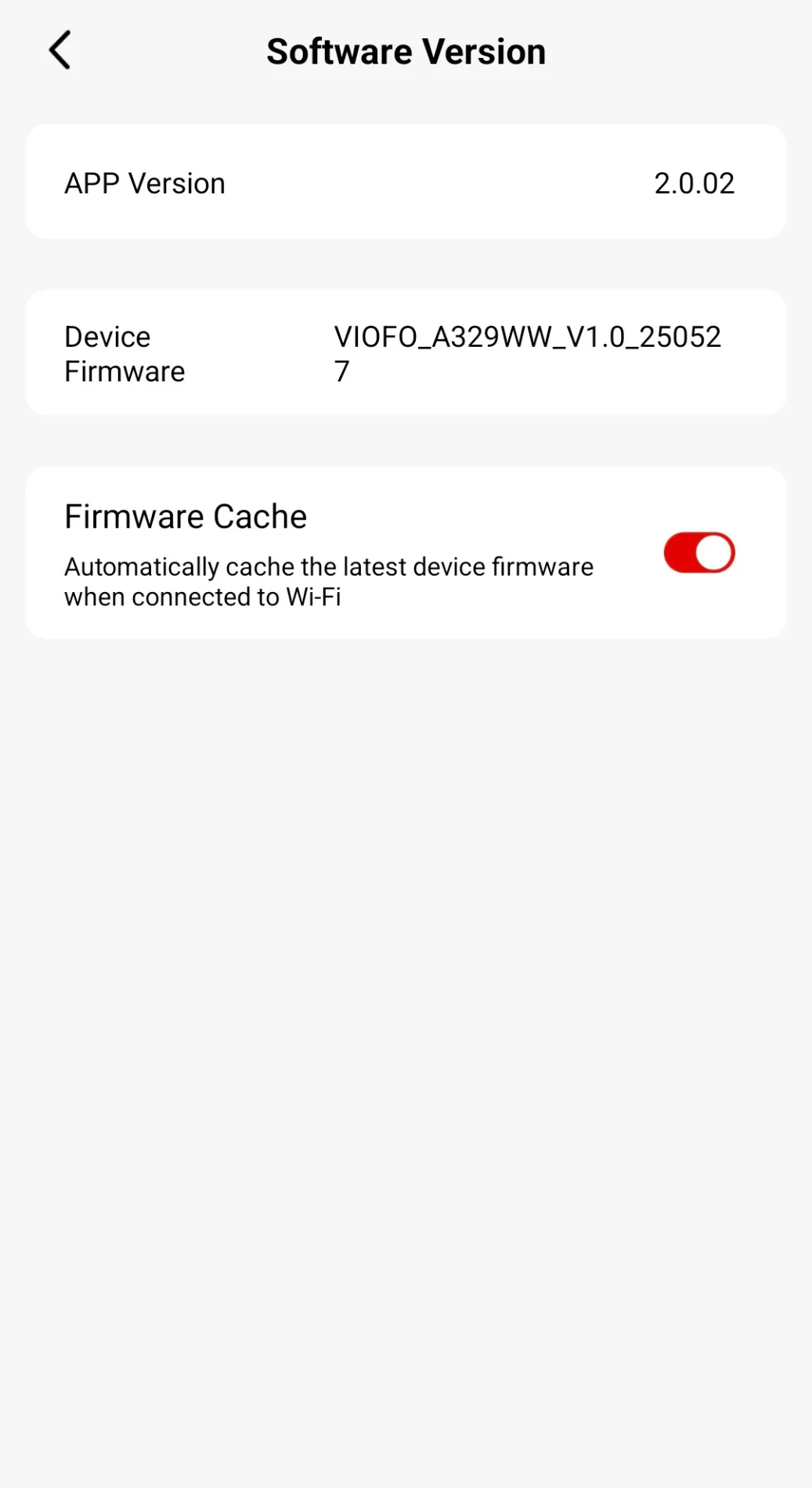

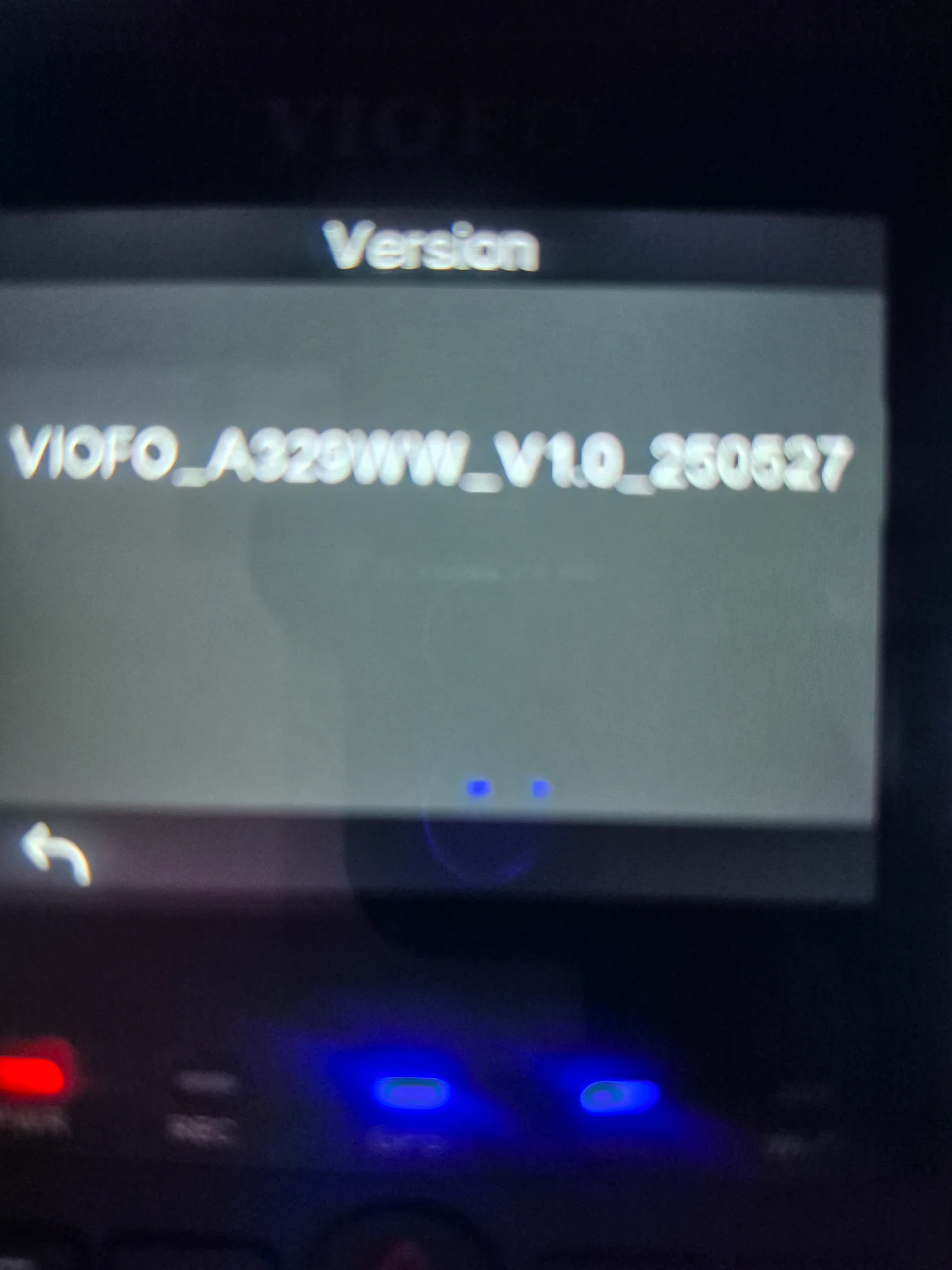

Thank you all so very much. Couldn't have done it without all your help. Really appreciated.
Parking mode all working fine. Just tested it in car.

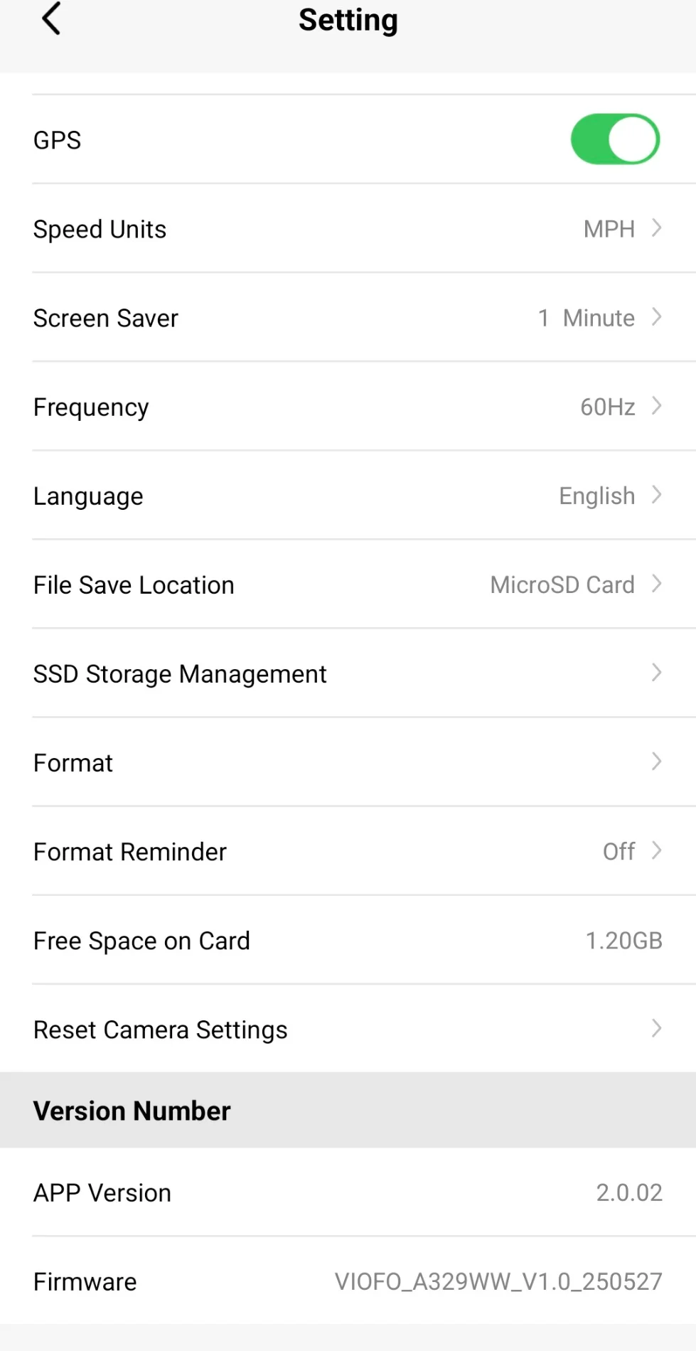

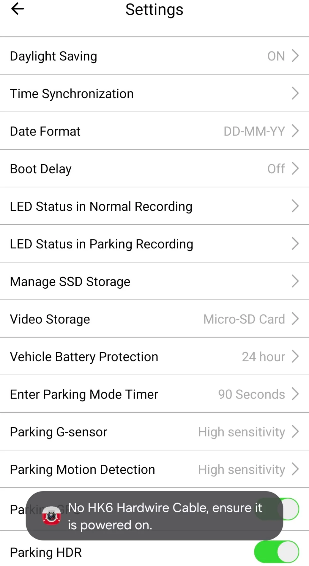

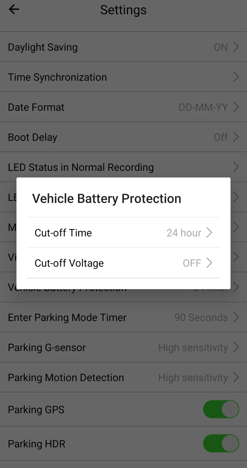

I hope now its just a few smaller things to figure out like for instance.
1) When left iver night in parking mode (it said parking mode started) I noticed that in my parking mode video section in the app there were zero parking mode videos? Why is that and how do I fix that? Please see attached
(Before we changed the firmwear there were parking mode videos)
2) I also noticed it has recorded continously since last night. Whereas before we changed the firmwear there were only a few clips over night of movement.
Ive attached all settings if anyone can help me figure out how to resolve this.
Thanks again all.
3) Ps whenever theres an impact ie a closed door in parking mode it makes a camera click noise like its taken a photo.? Why is that?
@cartyre you are now heading into the parking mode rabbit hole. You'll now have to decide what parking mode works for your driving and parking situation.
To answer you questions, you are currently using "Auto Event Detection" as your parking mode. In this mode the dash cam is simply waiting and watching for any motion and impacts to happen. If any is detected, it will save the previous 15 seconds before the motion or impact and the next 45 seconds to further capture what is happening.
This makes it seem like the dash cam is always recording when in fact it is simply waiting. This is why there are no videos but when you close the door which is an impact, the dash cam started recording and part of that process is also taking a photo. You will notice this taking a photo thing when a video gets locked/protected.
Also watch these videos please(and all the other videos you'll see related to Viofo parking mode or your A329S):
There are also plenty of threads discussing parking mode and all it's intricacies. And it seems like this will be another thread that shows that.
Both of these videos are excellent to watch. I did when I was new and learning. And still use them to refresh. But I do need to admit with Vortex I watch on youtube where the play speed can be adjusted to .85 and slow his instructions down just a bit for my slower brain processor.
The good thing you can watch, listen and learn (for me it was not one day) and then make your choices for your setup.
I use Low Impact Mode for the power saving and turn on the dash cam with the car's start button within 60 sec when I return to the car. This allows me to get in and not record a impact in doing so.
Please watch those videos for more information on setting the various parking mode options.

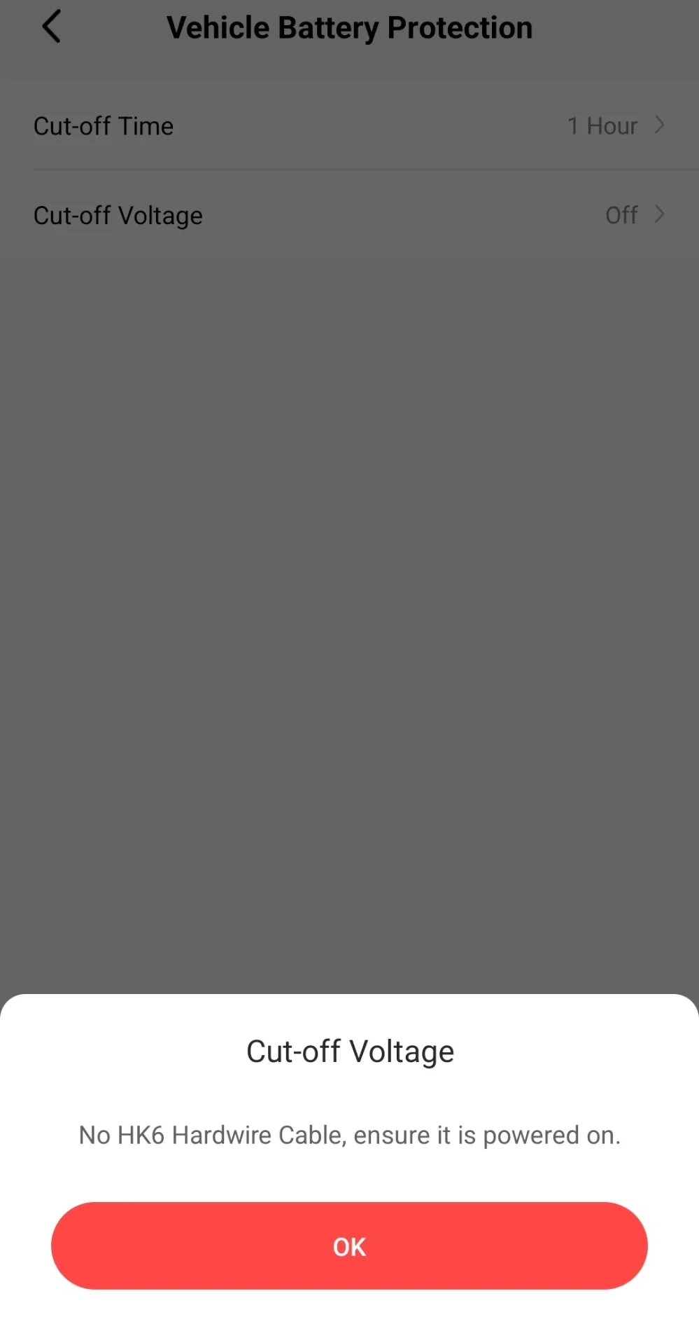

I call your attention to the "Cut-off Timer" and "Cut-off Voltage" settings having a dual purpose. They will behave one way when one of the "Normal Parking Modes" [Auto Event Detection, Time-Lapse, Low Bitrate] have been selected and they behave another way when you select a Hybrid parking configuration.
Right now, you have selected a "Normal Parking Mode" of Auto Event Detection. Your current settings [Cut-off Timer = Off, Cut-off Voltage = 12.2V/24.4V] will result in the dash camera turning off when your vehicle's voltage level drops below 12.2V in parking mode. That's perfectly fine as long as that is what you want it to do.
The HK6 hardwire kit has a slide switch for its own hardware based low voltage cutoff feature. The HK6 will always turn off the power to the dash camera in parking mode when the vehicle's voltage level has dropped below the selected voltage level on the slide switch of the HK6 [no matter what parking mode has been selected]. If you decide to use the A329S optional feature of "Cut-off Voltage", the HK6 low voltage cut-off feature should be set to a lower voltage level than the one selected in the A329S settings. That's so the two low voltage cut-off features [A329S "Cut-off Voltage" and HK6 hardware based voltage cut-off] don't interfere with each other.
The A329S "Cut-off Voltage" feature has a limited number of setting options [voltage choices]. That's mainly due to it being intended as a way for the dash camera to switch from a normal recording mode to low power impact detection parking mode when you have selected one of the hybrid parking mode options.
This is where you need to do a bit of research regarding the various parking modes available to you with the A329S and decide what parking mode(s) is/are right for you. Is one of the "Normal Parking Modes" [Auto Event Detection, Time-Lapse, Low Bitrate] all that you need, or would you like to take advantage of Hybrid parking mode [operates in a "normal" parking mode until either the "Cut-off Timer" or the "Cut-off Voltage" feature have detected that it should switch to low power impact detection parking mode].
With that parking mode selection made, you need to examine the various A329S settings parking mode settings to implement your parking mode choice. Again, don't forget to make sure the HK6 low voltage cut-off setting is set correctly for your parking mode configuration.
This chart from the A329S user manual is a bit outdated since there are now several additional time-lapse options within the Hybrid parking mode list of available parking mode choices.

1) When RCG mentioned how my settings currently are " Off, Cut-off Voltage = 12.2V/24.4V] will result in the dash camera turning off when your vehicle's voltage level drops below 12.2V in parking mode"
This is why it's important to understand that the "Cut-off Voltage" setting has two possible ways of operating. If you select a "Normal Parking Mode", the "Cut-off Voltage" setting will cause the dash camera to turn off when the voltage level to the HK6 goes below that selected value. That is a valid way to have this operate. Keep in mind, if you have selected a "Hybrid Parking Mode", what the "Cut-off Voltage" will cause to happen is that instead of the turning off the dash camera in that same situation, it will cause the A329S to transition from the original hybrid parking mode [Auto Event Detection, Time-Lapse, Low Bitrate] to low power impact detection.
One setting with two potential purposes depending on how you've configured your dash camera.
2) Isn't this the only option really to avoid getting a flat car battery?
No, it's not. As I mentioned before, the low voltage cut-off feature of the HK6 is always operational no matter what the parking mode settings are in the A329S.
To use the A329S "Cut-off Voltage" setting/feature, it requires the dash camera be powered by a VIOFO HK6 hardwire kit. It also requires the A329S detects the HK6 [you see that "Detected" message on the dash camera screen]. This setting gets its information from the Bluetooth broadcasts of the vehicle system voltage level from the HK6.
You can use the A329S "Cut-off Timer" setting as well. You can use this setting when the dash camera is powered by a HK4 or a HK6 hardwire kit. This feature uses a timer that is maintained inside the firmware code, so it does not require the HK6 to power the dash camera to be functional. The A329S "Cut-off Timer" operates in the same manner as the "Cut-off Voltage" setting in how it controls the operations of the dash camera. You can use both of them, one of them, or none of them based on your parking mode needs.
  • A329S "Cut-off Voltage"
    • Normal Parking Mode Selected [Auto Event Detection, Time-Lapse, Low Bitrate]
      • This setting will determine when the A329S will turn itself off in parking mode
      • The HK6 low voltage cut-off feature may also turn off the dash camera as well since that feature is always enabled/active
      • If you decide to use the A329S "Voltage cut-off" setting/feature, you must make sure the HK6's low voltage cut-off setting is below the one selected in the A329S!
        • This is to avoid the conflict of having the HK6 turn off the power to the A329S before the vehicle voltage level reaches the voltage level selected via the A329S "Voltage cut-off" setting
    • One of the "Hybrid Parking Modes" have been selected
      • The "Cut-off Voltage" setting no longer determines when the dash camera turns off, it determines when the dash camera switches from the "primary parking mode" of the hybrid parking mode selection.
      • The HK6 low voltage cut-off feature is now the only way the dash camera will turn off based on the vehicle's system voltage.
      • If you use the A329S "Voltage cut-off" setting/feature for a hybrid parking mode configuration, you must make sure the HK6's low voltage cut-off setting is below the one selected in the A329S
        • The reason the two settings should be different are
          • The A329S "Cut-off Voltage" setting determines when it switches from the primary hybrid parking mode to low power impact detection parking mode.
          • While the vehicle system voltage is below the A329S "Cut-off Voltage" setting, but above the HK6's low voltage cut-off setting, the dash camera will operate in low power impact detection parking mode.
          • When the vehicle system voltage drops below the value selected via the HK6 low voltage cut-off slide switch, the HK6 will turn off the power to the dash camera to protect your vehicle's battery.
      • Example 1:
        • Parking Mode: [Hybrid] Low Bitrate => Low Power Impact Detection [LPID]
        • A329S "Cut-off Voltage": 12.2V/24.4V
        • A329S "Cut-off Timer": Off
        • HK6 low voltage cut-off setting: 12.0V
        • What happens:
          • When you turn off the vehicle's ignition system [ACC power is turned off to the HK6], the dash camera enters Low Bitrate parking mode
          • The dash camera continues to operate in Low Bitrate parking until the HK6 tells the dash camera that the vehicle's system voltage has dropped below 12.2V.
          • When the vehicle system voltage goes below the A329S "Cut-off Voltage" of 12.2V, the A329S will switch from low bitrate parking mode to low power impact detection parking mode
          • The dash camera will continue to operate in low power impact detection parking mode until the HK6 detects the vehicle system voltage level going below its low voltage cutoff setting of 12.0V
          • When the vehicle system voltage drops below 12.0V and stays below for a short period of time, the HK6 will turn off the constant power to the dash camera and the dash camera powers down.
      • Example 2:
        • A329S "Cut-off Timer": 3 Hours
        • What happens:
          • The only thing that is different with this configuration is the dash camera will switch from low bitrate parking mode to low power impact detection parking when either the 3-hour timer has expired -OR- the vehicle system voltage goes below 12.2V.
    • Low Power Impact Detection - Parking Mode
      • The A329S "Cut-off Timer" and "Cut-off Voltage" do not influence this parking mode's operations
      • This parking mode relies solely on the HK4 or HK6 low voltage cut-off slide switch setting to determine when the dash camera is powered down due to low vehicle system voltage.
