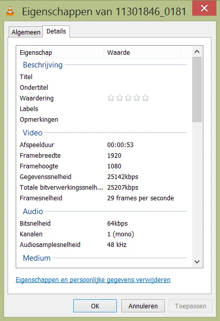

firmware_JVX_MOD-28CC_28Mbps+SharpC+DCTeam.bin
renamed to firmware.bin, copied to SD card, did update, but how do I know if it succeeded? Where can I check the camera's FW/version?
does 25mb/s so I guess that's the high bitrate setting for this one?
Then it should be a successfull flash, since I had the original stock version @18mb/s....
