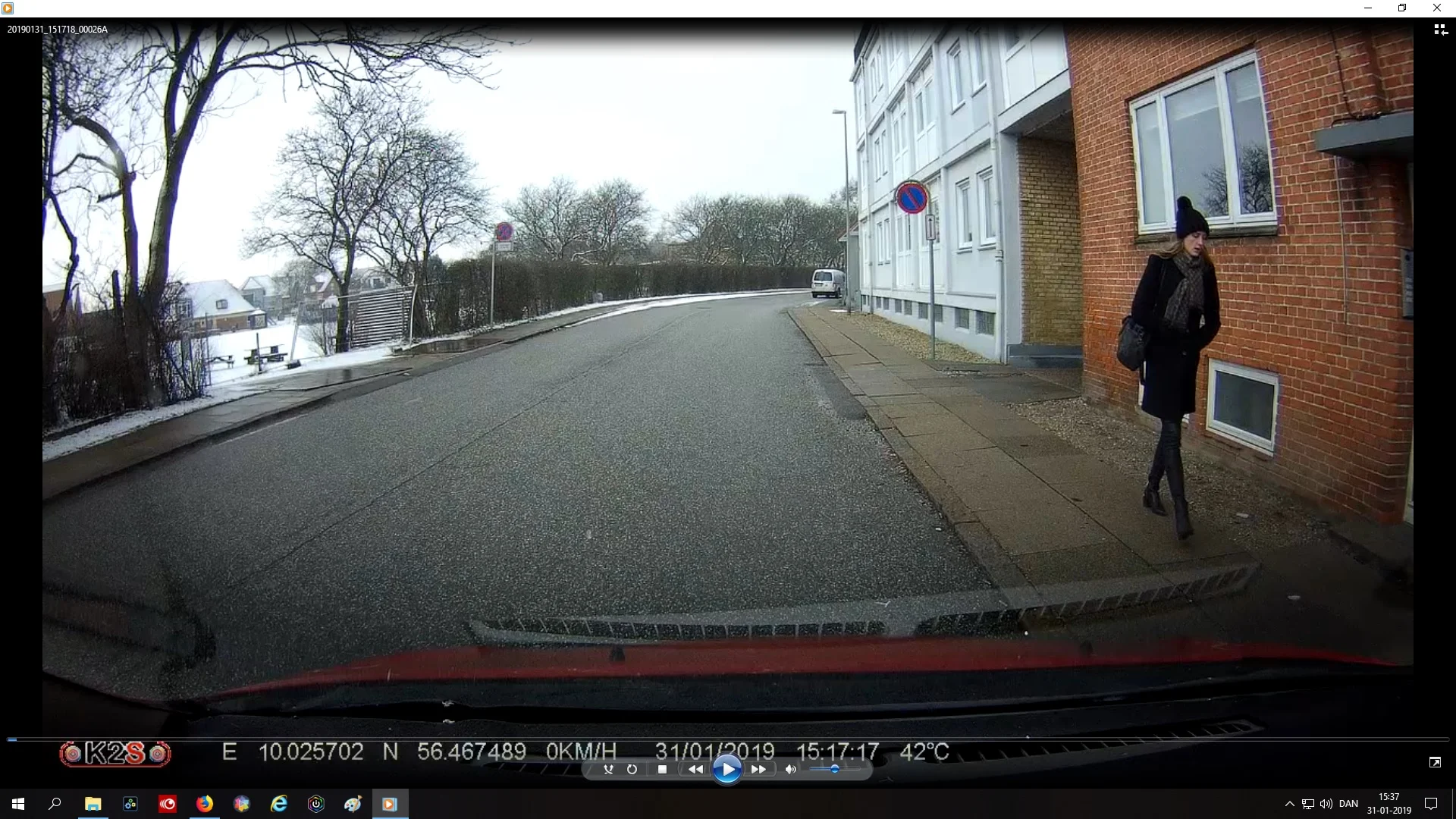

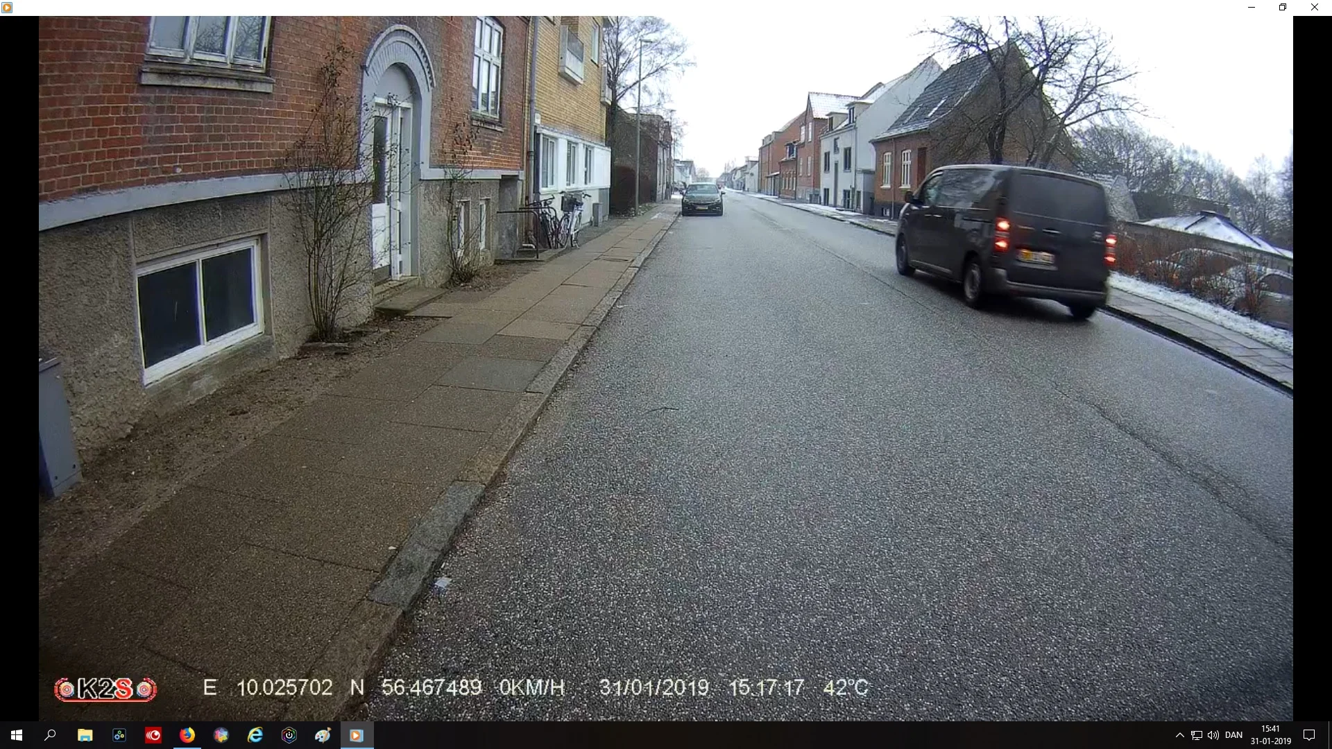

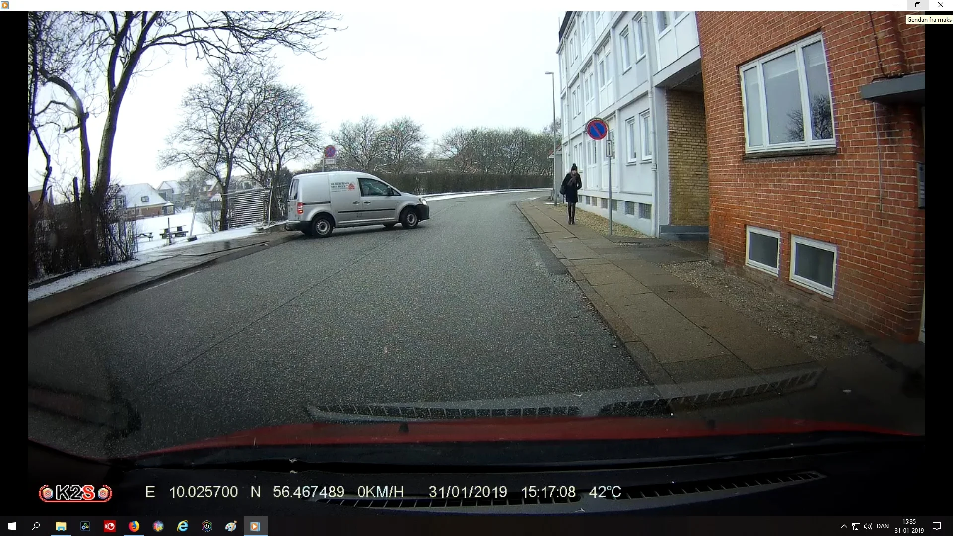

Parking along the curb passing cars can trigger a event but only when they are a few M from my car, i had a motion detect session end due to no movement, when actually a van was pulling onto the road in front of me, and a girl was walking towards my car on the sidewalk also pretty close.
When the girl got pretty close she did not trigger a event, that only happened with a black van passed by.
At least i think it was the van that triggered the recording.
